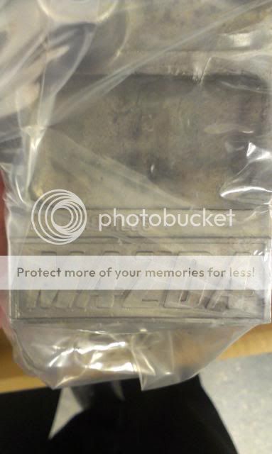

This is what I'm putting together at the moment.
Plus you get to run these bad boys (RX4 style Mazda font)
