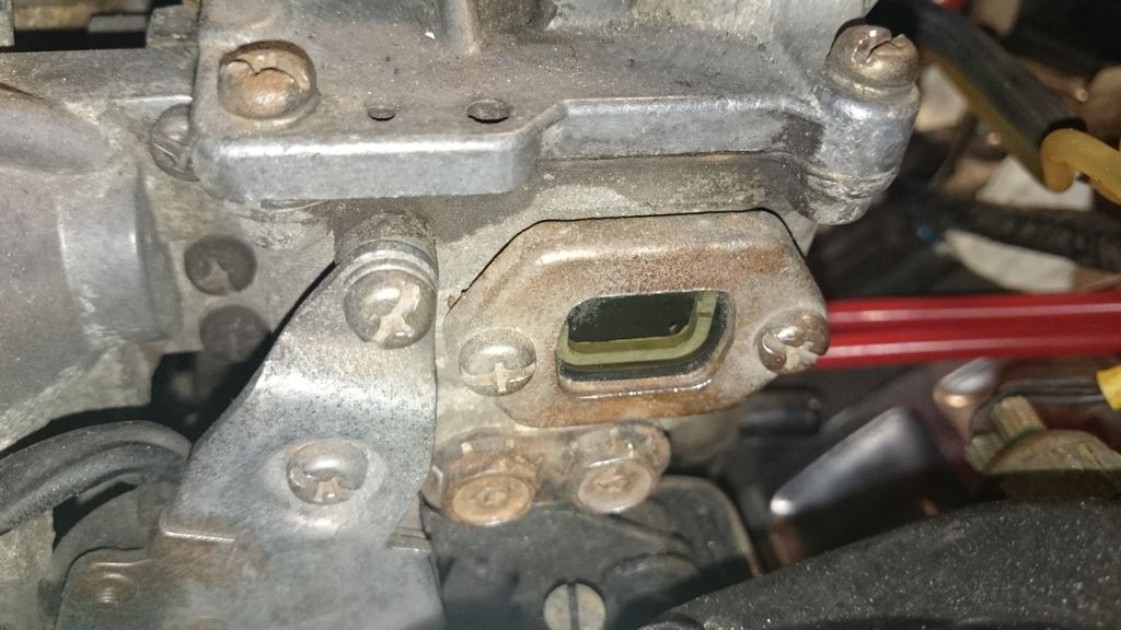

Before the BIG STARTUP, I checked for fuel thru to the carb and into the bowls. A clean carb is useful for this as seen in this pic. The shadow above the sightglass is fuel! Dirt hides leaks!
Upon checking this out, the four screws were finger tight only
That would be why there was always a fuel smell around the engine bay then

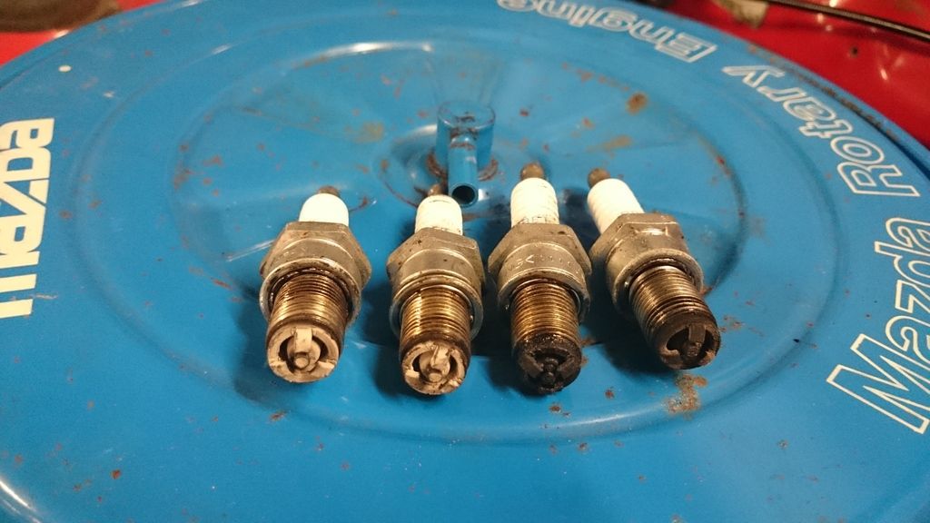

Pulled out the plugs to check. Leading pair on the left. Tool had a different setup anyway with an IDA.

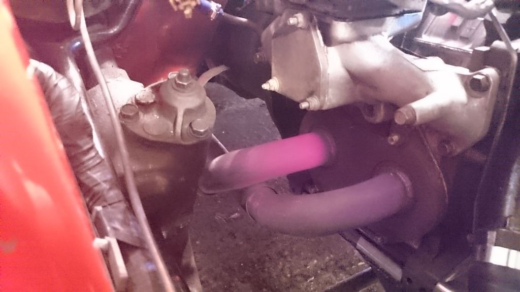

So I left it running at 2000 rpm to get up to temp so the thermostat would open. If you were in any doubt on how hot a rotary engine exhaust gets ... this is after 15 mins at 2000 rpm, no load, just fast idle
Remember what I said about fuel leaks before? Scary

Double check the dizzy position. The headers start glowing when the fuel is burning down the exhaust.
Leads round the right way?

Important point Tool, good Advice.TOOL wrote:Double check the dizzy position. The headers start glowing when the fuel is burning down the exhaust.
You can see last side picture 21.May 2015 00:24
spark plugs show lean mixture too
