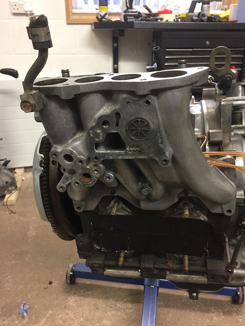

Stripped the inlet manifolds, injectors, fuel rails and oil injecters off it to get it a good clean up...
then put it again dry.... new gaskets and injector seals on order from Mazda....

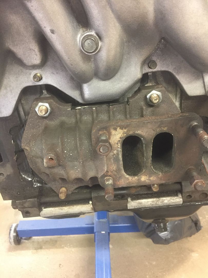

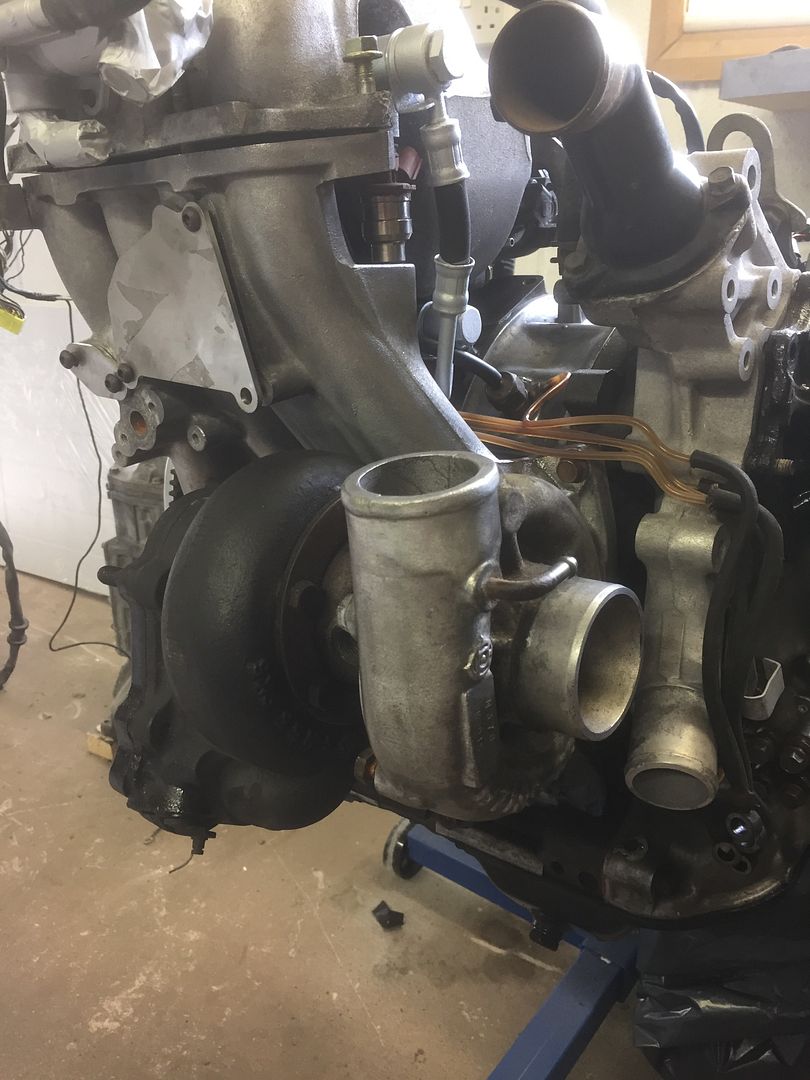

An issue with doing this engine swap on right hand drive FB's is that the turbo hits the steering box and because I don't want to shell out on another exhaust manifold I decided to flip the existing one over the throw the turbo forward away from the steering box.
Sounds easy enough :roll: but needs a bit of tweaking.

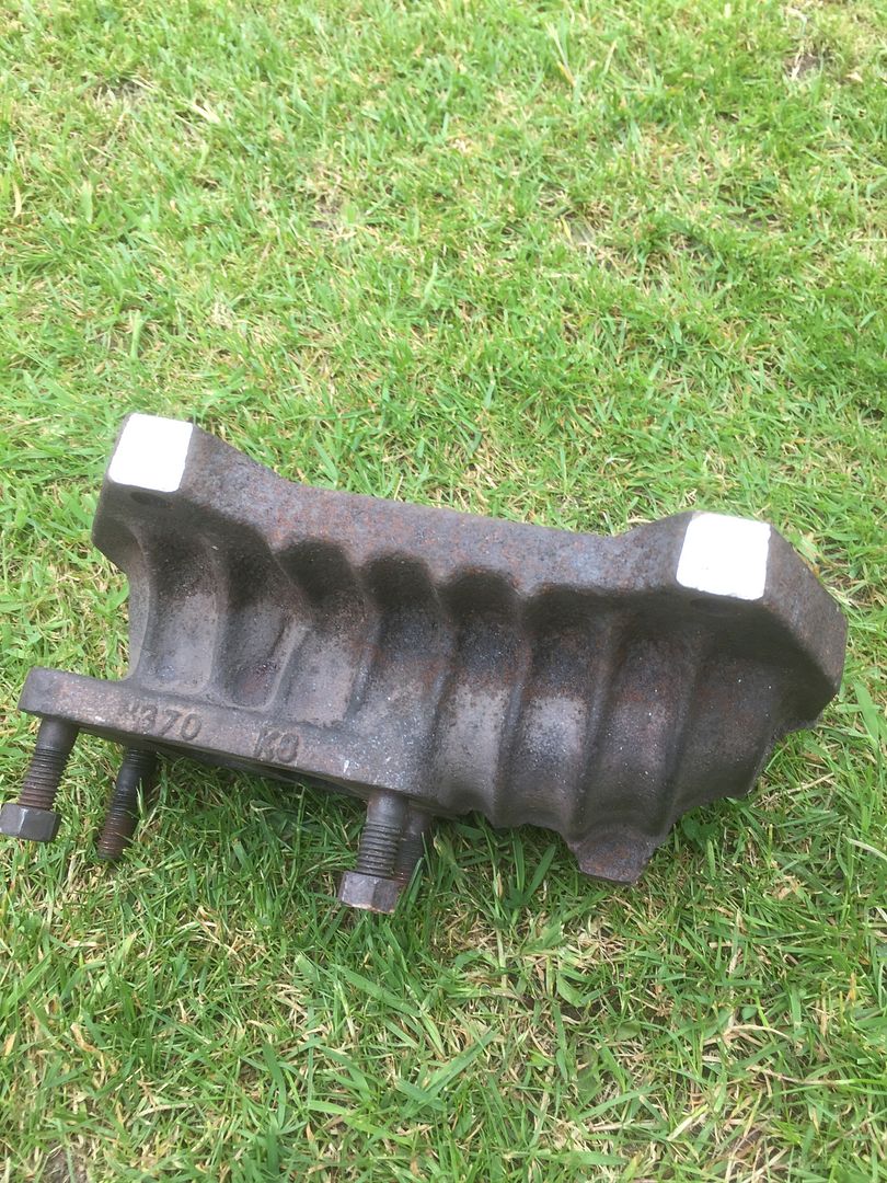

First, the manifold needs a bit cutting off the top to stop it hitting the LIM...
and the bottom of the lugs need grinding off it to stop it hitting the bottom engine bolt...
it then fits fine...

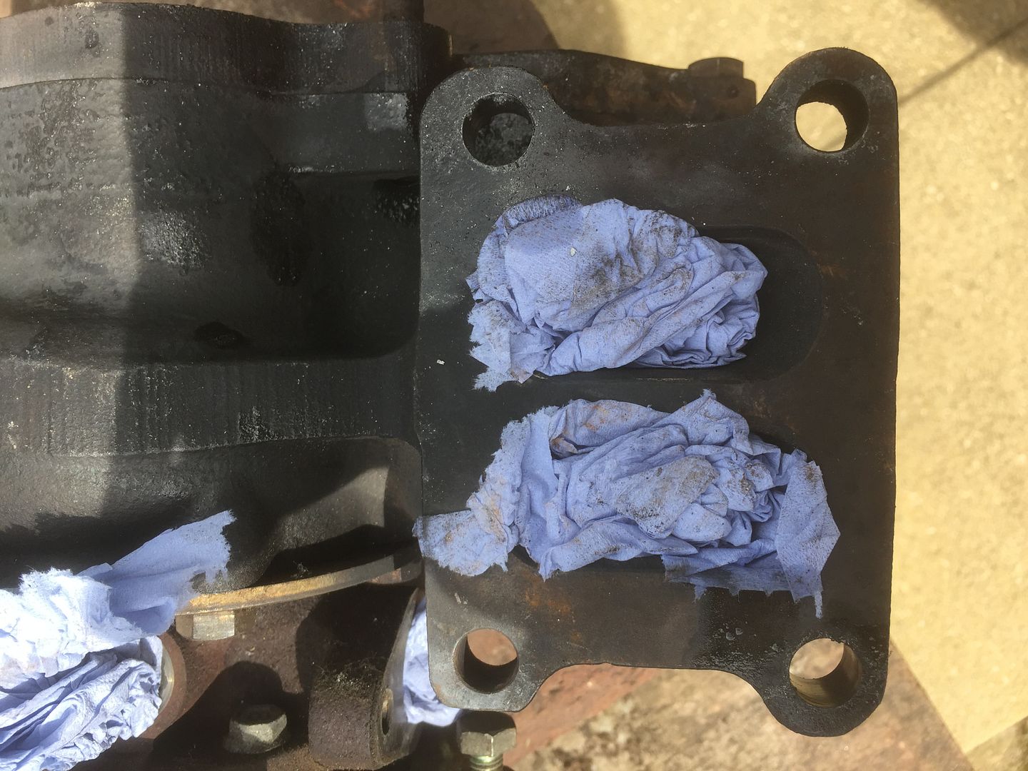

Next, for some bizarre reason the stud holes in the turbo aren't symmetrical so need re-drilling oversize to get the turbo to fit onto the manifold...
The turbo then slides onto the manifold studs but hits the LIM so a steel packer needs to be made to fit between the manifold and turbo to pack the turbo away from the LIM.
I made a packer out of some 10mm steel plate...
This has made the turbo clear the LIM.... whether 10mm is enough of a packer I'll have to see once the gaskets are on it.
