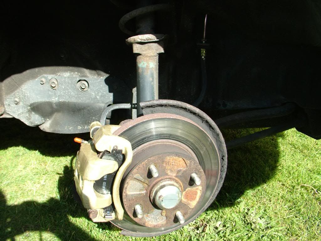

As my new pads arrived today and as the sun was shining when i got home from work, I decided to have a bash at fitting my newly refurbed front callipers.
First up, I removed the old seized offside calliper...
Looks like I timed it just right..... not much left on the old pads...

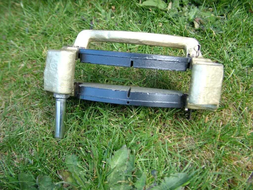

I then removed the retaining clips from the old brake carrier and installed them into the refurbed carrier...
Next, installed the pads into the carrier...
And bolted the carrier back onto the strut...
Whilst replacing the old flexible brake line, I noticed that the hard line was very rusty where it entered the wheelarch...
So I made some new hard lines up, one for each side of the car...
And then installed the calliper lubed it up with some copper grease and bled the brakes...
I also noticed that the anti squeal shims were missing from the offside brakes and were rusted through on the nearside so I’ll need a hardware kit to complete the job...
Done the hard work now though.

run the car all week and the brakes are a revelation... stops in a perfectly straight line, no binding, great bite.... wish i'd have done them ages ago instead of struggling on with the knackered old brakes.

Interestingly I struggled to fit the pads into the carrier whilst in situ.....much easier if you take the carrier out.
Plus I've got a pair of spare carriers that I could have prepped up.....Dooh...... :idea:

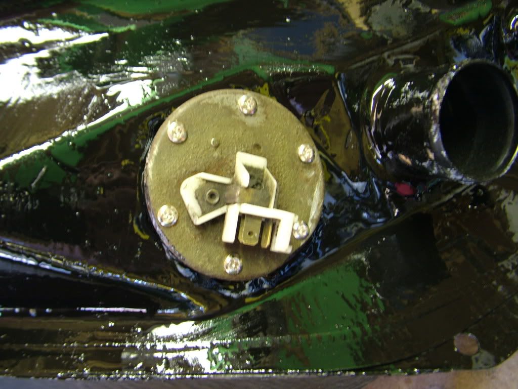

Had a nice surprise / stroke of luck today.... this morning I decided to prep my NOS series 3 tank that I bought last year for my now abandoned project car, with a view to putting it onto my Elford.
Being a new tank, it's a bare bones items and needed the sender and fuel pickup fitting into it.
I wanted to get it ready prior to removing my existing tank to minimise the down time but then discovered that my spare fuel sender had the rubber gasket missing, stopping me from fitting the sender.
Thwarted in my tank preparations, I started to get my rear axle ready to swap onto the car along with the poly bushes instead....
An hour later, Cliff turned up and said" I've bought you a present... a series 3 fuel sender complete with gasket"!....
I don't know if you have phychic powers Cliff or how you knew.... but cheers mate! If you get bored of restoring cars, you can take up fortune telling!
Put the sender and pickup into the tank using some stainless screws and gave the top of the tank a real heavy coat of POR15 for added protection...
ready for fitting now...
