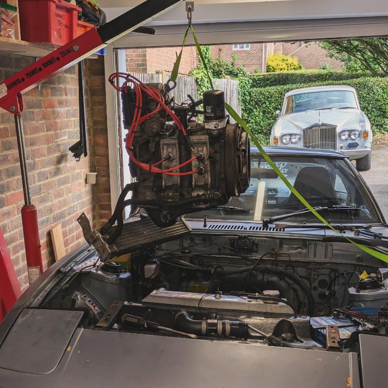

Engine out for a new clutch release bearing, but change entire clutch assembly. Glad I did as it had the 215mm clutch which had been rubbing on the flywheel, 225mm fits perfectly.

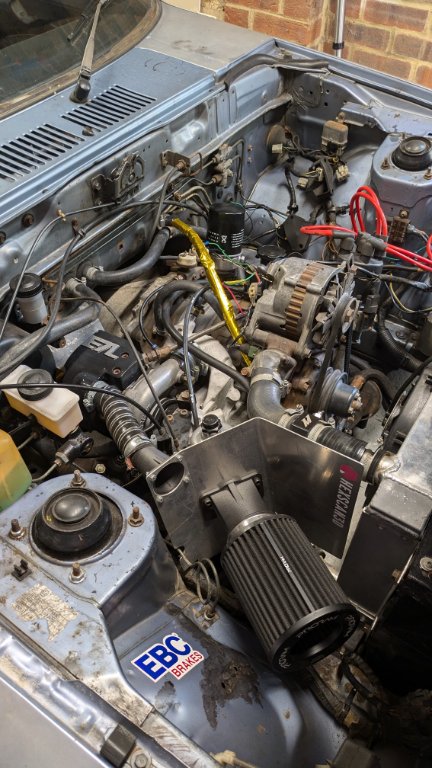

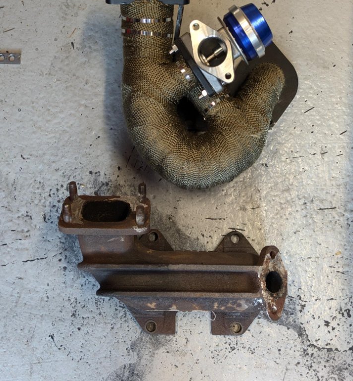

I also got fed up a couple of month back of the Elford manifold constantly not sealing so I made a new one, complete with turbosmart wastegate
Made a huge difference in turbo spool, and it made 7psi at 4000rpm and wastegate opened, which was daft so it's now got a 10psi spring in which it only opens at WOT at 7000rpm
I also machined the SU needle in the mid range last week to try and get a much safer AFR, happy to report it now doesn't climb above 14.2 and cruises at 13ish. Seems a lot happy. Next up is to bin the original back box, I hadn't realised just how restrictive the design is inside it also rattling like crazy.

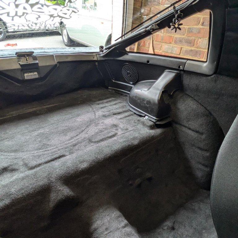

I've also spent the day carpeting the inside rear
