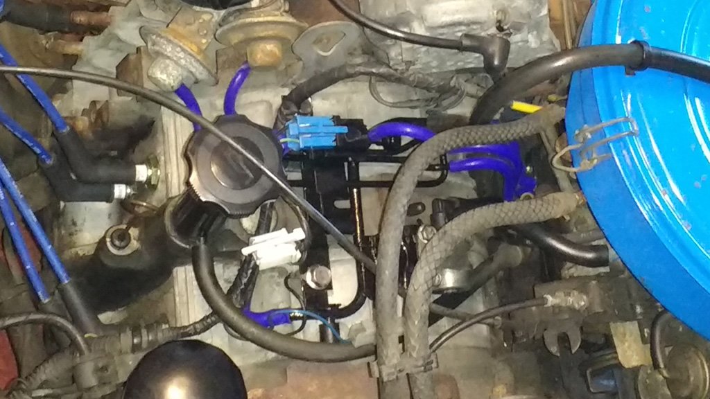

Posts: 1336
Has thanked: 511 times
Been thanked: 454 times
Re: ongoing re commission of our RX7
Not sure if this will help Russ? Old pic of my vacuum setup on KIMI 2 (which is now sold). I know others have removed even more (including the vacuum solenoid with the light blue connector).
Vacuum Nest 1024.jpg (147.68 KiB) Viewed 118576 times

well, I reckon that may be about what ours has on it, 2 vacuum advance retard units, and those 2 thinks on top of the engine, the black plastic one with an electrical plug and the one with two connections of a larger hose and smaller hose....not sure what they do! :D
