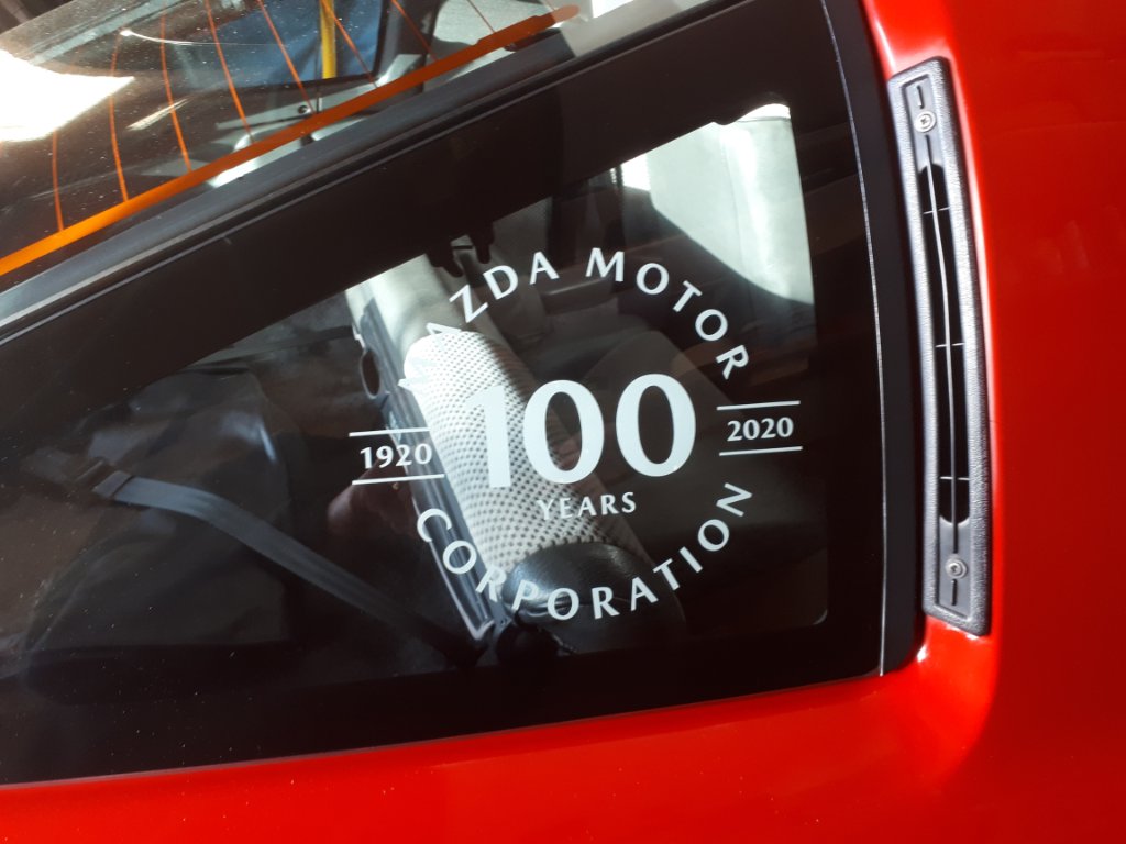

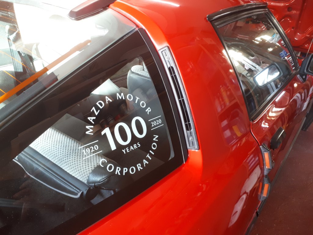

A bit of tarting up for the 2020 show season :D
Car is in the garage, so not easy to get a good pic. I'll take some more when out and about.

Where did you get the sticker?
Posts: 1337
Has thanked: 512 times
Been thanked: 455 times
Re: KIMI 3 - 1984 Series 3
Hi Kevin - i bought them off Adam Galtress (an RX-7 FD owner) through his eBay shop:
https://www.ebay.co.uk/itm/Mazda-100-Ye ... 4902.l9144
£3 each posted :thumbup:
I asked him to make a slightly smaller size than his "standard" one of 185mm height, so it would fit easily in the rear quarter. He did that at no extra charge. Mine was 155mm height.
I have to say I'm very pleased with the result, fitted inside the window.

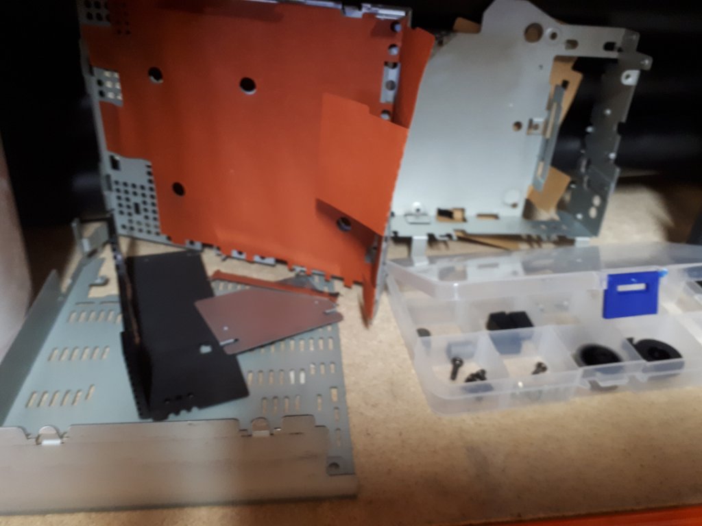

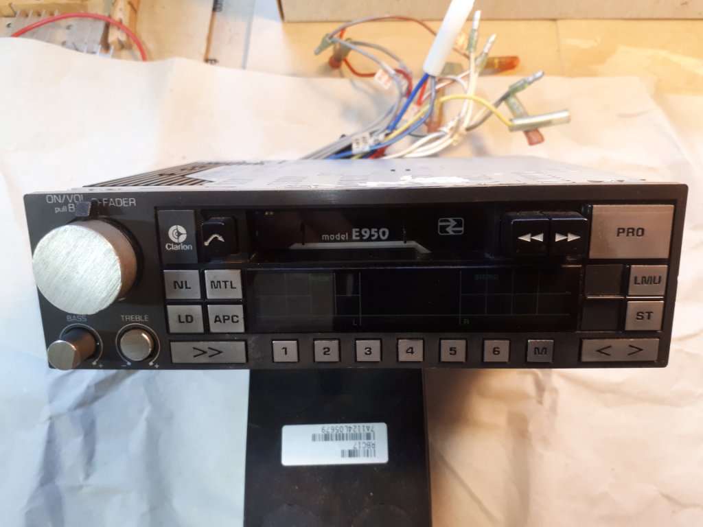

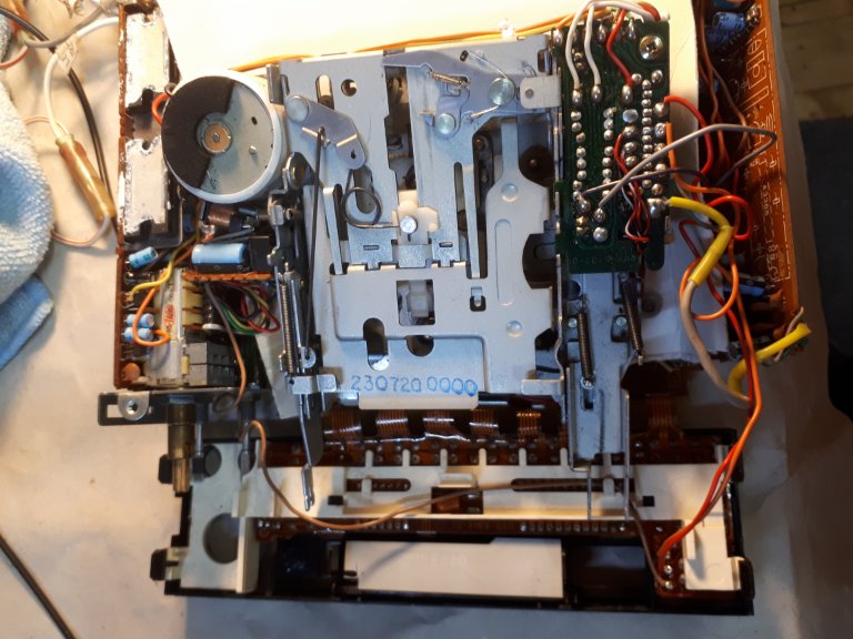

The FM radio has not been working on the Mazda OEM original Clarion E950 radio, which has been annoying. I decided to take a look today. Removed the radio from the console, which was fiddly, but no issues. Then I set up a power supply, aerial and some speakers in my shed as a test rig.
Same result on the test rig; AM radio OK, by FM dead. OK, so it looks like I'll have to take it apart and see if I can locate the fault.
What a nightmare that was! It took about 45 minutes to get it dismantled, to the stage I could identify the various circuit modules.

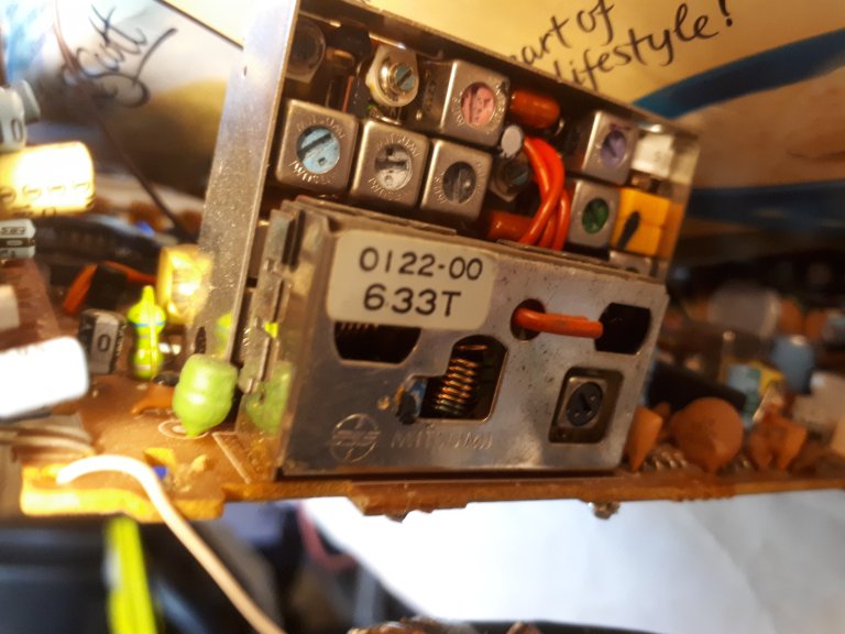

Identified the FM module here, nearest to the front of the pic, with the label attached:
I tapped that module with a handle of a screwdriver and BBC Radio Essex on 103.5 FM burst into life! Yippee, so just a dry joint probably. I can't see any obvious poor joints attaching the module to the circuit board, so it might be inside the module. More work to do to locate it, then all I have to do is remember where this lot went, and it which order, to get it all back together :crazy:
