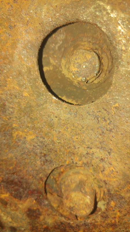

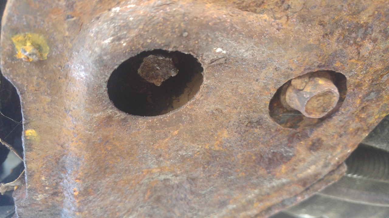

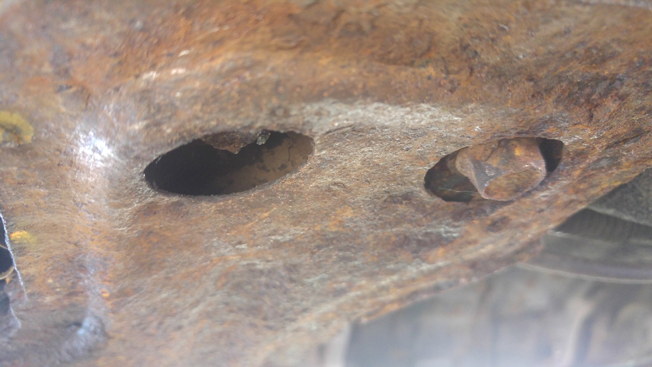

Ok so a brief update, I have 1 stubborn nut on the subframe... Recessed and rounded. Otherwise the subframe would be out too. But slow progress is still progress.
I apologise for the dull pics of my rusted nut. But a U.S pro Bolt extractor sockets have failed on it. I don't want to drill into it but was considering an impact wrench and flat headed screw bit and cut a line through the bolt , if I can access it as it's recessed... I tried Weld however it didn't stick to it either. Any other ideas, it'll be under alot of torque to I guess alot of the options are ruled out like using a chisel? But I've very little experience of rounded nut removal... So all the advice is welcome.

Its the recessed nut...
Top nut in this pic...
Some pics, and the wiring loom looks like it might be an issue long term, nightmare to remove and looks fragile ... Still no rust repair either all very mundane and so.old so far.... :roll
Lanzaroze looms next week so progress will remain slow.
Rich
Re: White Fc Convertible
I would drill a hole in the head of that bolt, just a few mm. Then weld another bolt into the hole you made. This way you make a stronger weld. Chances are that the tightened bolt will already come loose due to the heat of the weld. Try it out, i did this more than once. Make sure that the welding surface is free of rust, otherwise it will not stick.

A last minute effort to release the bolt today before a weeks holiday was a success. Meant is I can truly relax for the next 7 days .. With a baby and 4 year old   ..
No exciting pics this time, but a ruined bolt and socket done it .
