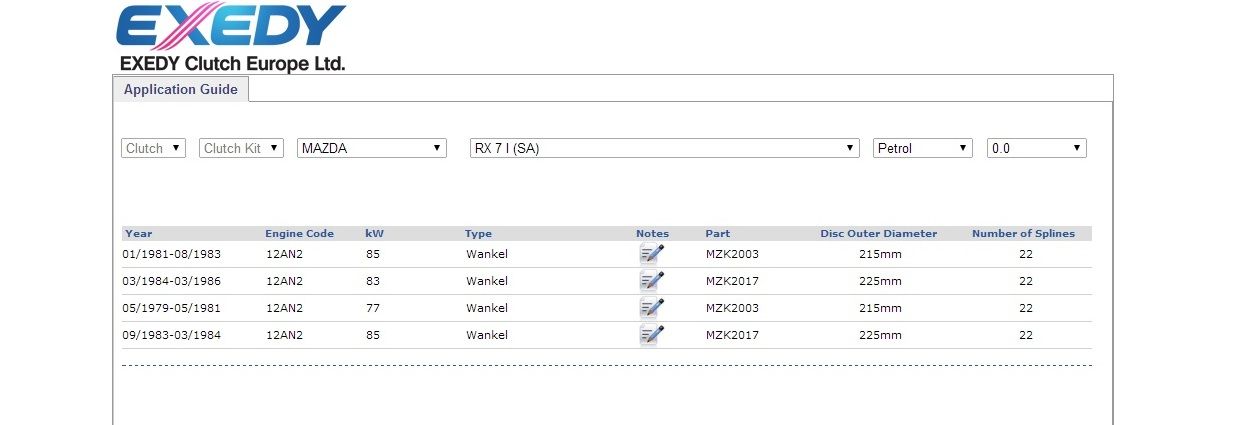

This is very confusing. If you go to the Daiken (now Exedy) website, their kit is MZK 2017 and is claimed to fit 1984 thru 1989, 12a and 13b) So the kit for the S4 (na) should be ok! http://ww3.elcome.co.uk/Exedy/Default.asp?i=30
Re: clutch kit
KiwiDave wrote:This is very confusing. If you go to the Daiken (now Exedy) website, their kit is MZK 2017 and is claimed to fit 1984 thru 1989, 12a and 13b) So the kit for the S4 (na) should be ok! http://ww3.elcome.co.uk/Exedy/Default.asp?i=30
It also says that clutch fits 09/1983 - 03/1984 and shows a different part number for a s4 FC. I would disregard all these internet sellers who say a FC clutch fits the series 3..... if someone tells me that they have physically taken a clutch off a series 3 and bolted it to a series 4 and it worked ( or visa-versa) then I'll believe it but otherwise, I think they are different which would explain why the clutch cover Rich bought doesn't fit...... 'cause it's a FC clutch, not a Fb series 3 clutch
