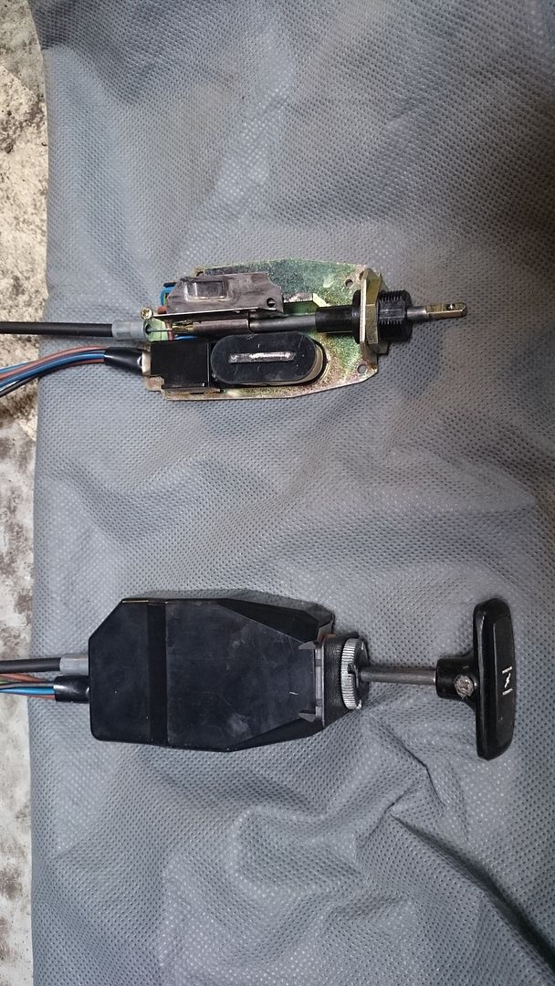

So it's time to get those last minute jobs done. First one was to swap out the electric choke unit. It's surprisingly straightforward apart from the contortionist bit working under the dash. A few bits helpfully fell out whilst removing which was strange until I got the whole unit out and figured why :o (removed unit on top)
Someone's been fiddling :!:
That's exactly as it came out so may explain why it was non operational? I can hear a switch action from the replacement unit as I move the cable in and out so that's a good start. I have a spare relay as well just in case.

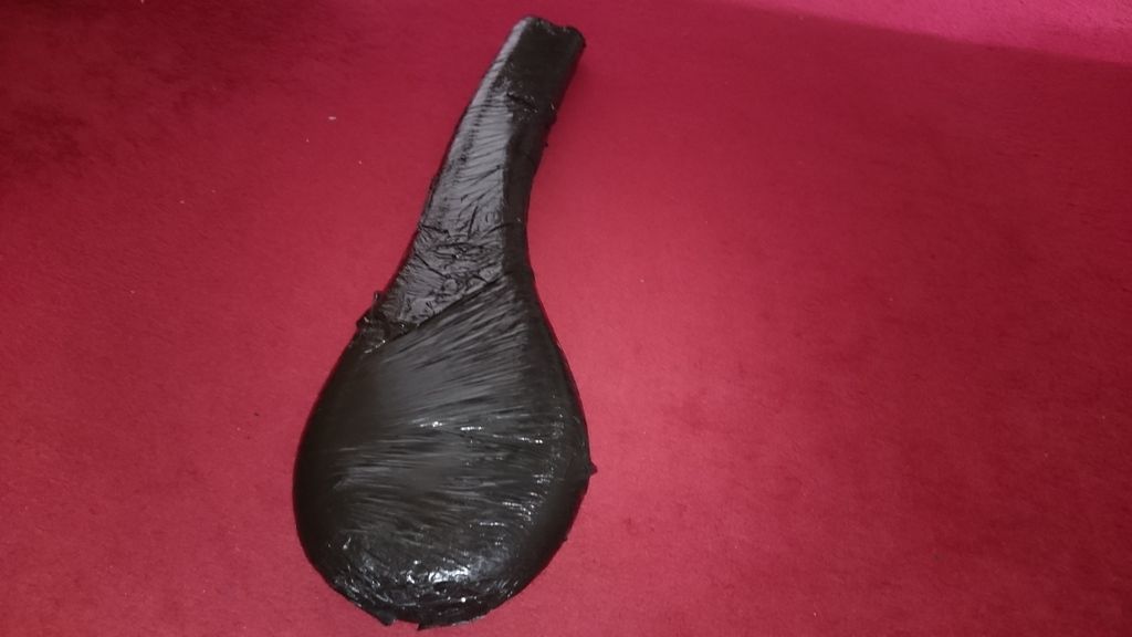

And this arrived today ..... Wife is curious :twisted:
Re: TWiR 1986 S3 TWR
Love spoon? :?

Lucky wrote:Love spoon? :?
Hahaha ... I like your thinking there. It's flexible but rigid at the same time and kinda like the stuff you use :oops:

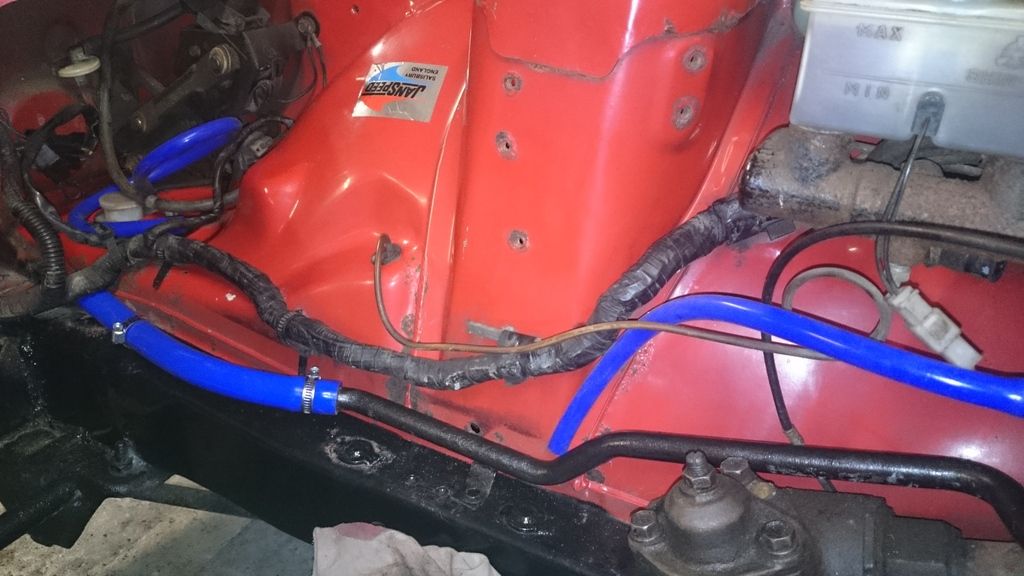

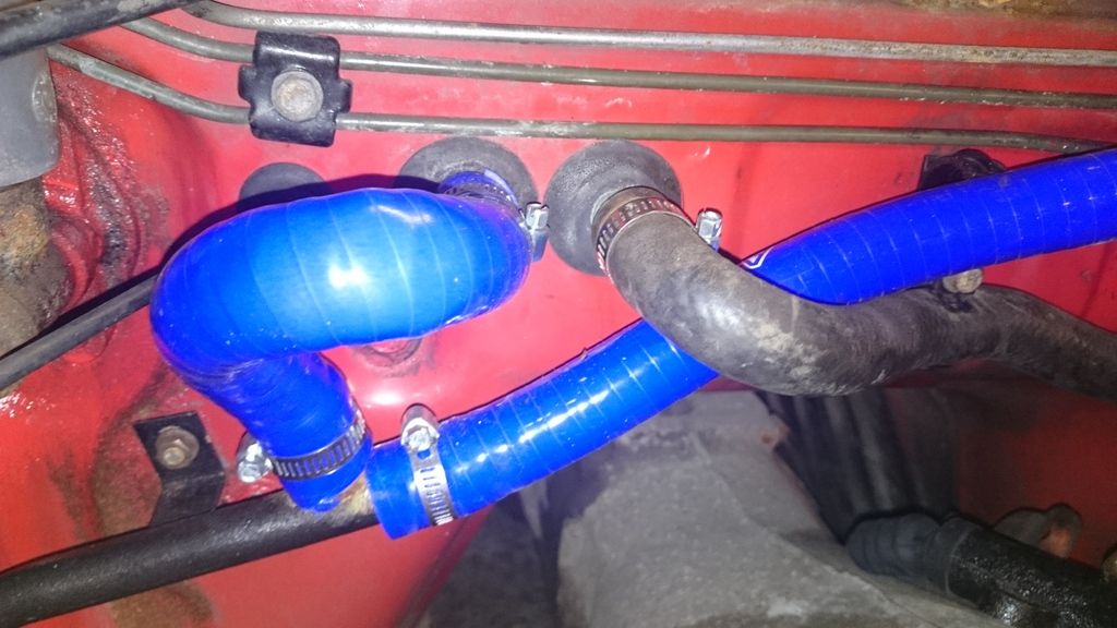

I'm a silicon hose virgin really. For instance, I've just discovered that I can get 120 and 180 degree bent sections as well :o Anyway, I thought I'd try this as all the water to oil cooling hoses are the originals and the standard reinforced silicon stuff ain't man enough for that bendy action.

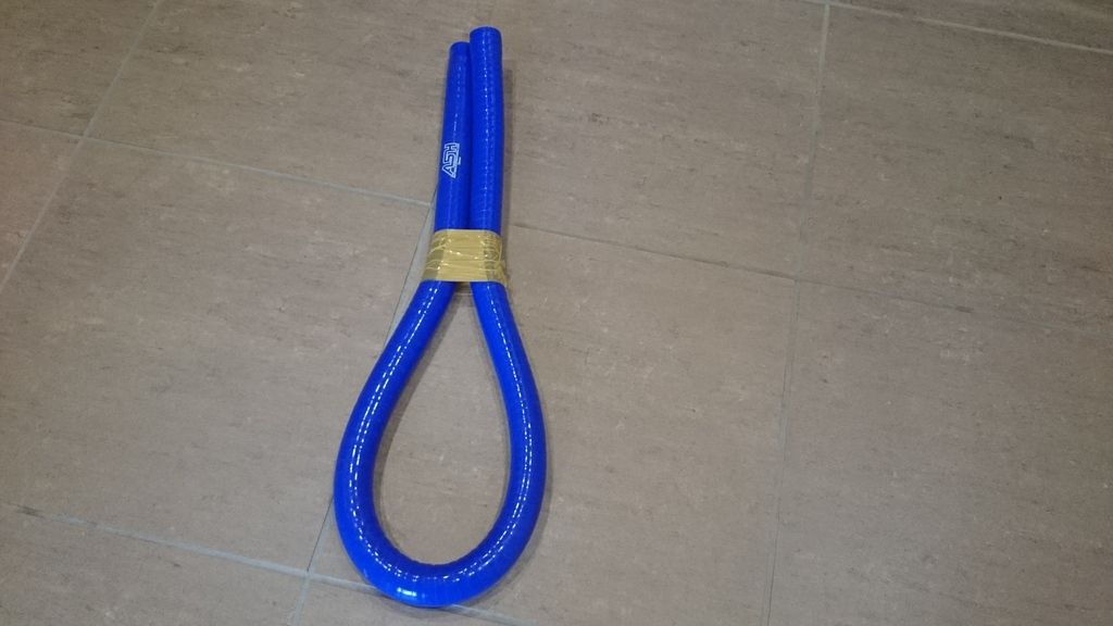

Got some flexi hose in this afternoon
A meter ain't quite enough though which is annoying. Will re use some of the old stuff for now as it's all got to come off and get trimmed up properly. There's an art to cutting it .... practice required. One more sleep until TWiR gets a heart :)
KiwiDave wrote:A meter ain't quite enough though which is annoying.
lol, I could have told you that ;)
KiwiDave wrote:There's an art to cutting it .... practice required.
Hacksaw and then sidecutters for the wire reinforcer. Or even better, an angle grinder with a thin cutting disc
