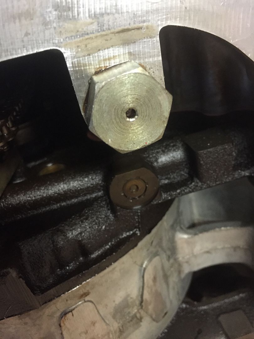

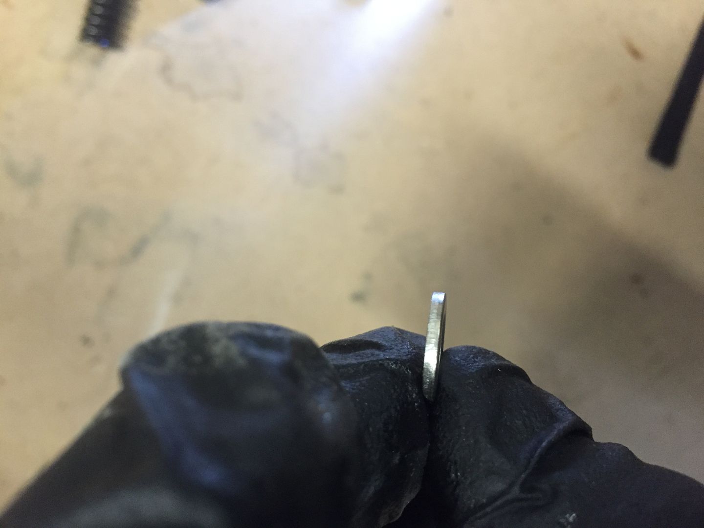

First I took the front reg apart and shimmed it with a couple of stainless washers to raise the oil pressure...

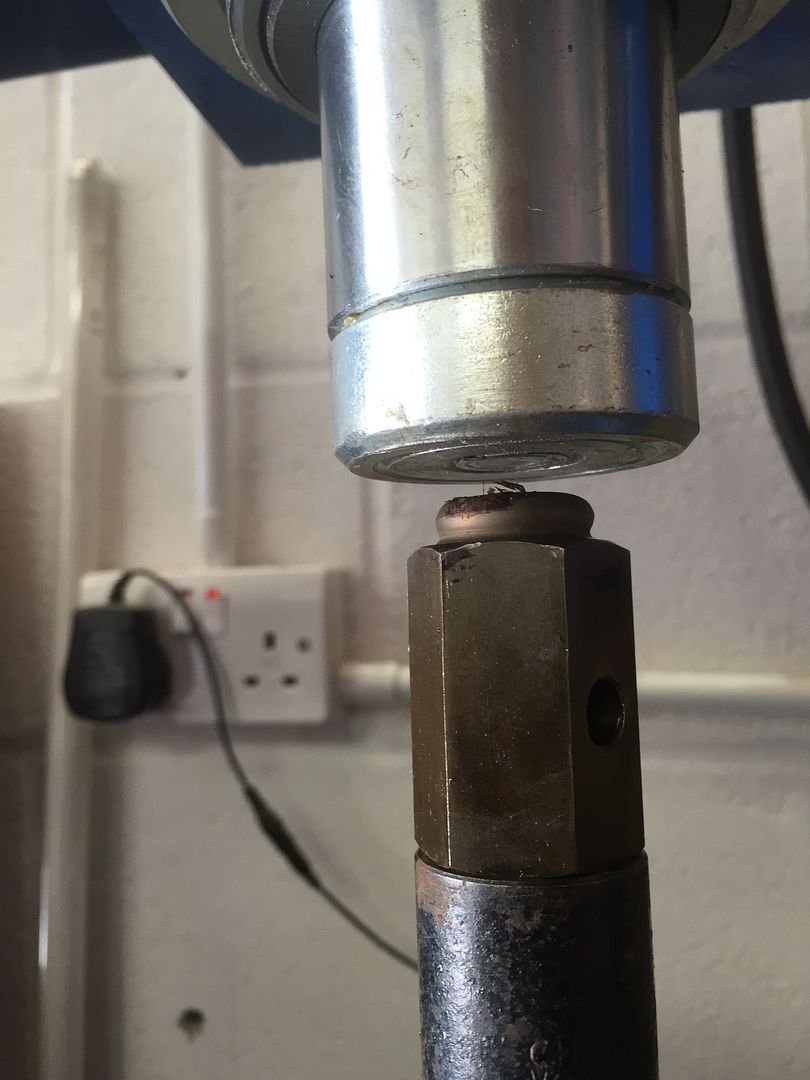

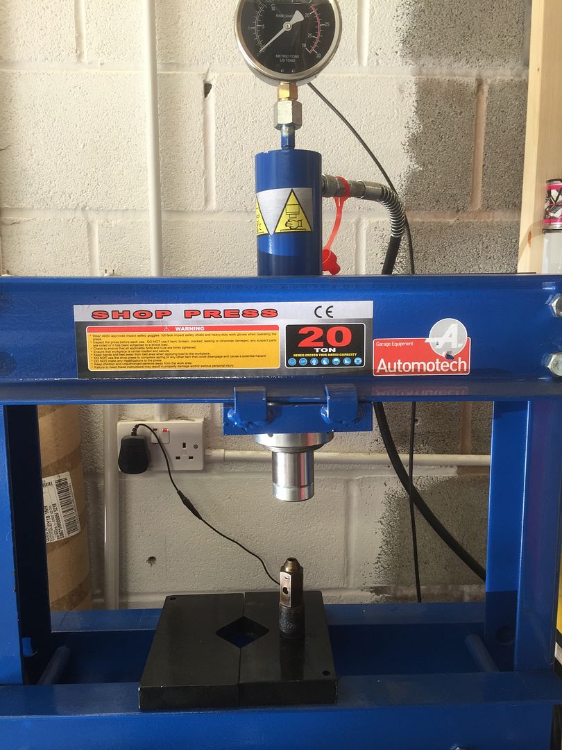

This can't be taken apart easily to be shimmed so I took it out from the engine and crushed it in my press to raise its operating pressure....
then re-fitted it to the engine...

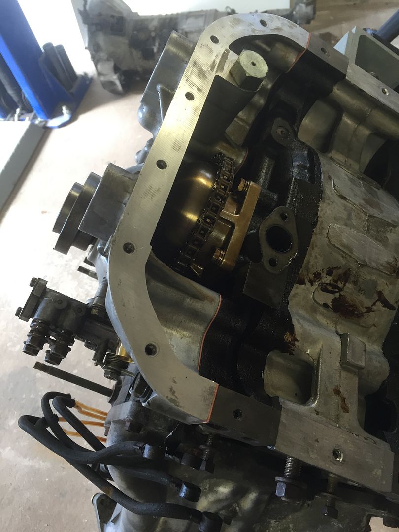

next job was to fit the oil pickup pipe using a new gasket....
Then at last it was time to fit my lovely, shiney and very expensive GSL-SE oil pan...

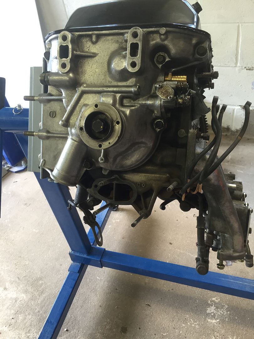

Next job was to fit the water pump housing....... starting with a new gasket to seal it to the front engine plate...

ian65 wrote:and then the rear regulator.

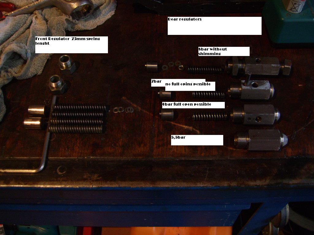

crush the regulator to much ian, there is a possibility it can not open completely anymore. You can control the piston view in the small drill hole if you push with a screwdriver. I take my air compressor and control how much pressure i need to open the valve. I hope you can understand what i mean.
