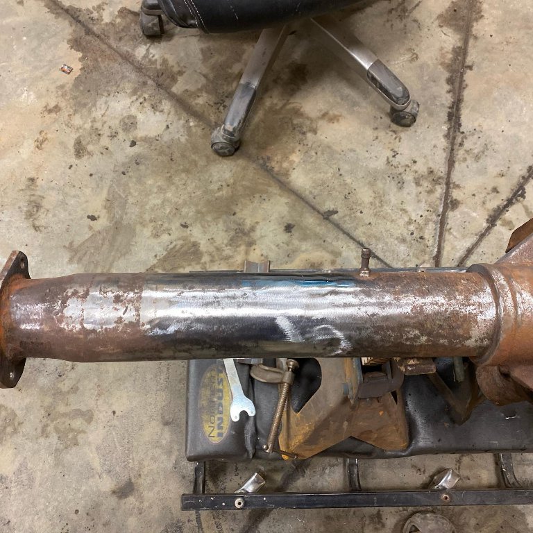

parked the car for the last 2 mths or so due to winter... and being lazy I havent touched it since... so last night I decided screw it lets go play.. Ive been watching a show called Texas Metal and got my juices flowing to mods... haha

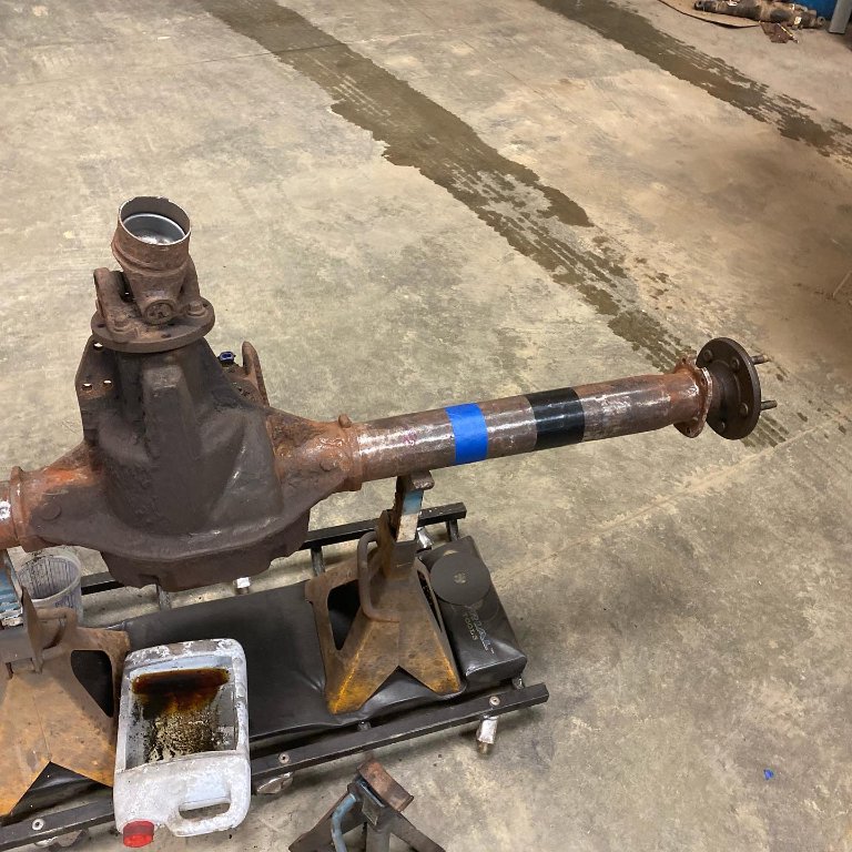

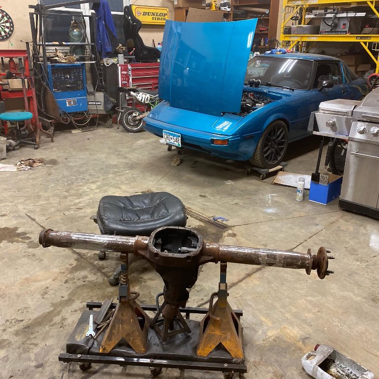

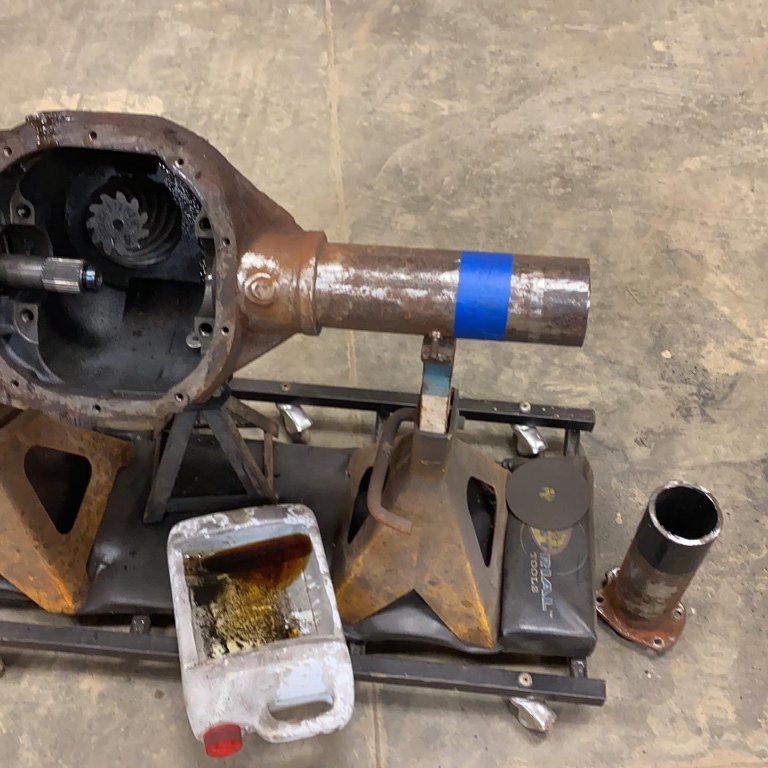

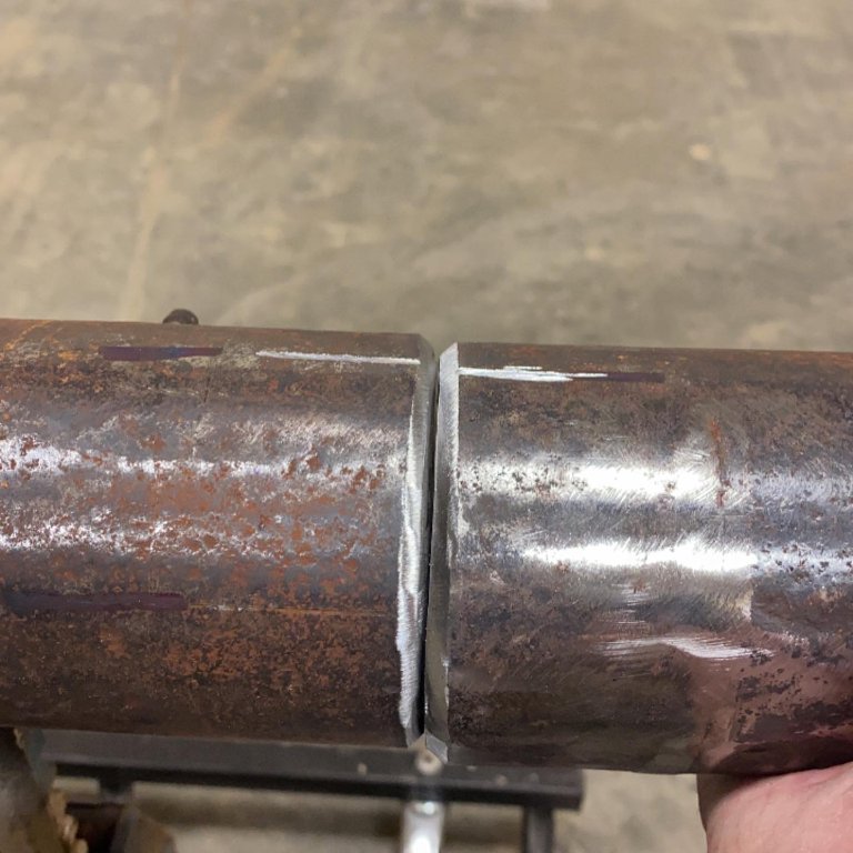

so I started back on the 8.8 rear end shortening... not bad for freehand with a grinder... tonight I hope to get some c-channel and bigger clamps to get the alignment set.. so far the sides are less than 1/16" difference.. aka about .020" or .508mm

As nice as it is making progress a lot. I think it's good to have some time off occasionally aye! The axle casing is looking pretty slick there aye!

Got the rear end welded up... I may stay late and cut out some of my brackets tonight although I cant fit till I have the car up on the lift and stock rear out.. which I dont plan on doing till it blows haha
