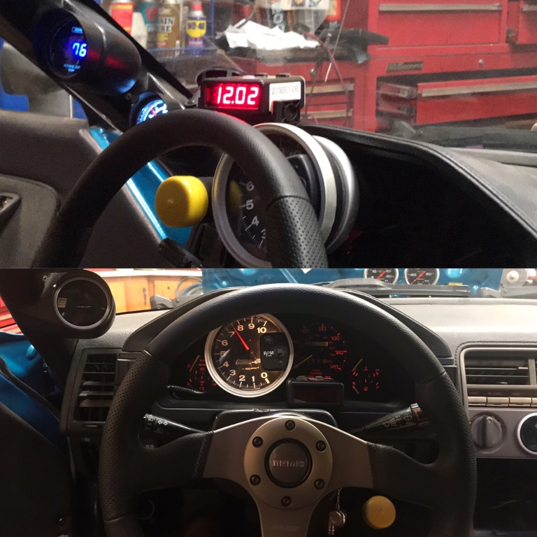

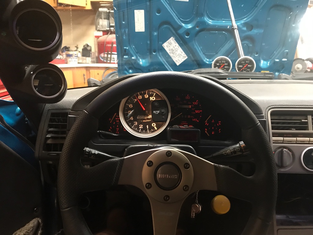

Got some work done on the girl last night..
After riding in a friends rx7 I decided my view was a little crowded.. and I liked the stock cluster.. so I combined the 2 setups..
A mate gave me a spare cluster to experiment with.. is t perfect but I like the way it turned out.. the view is a little less cluttered even though it has the same amount of gauges etc
I also swapped the gear from the fd speed sender onto an fb one with a small amount of modification to the shaft, and cables.. I now have a working speedometer but am yet to see how accurate it is

Surprised how quick you're working on your project th: I got some good ideas from you s(c) and missing your children. So i hope you've time enough for the family.
Are you able check so many display when drive your car near the limit? :lol: :lol: :lol:
