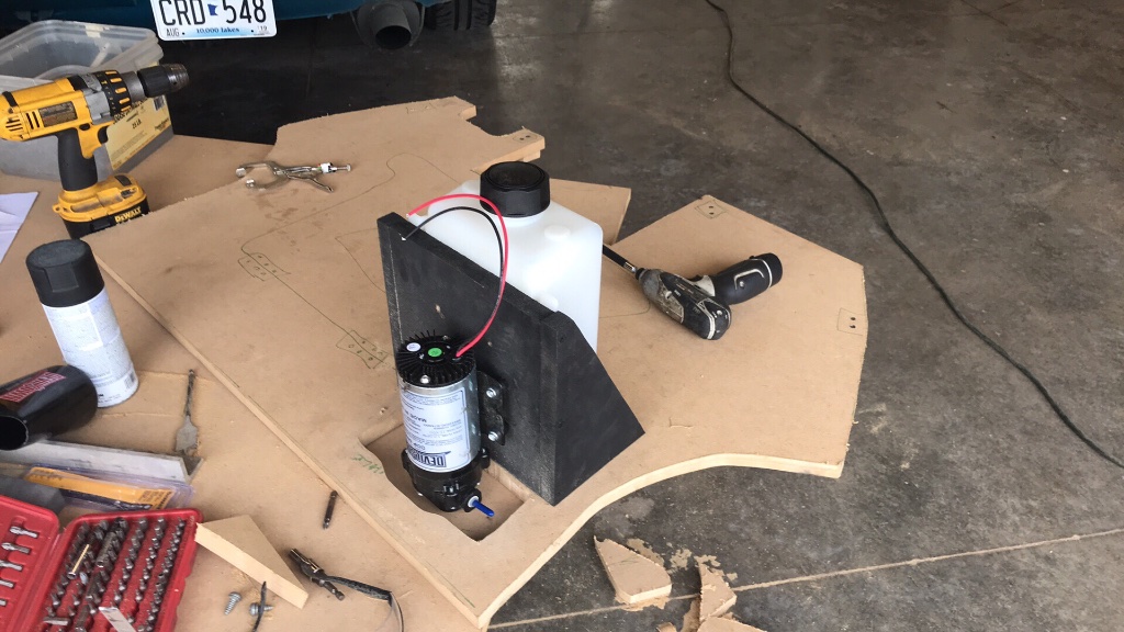

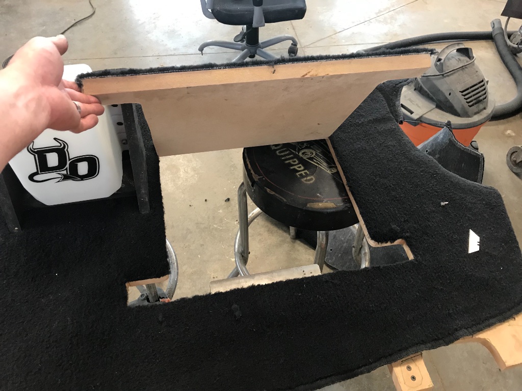

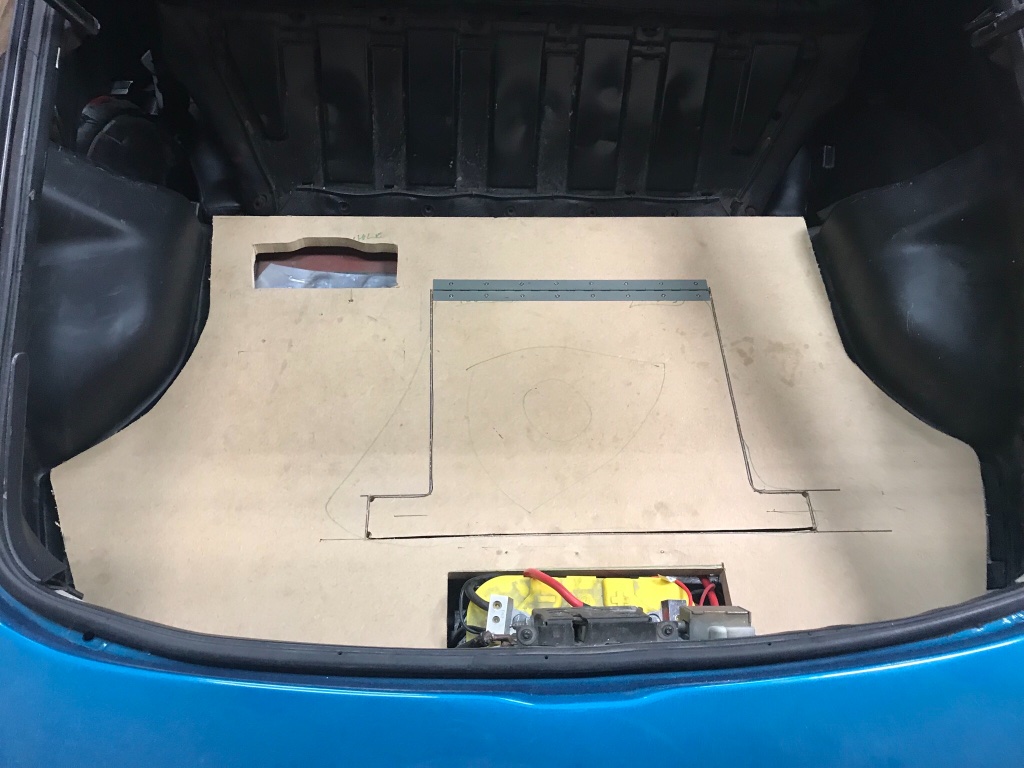

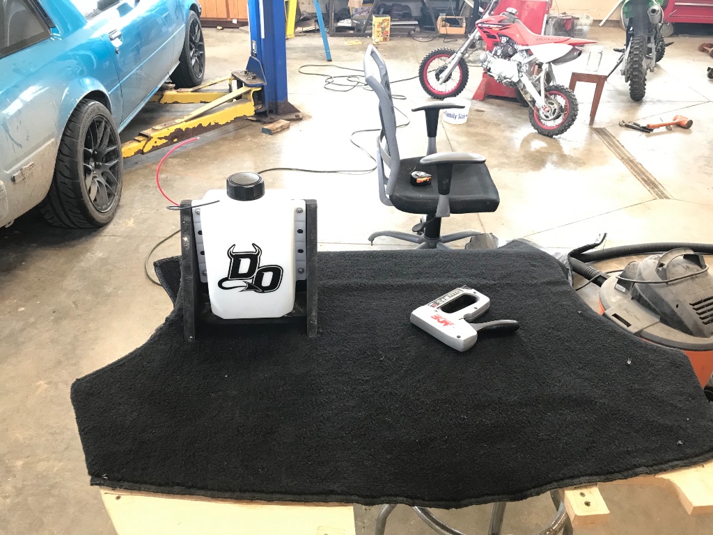

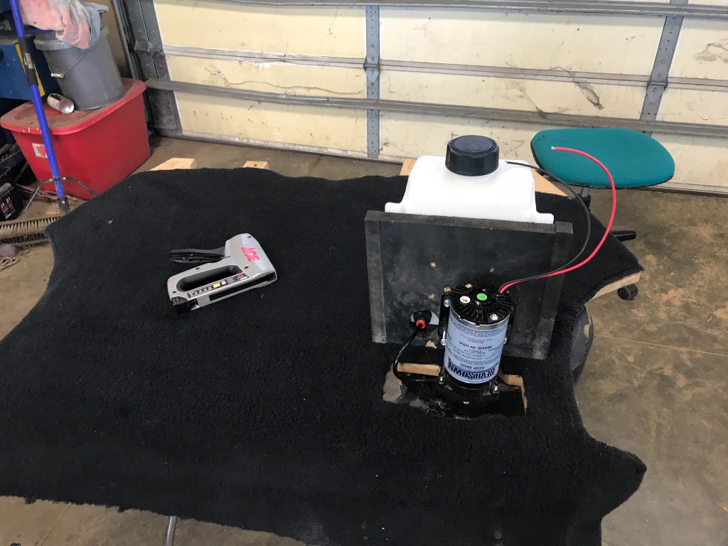

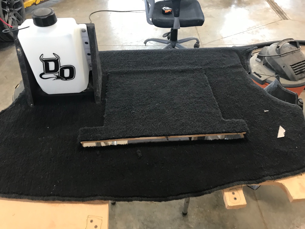

No major updates.. my family is visiting from australia so we have been busy.. have been tinkering in the shop here and there, trying to get the water/meth setup ready for next stage of tuning.. I have about 750miles on the motor so itll be needing the injection at about 1000
Ive been making the rear cargo deck for mounting it all all and wanted access to wheel well for storage
