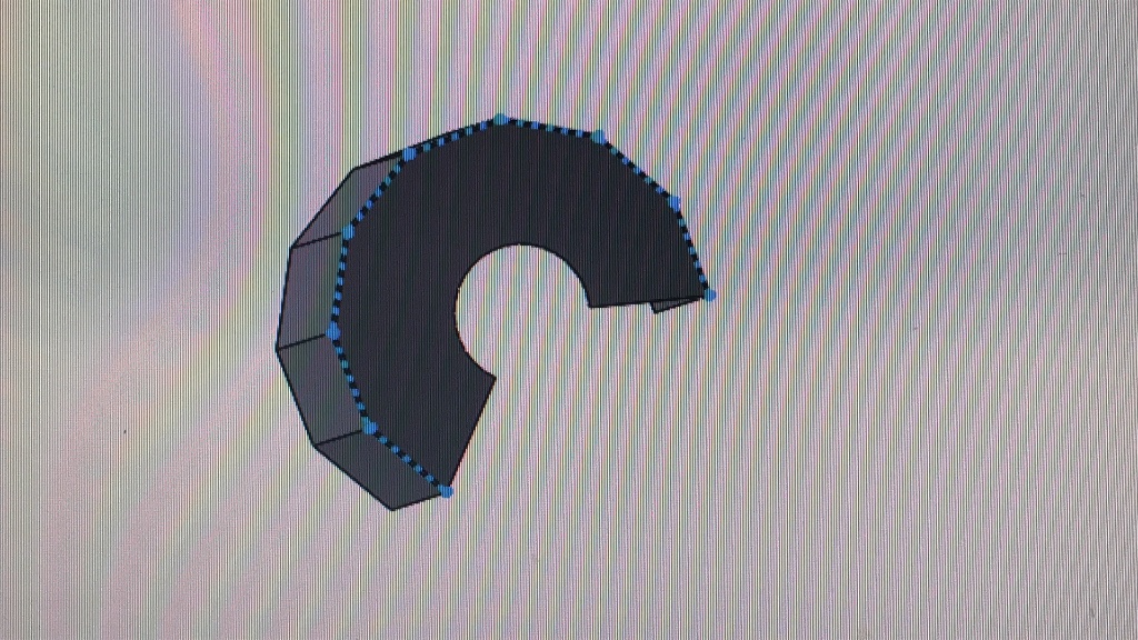

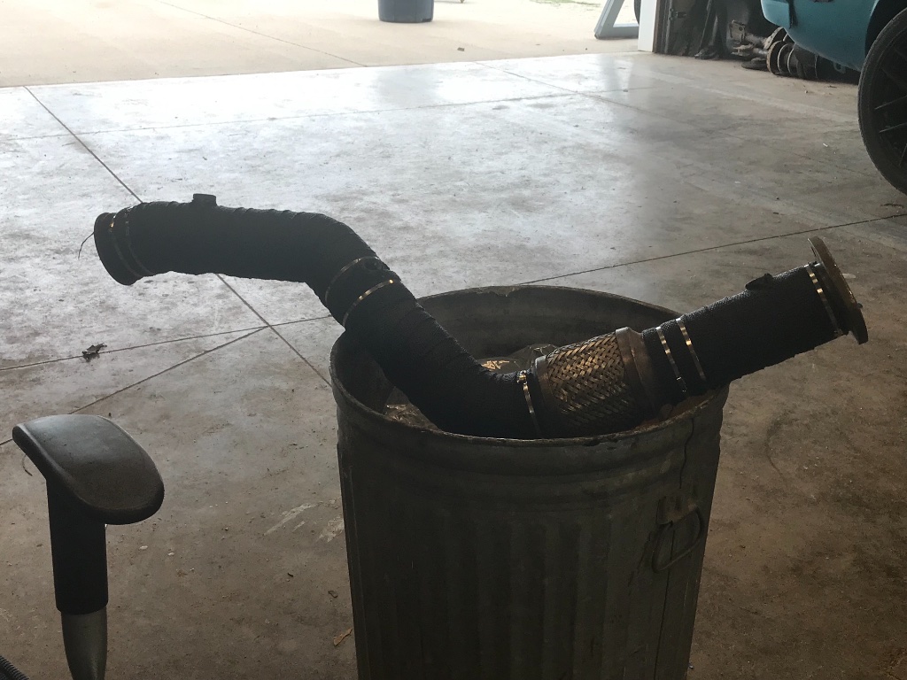

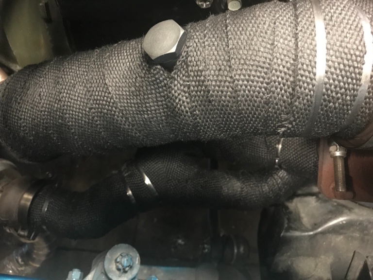

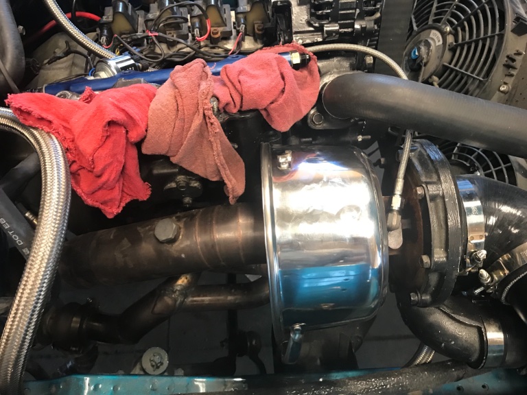

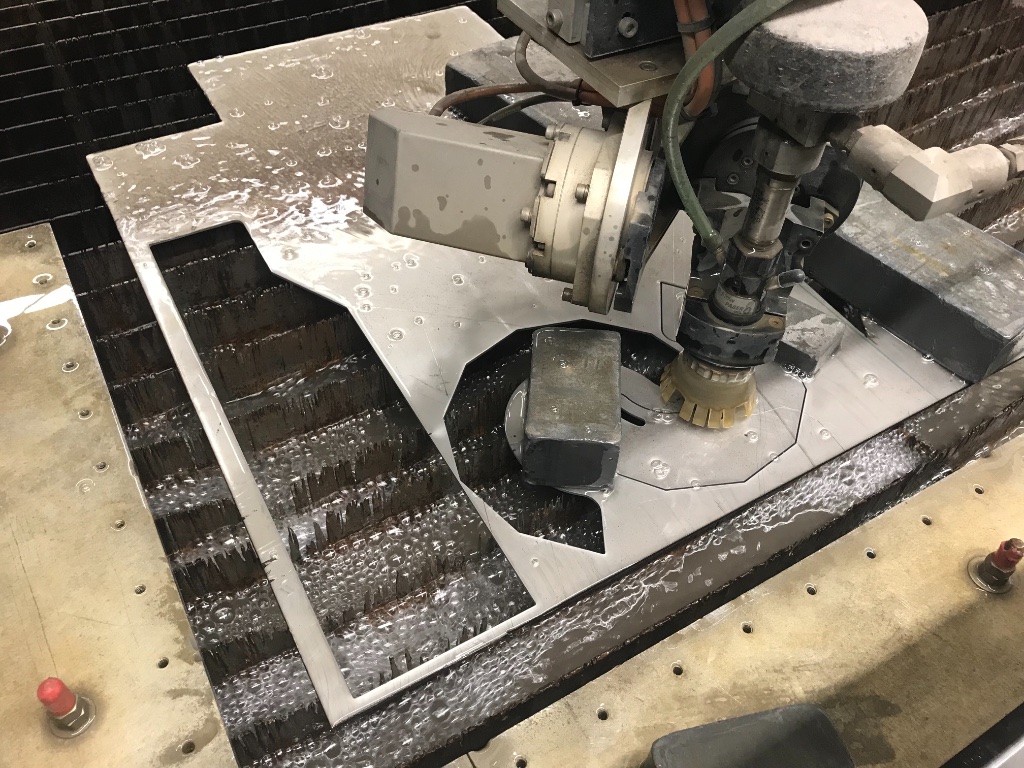

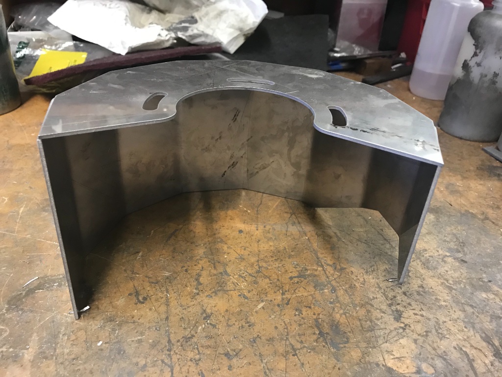

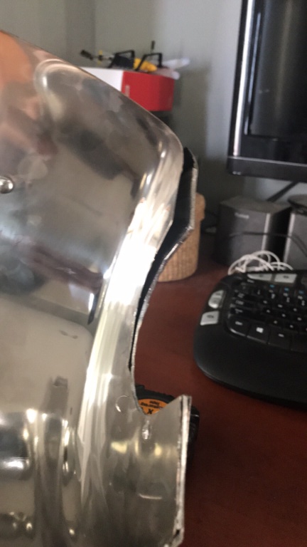

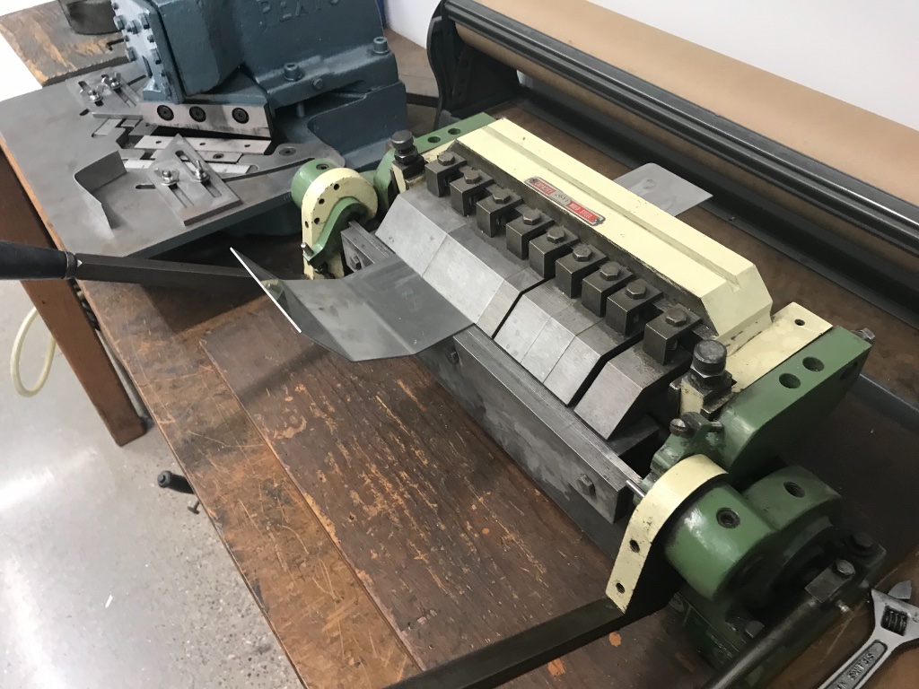

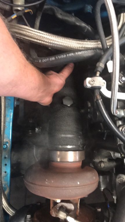

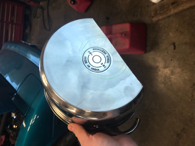

Read on another forum about someone making a turbo shield from a pot.. so off to walmart.. well that failed but it did at least five me some basic dimension and style to design from haha thankfully I can go to work early and make use of all the gear there..
