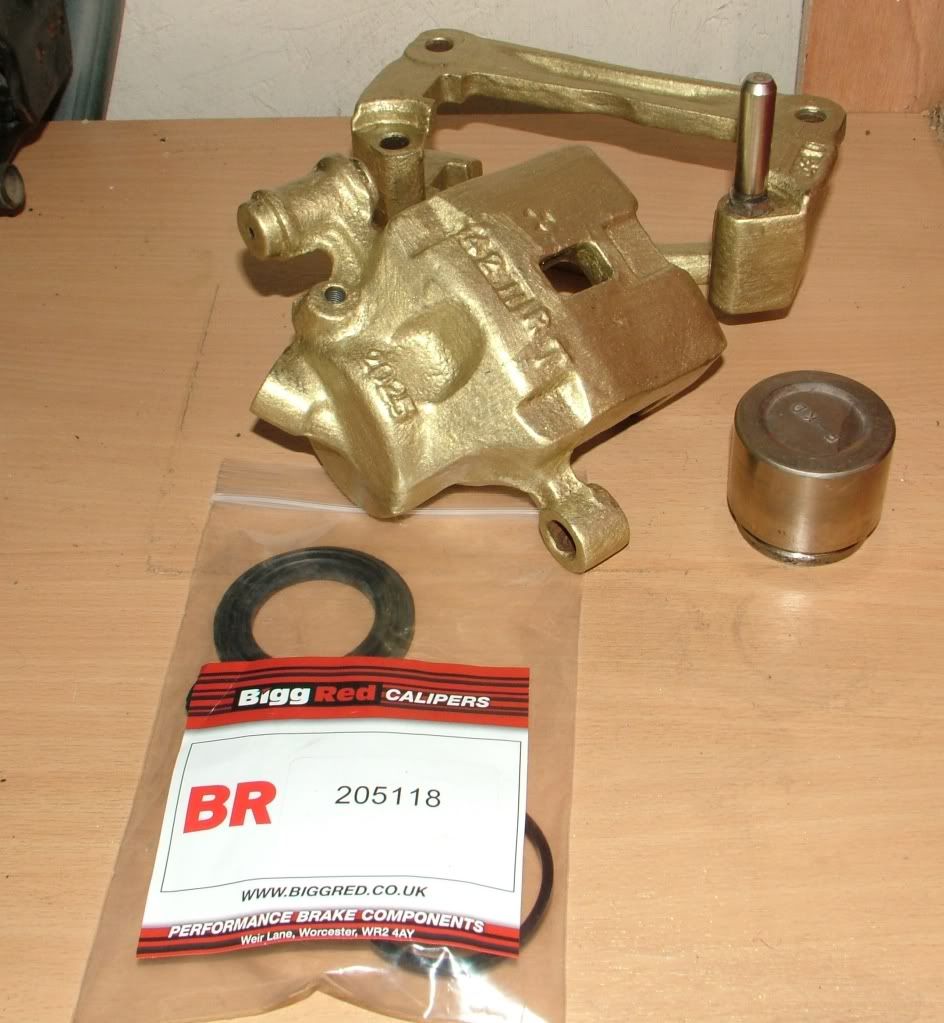

here's when I stripped the calipers earlier in the year...
the pistons were seized solid and had to be pumped out with a grease gun
The calipers were cleaned up and painted, the pistons and bores cleaned up and checked for damage and a rebuild kit purchased...
Here's the 1st caliper reassembled..... I'm putting the other one together tomorrow.
I bought the rebuild kit from here...
viewtopic.php?f=14&t=134
£26.00 delivered next day... very impressed with Bigg Red.
Found a set of Ferodo pads on ebay for the good price of £6.00 and bought these...
http://cgi.ebay.co.uk/ws/eBayISAPI.dll? ... 0720547213
I've already got the flexible lines that I bought last year for my project car but never fitted so they can go on this car when I swap the calipers and pads next week.
Re: Ians series 3 Elford Turbo
They look great Ian, I have been thinking of using these kits for other cars.
Was the quality of the kit as good as they look?

myatt1972 wrote:They look great Ian, I have been thinking of using these kits for other cars.
yeah, excellent

I used these kits when I rebuilt both my fronts ane rears, two years latter still going strong so therefore recomended.
