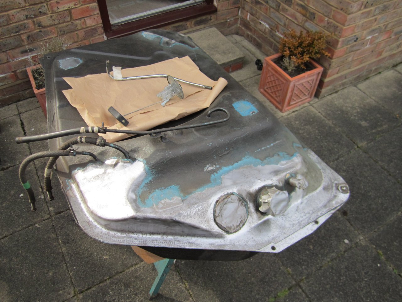

Fuel tank de-rusted:

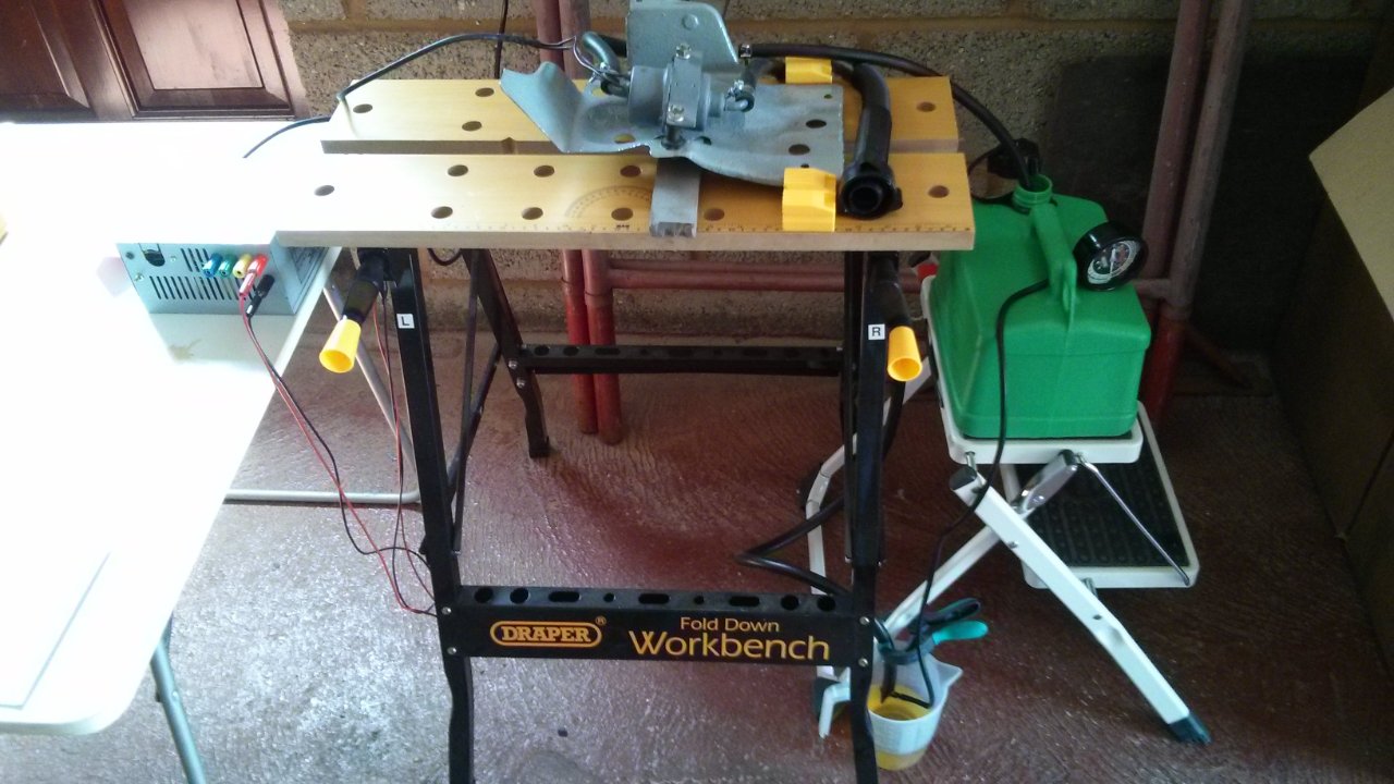

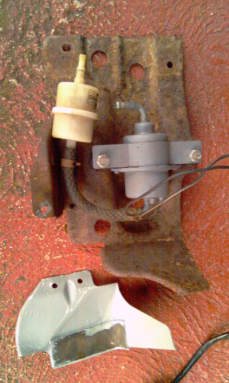

Fuel pump and bracket as it came off the car:

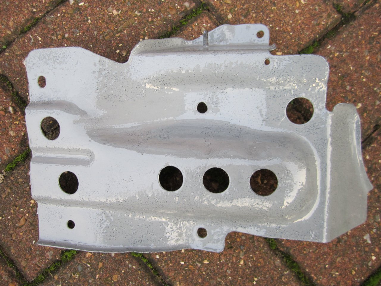

Bracket with full POR-15 treatment and paint:
Testing pressure and flow of fuel pump (tested well in spec):

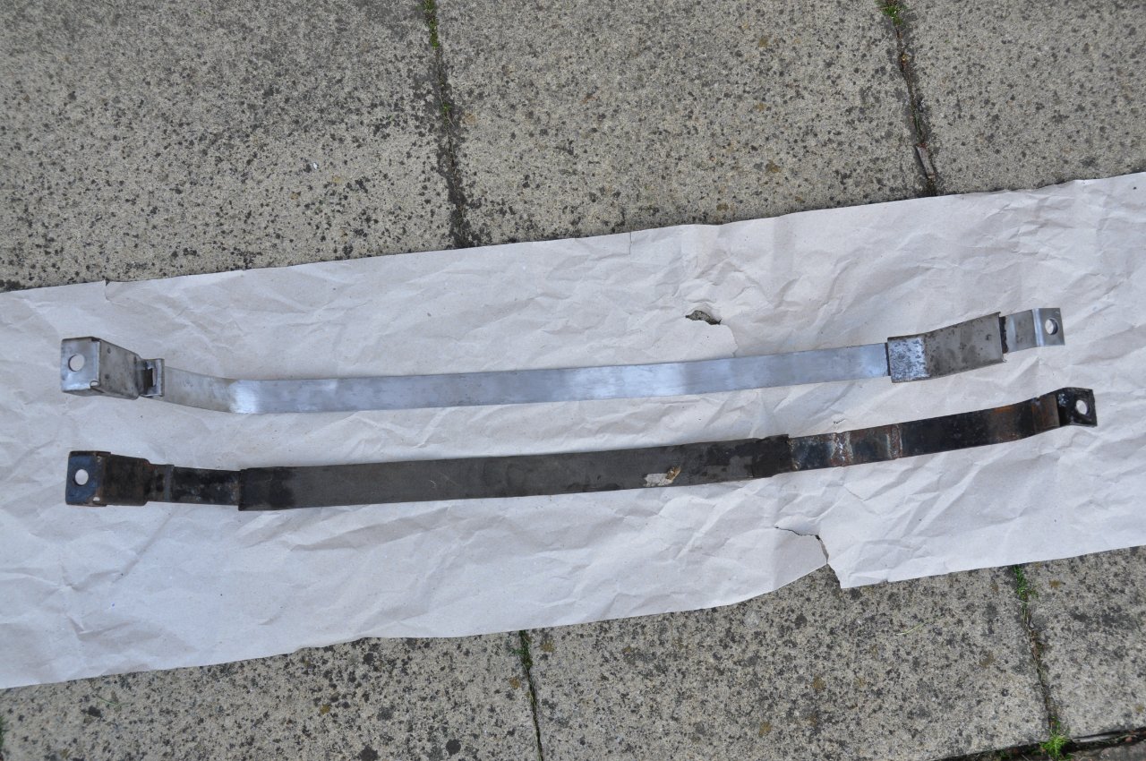

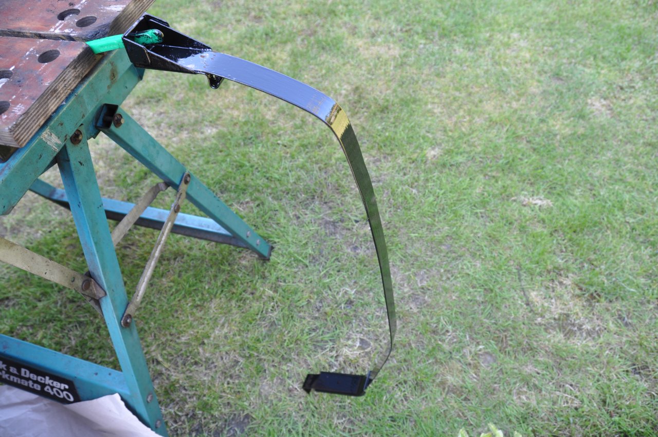

Fuel tank straps mid de-rusting:
After full POR-15 treatment and paint:

The fuel tank sender wan't working, but it turned out to be a simply earthing issue to the top plate. Fised with a wired by-pass and tested OK:

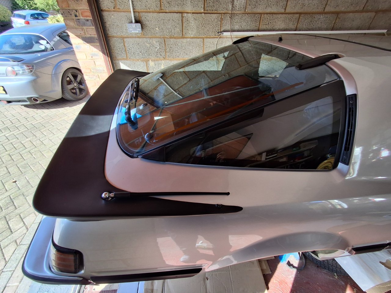

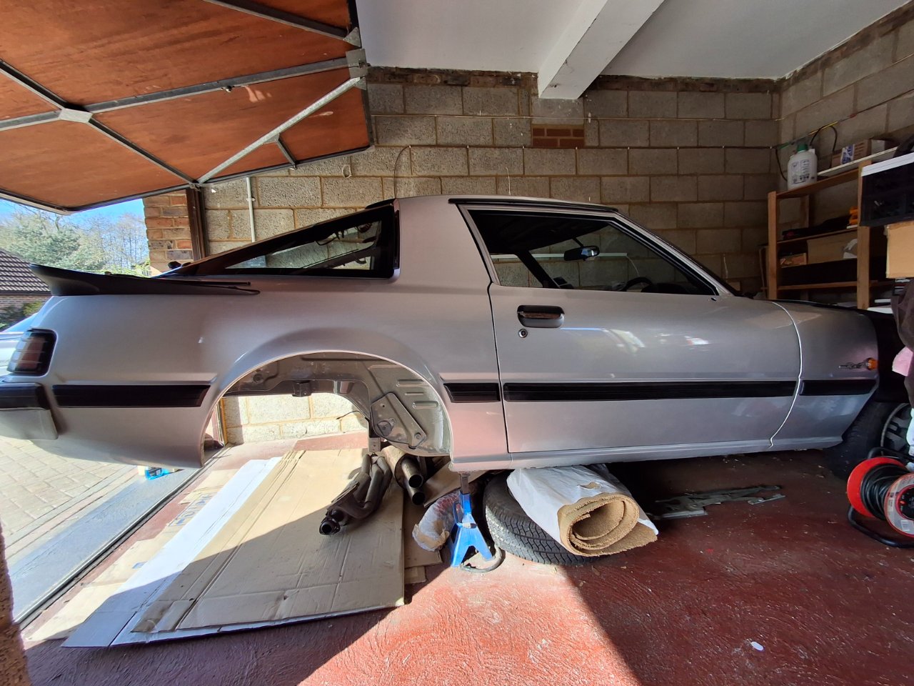

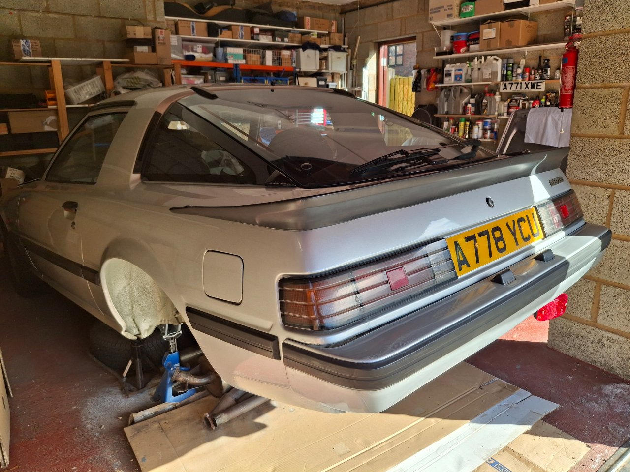

And here is how she currently stands. Pics taken a week ago - driver side card, window, motor and glass guide removed to clean up and replace.
