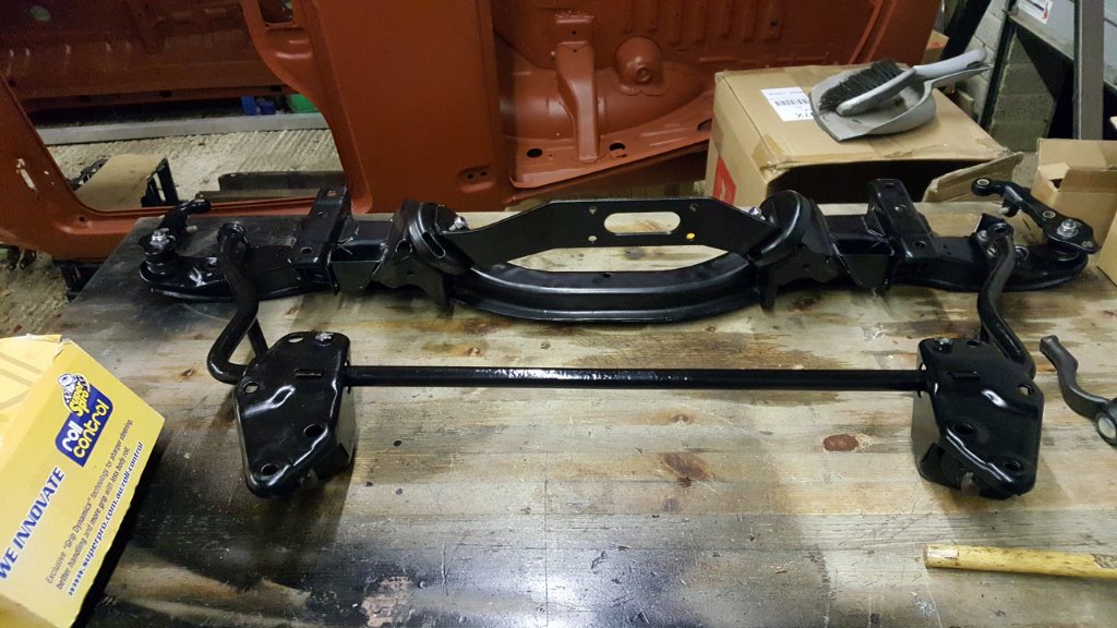

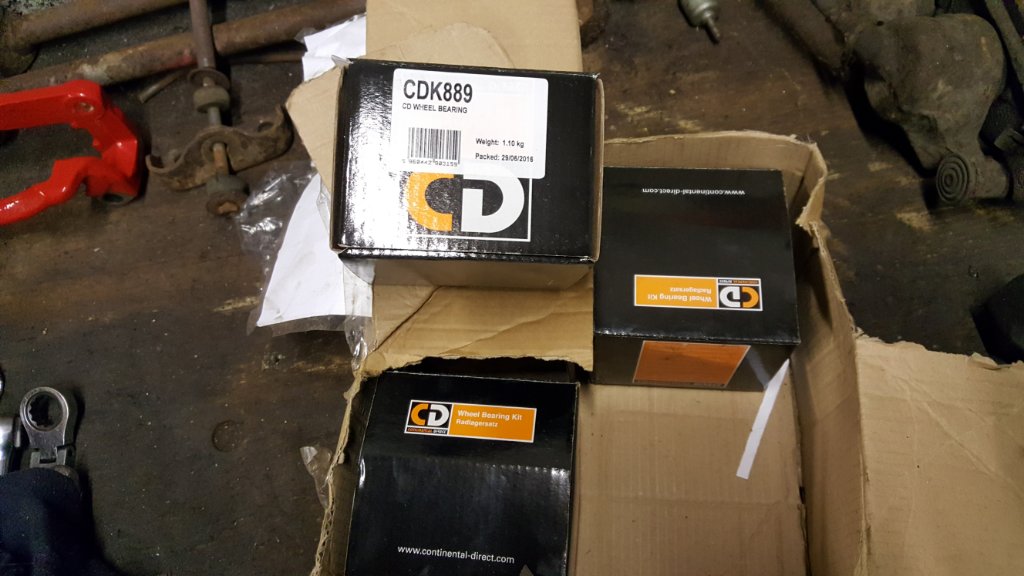

Great site rock autos will sed be placing an order just checking my brakes &discs first I can refurb calipers discs rusty and although I could try and clean up it makes sense to me to buy new ones going 2 buy stabilising bars as rock autos supply them to bought wheel bearing set ages ago opened box they supplied wrong ones will try and get them.2 replace
Rebuilt front suspension
