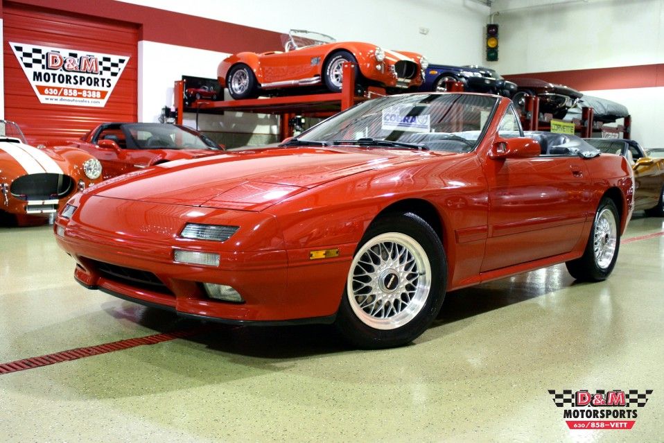

if I find that after the TII engine swap I need bigger brakes, I'm going to put a set of these turbo 2 cabriolet bbs wheels on it... they are 15x6.5
Re: New Wheels - Temptation
That is the look I am after 0-0 ..........I am just hoping they produce 6.5s as the smallest they list is 7.

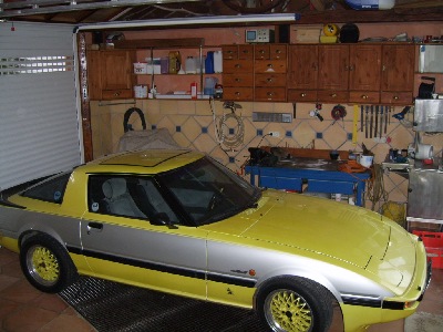

Pete here you can see my KÜWE 7x15 38mm Front 205/50/15 and Rear 225/50/15 i drive these for over twenty years with good results. This was testet by the german TÜV on the Hockenheim Ring :lol: (optional 205/50/15 without fender work).
Better you can get ET 35mm for bigger distance between tire flanke and suspension.
195/50/15 all around on 7x15 ET 38mm is also possible

Thanks Thomas, I do love the Car colour & wheel centre co-ordination. Do you still have the wheels?

I`ve sold the wheels to Michael in Austria, sorry.
7 x 15 ET 30 all around is a very good choise, Pete.
front 195/50/15 Toyo Proxes T1R http://www.reifendirekt.de/cgi-bin/rsho ... 27141927:s
rear 205/50/15
