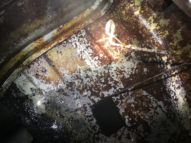

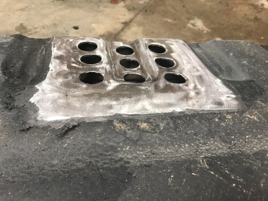

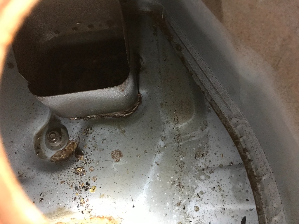

Might actually work out..
Before and after por15
Re: 84GSLSE 13BREW Swap build
Wow, that's come up really well

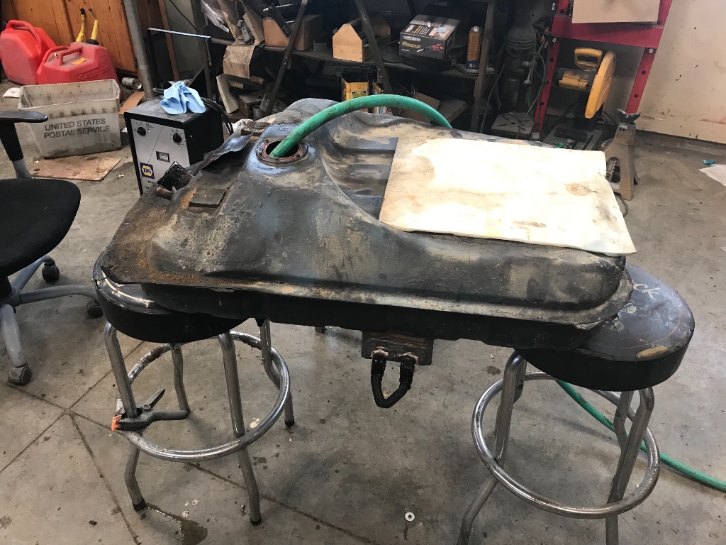

I spoke to early.. it failed.. sections started peeling and now I dont feel confident or want to risk running it..
So I am going to try again with the better tank thats is in the car currently.. but I will try electrolysis first, then go thru the por15kit.. I watched Aaroncakes video and after I realized it failed cause I rushed it...

Ahh yeah. POR15 is very specific about how it needs to be done for it to work properly aye. Fingers crossed this next attempt works out :D

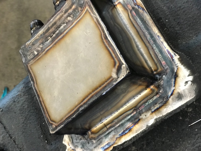

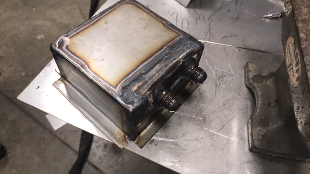

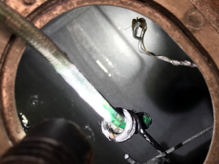

Tank attempt 2.. changed the pot design... I made a test box to test the magnifier I got as my eyes suck short distance now being mid 40...
It worked.. I could see the puddle.. so I purged the tank and welded.. let it sit for 4plus hrs.. not one weep or drip...

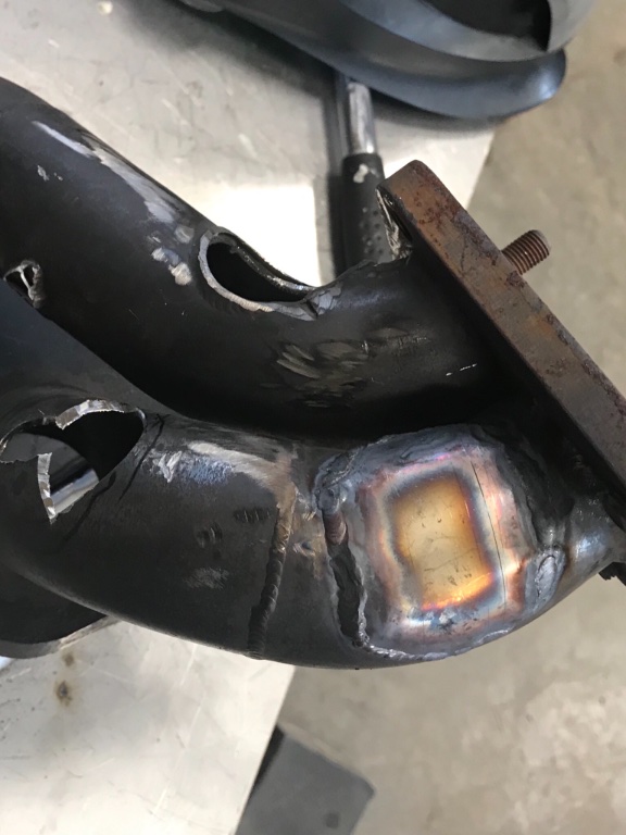

Also patched the holes on my exhaust manifold as I am moving the wastegate outlets more inline with the exhaust outlets...

Also the tank I had in the car was mint so I may not even seal it

DWNUNDR wrote: Mon May 20, 2019 6:13 pm Tank attempt 2.. changed the pot design... I made a test box to test the magnifier in 6jpeg8E48693B-1F06-452B-9608-CFB40C8669D4.jpegDAF4C722-3D4B-4829-972A-D24241706203.jpeg
Should be good having a drain plug, getting out the mud was building in that sump!

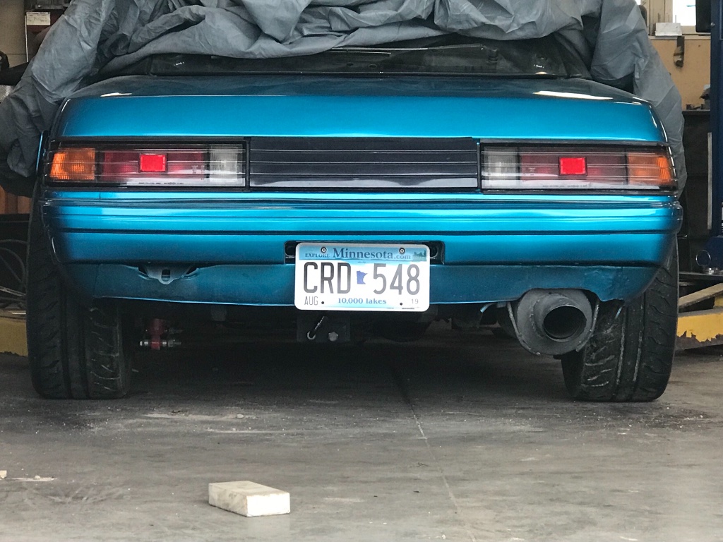

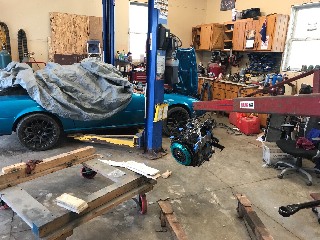

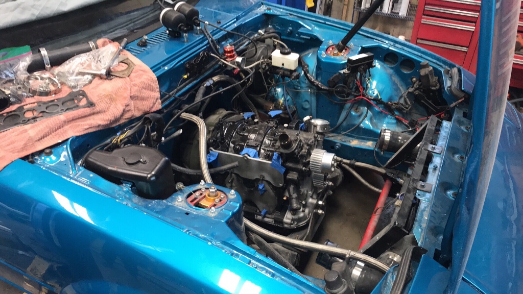

Motor is back in
Gas tank is in

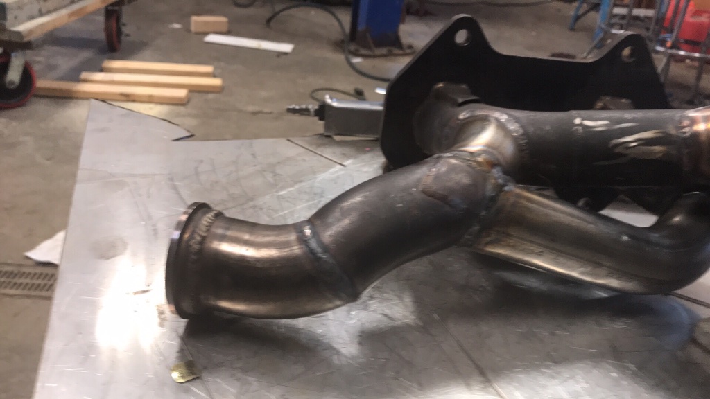

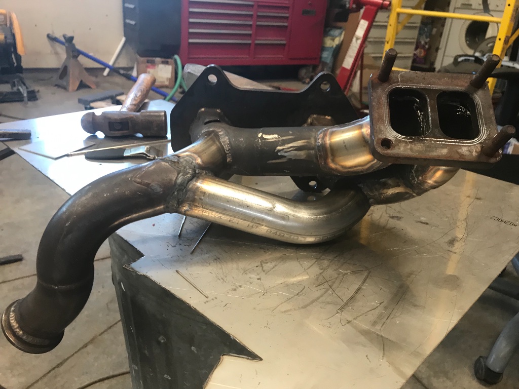

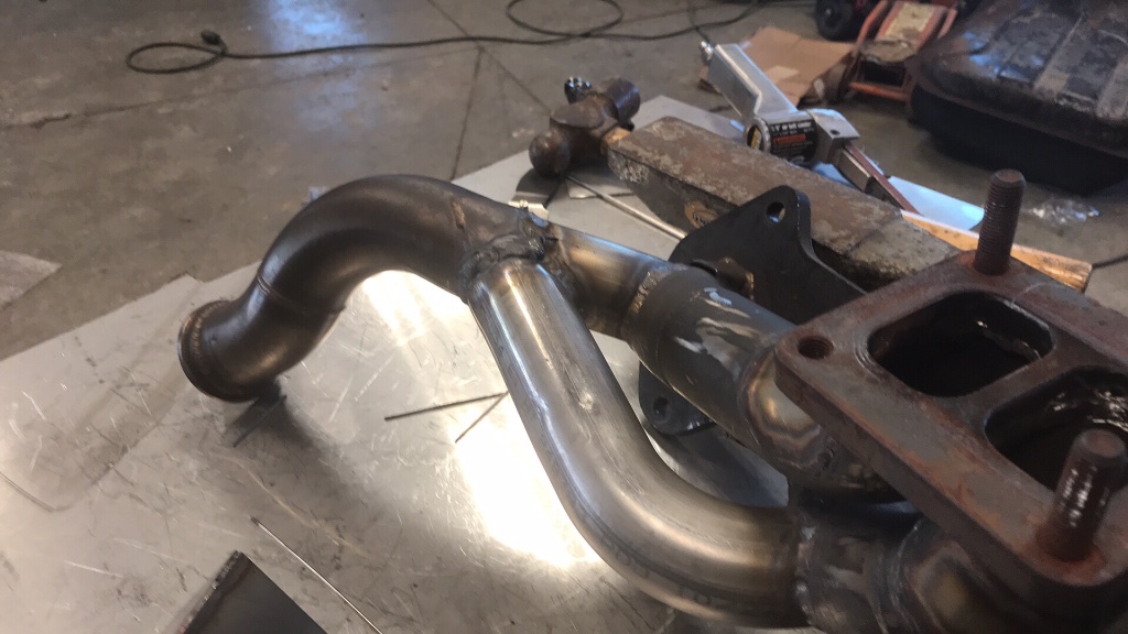

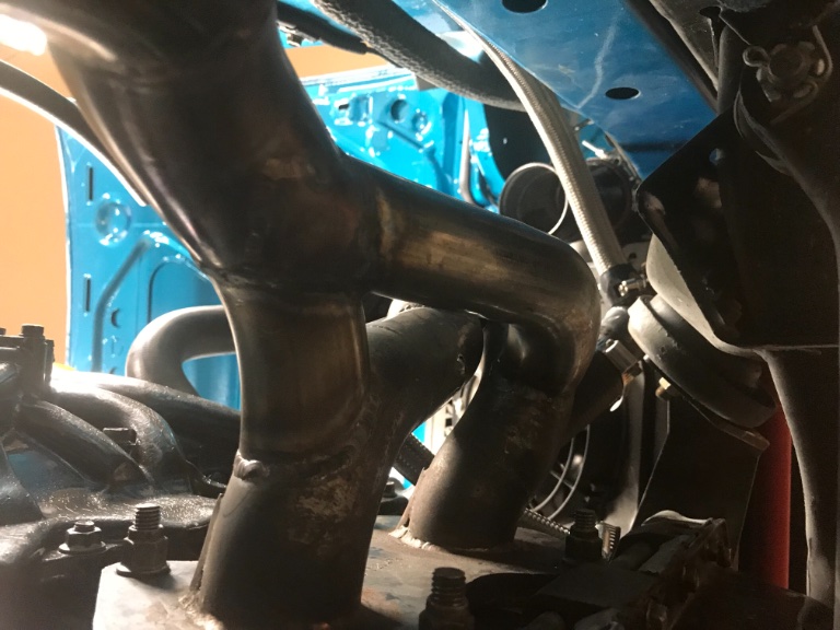

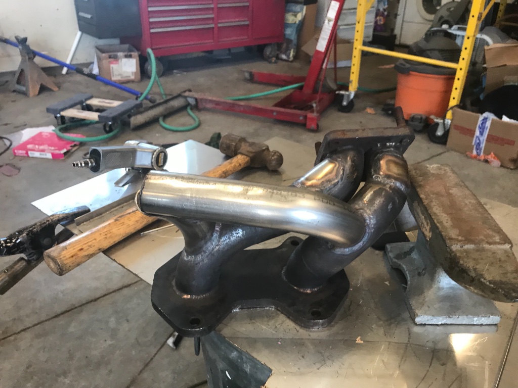

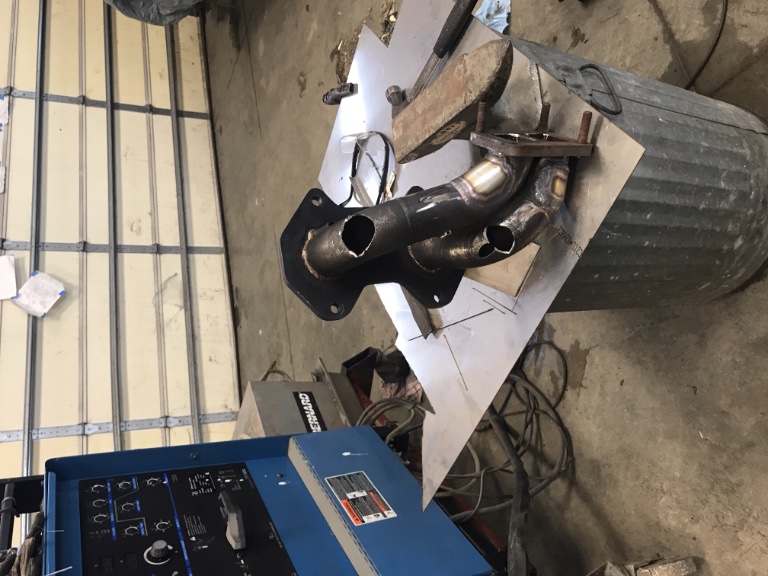

trying to get done for my first car show on June 14th... currently working on the exhaust manifold modifications - cut the existing wastegate pipes off and am repositioning them in a more direct flow with the exhaust ports to try to eliminate some boost creep we were getting on the last motor..
PIA.. hahaha

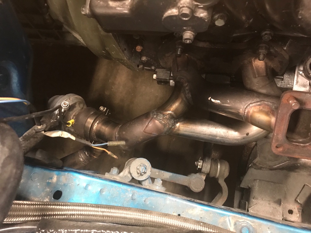

Got the exhaust manifold done and in.. everything I welded screwed the next thing in the line up... haha so pretty much redid the whole wastegate setup almost
