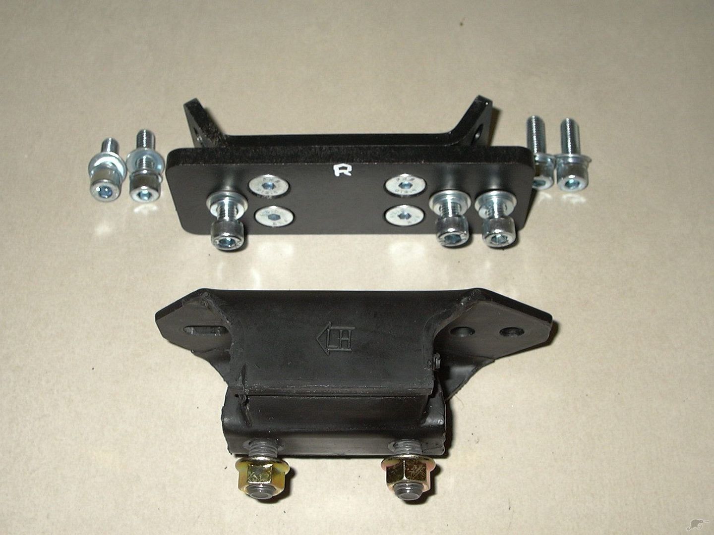

Got things bolted in! Keith sent me one of those transmission mount adapters for series 3 mounting bracket on a series 5 box. Bolted it on. But for some reason the shifter housing VERY slightly rests against the body of the car as seen in the picture below. Unsure why? I guess I'll have to space the transmission mount a few mm down. Any suggestions how? Would 1 or 2 washers on each side be a safe idea for nearly 400 wheel horsepower? Any other suggestions?

Have you used the S3 trans mount with it like this?

Yeah that's how I installed it aye!
Re: A Kiwis Series 3
I’d put a thick washer under the transmission crossmember where it bolts to the body... those bolts are very long and strong so shimming it a few mm won’t hurt. Your turbo looks very tight to the steering box Jesse, you could do with some heat shield between the two but that will make things even tighter... maybe slot the engine mounts and push the lump over a touch? At the moment any kick of the engine when you go on and off the power risks the turbo touching the steering box

Thanks for the help aye Ian! I'll put a few washers between as you mentioned and see how much spacing is needed. Some sort of heat shield is planned between turbo and steering box. But it's not on the priority list right this second :P . I'll see if I can tilt the engine with the slots currently on the engine bracket. I hadn't thought that far ahead yet so thanks again haha 0-0
