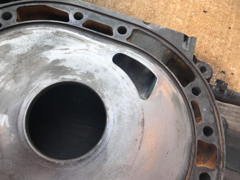

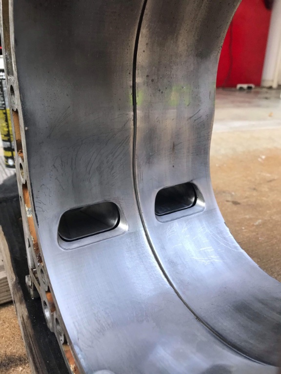

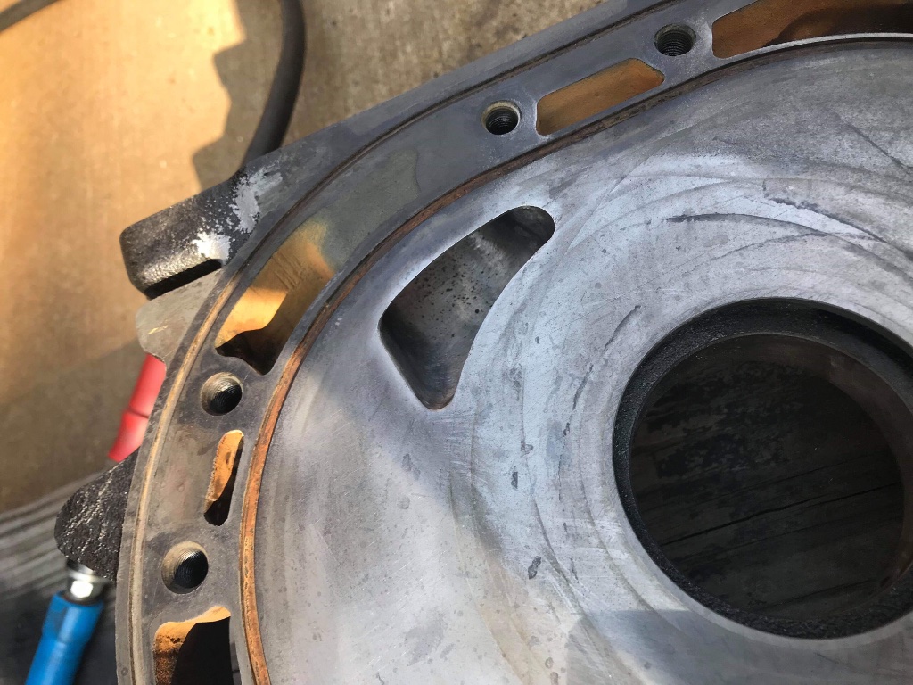

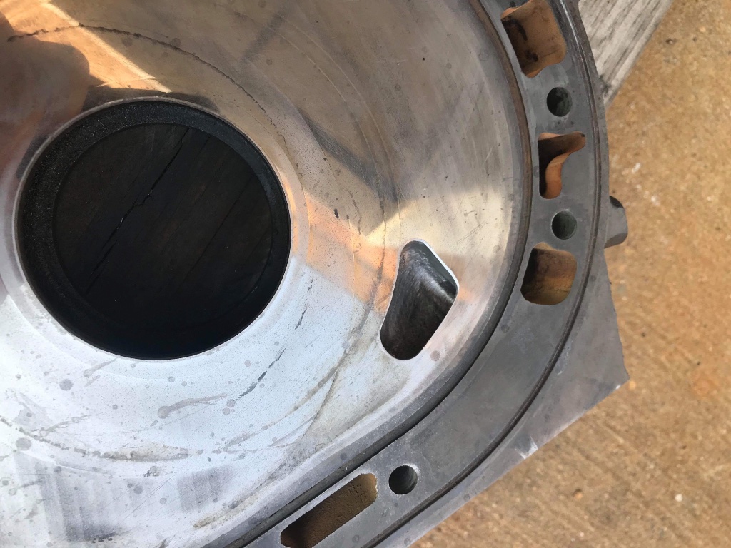

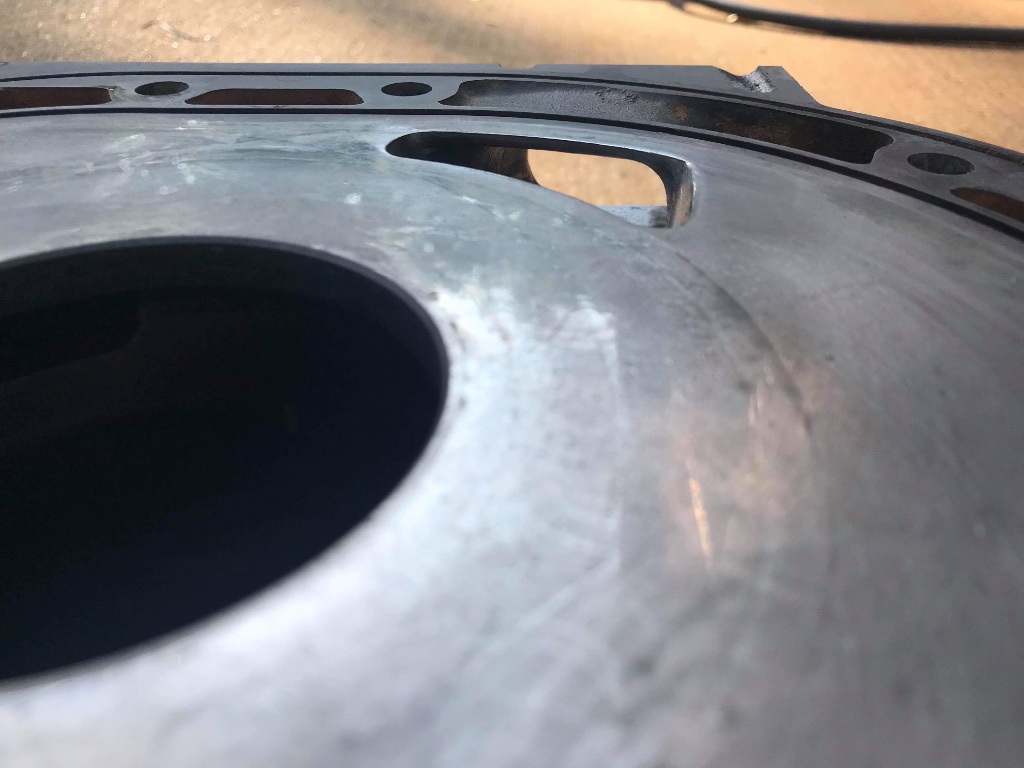

porting is done... nice clean up on factory ports, some mild opening up for a nice street port - nothing crazy.. some exhaust port porting with a special design and parts for the build ordered up... might be together and back in the car in a few weeks if all goes well.. though I need to finish my tank mods and some other custom stuff for meth injection etc...

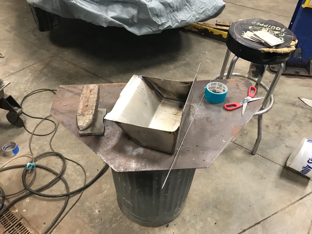

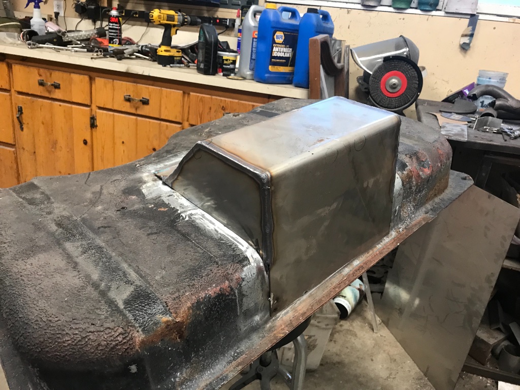

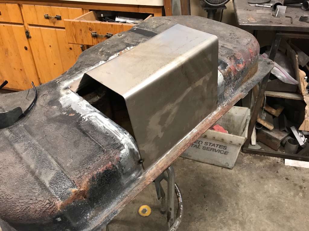

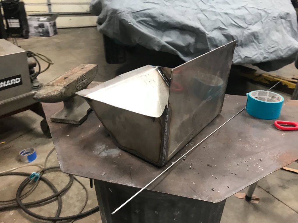

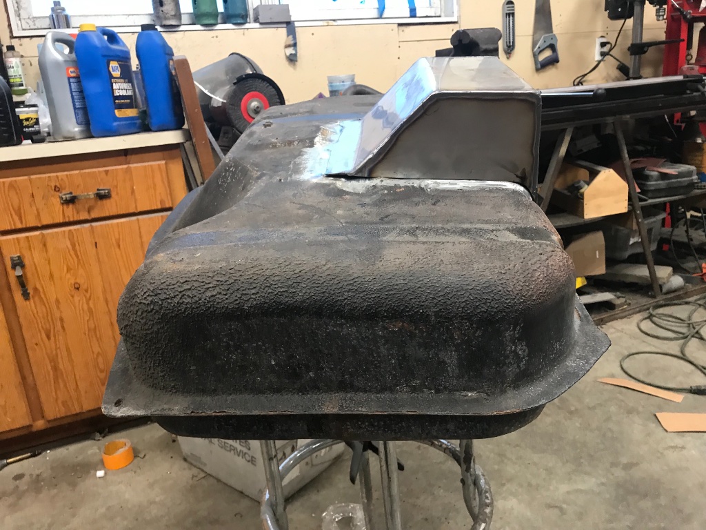

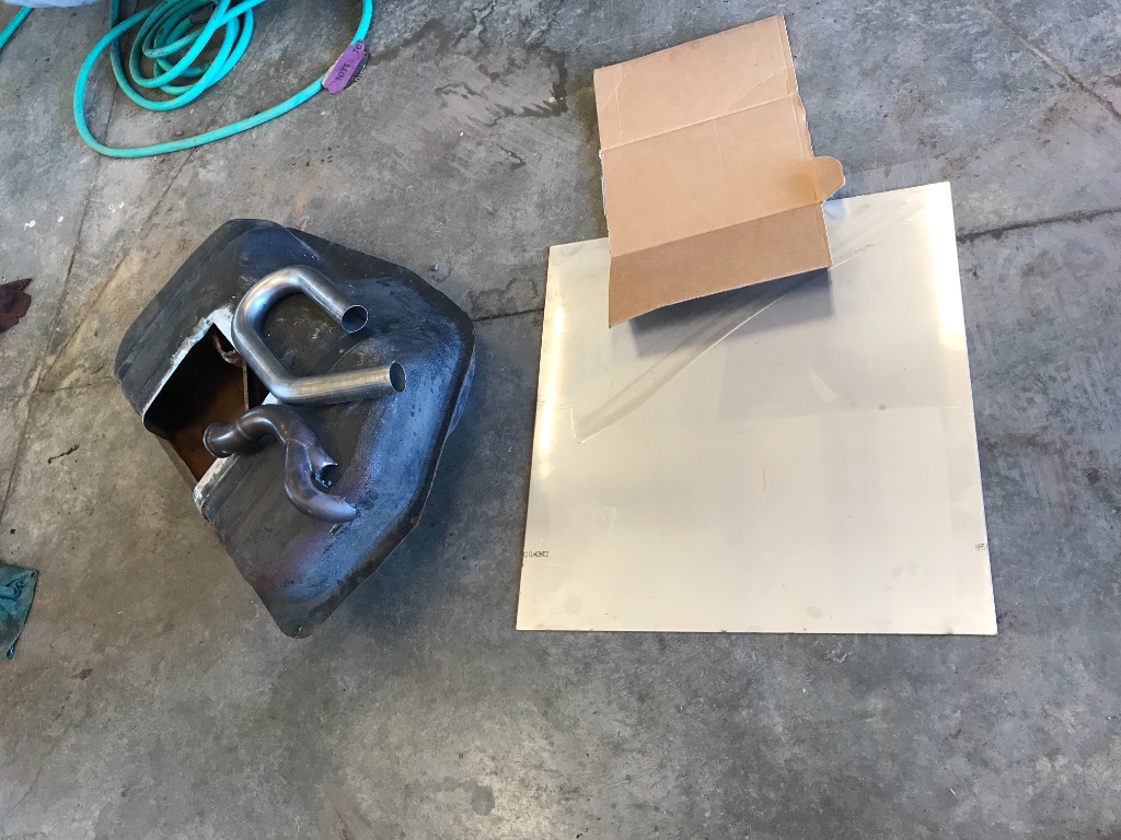

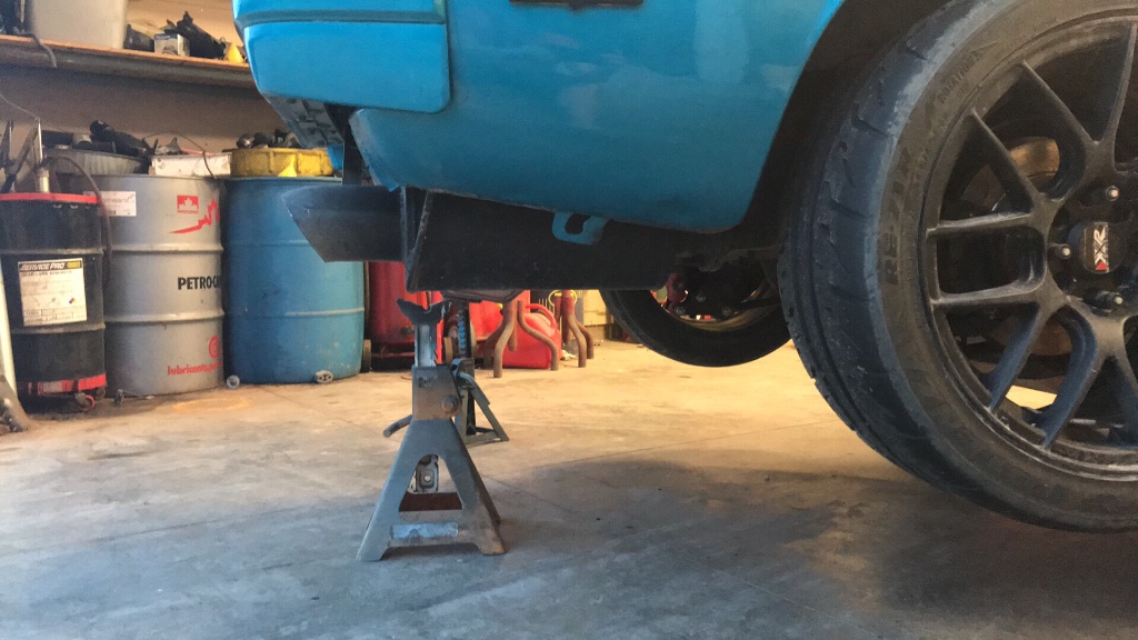

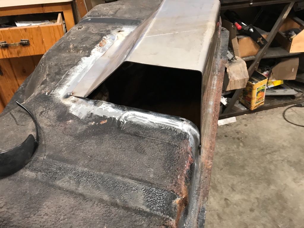

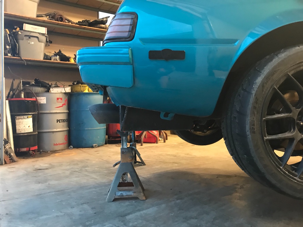

Doing some tank mods.. may have to modify my modification.. may hang a little low.. though its only just lower than the exhaust and still higher than the diff...!’

Re: 84GSLSE 13BREW Swap build
You forgot to centering your mod behind the number plate for better looking !
DWNUNDR
Posts: 256
Has thanked: 38 times
Been thanked: 46 times
Post by DWNUNDR »
actually theres more to having function than looks ;)
the only way to center it is to not center it on the tank... I went with a hole, a large one.. haha.. eventually it will be coated and black so wont stand out so much.. in the end.. its like saying.. hey that exhaust isnt centered.... um.. yeah.. hahaha
I can always weld on a dummy section to make it look centered.. maybe I will as tbh when I sat it there the first thing I noticed was.. aaaw shit it aint centered.. hahaha

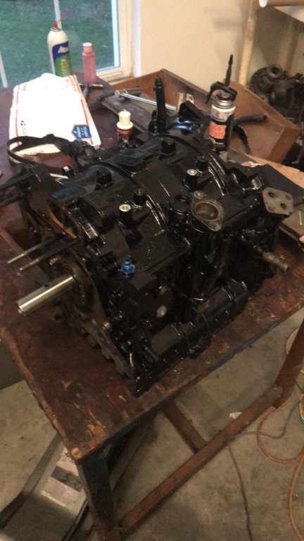

Also hope to have the motor finished this week.. the its another 27hr round trip..

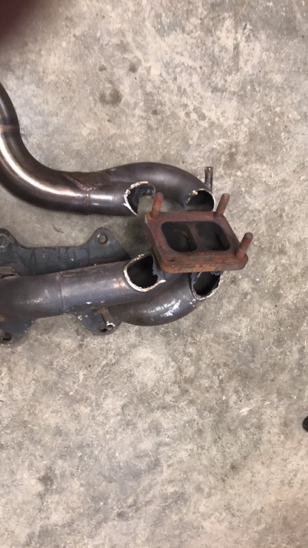

Some port pics.. nothing major on intakes just cleaned up and transitions smoothed, slight enlargement.. then a little work done to the exhaust port
Also modifying the exhaust manifold wastegate transitions
