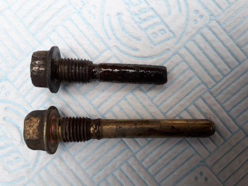

Brilliant - the Ebay used set of 4 bolts arrived today. The pair for the rear are nearly correct, just need shortening, a simple task.
Brake Slider Bolt.jpg (76.17 KiB) Viewed 3979 times
The front bolts aren't correct though. I haven't got a picture to hand, but the FB bolts have an unthreaded section of ~1cm behind the head, then a screw thread of ~1cm, then the slider part. I'll probably reassemble with the slightly bent pin I have for now and see how much it affects the smooth operation, while I try and find a source for a replacement.
I've had a quick look at 626 bolts and they don't look to be the same :(

This is the (bent!) slider bolt I've had to re-use. Luckily, the caliper still moves freely, probably because of compliance in the rubber boot, but I'd like to replace it sooner rather than later, if I can find a source!

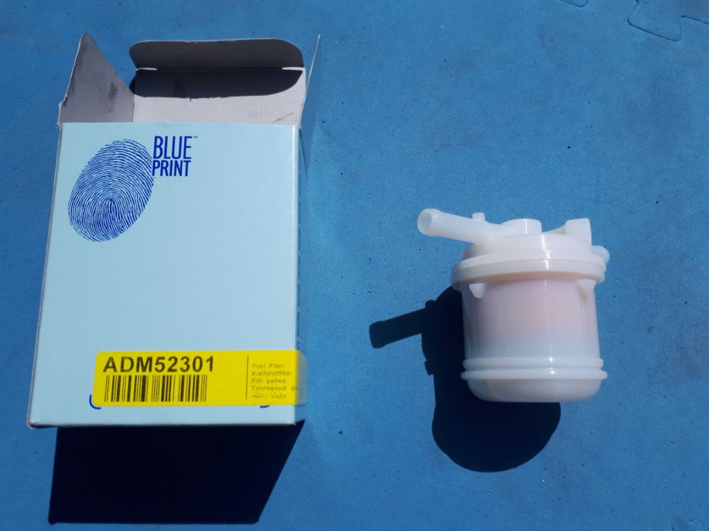

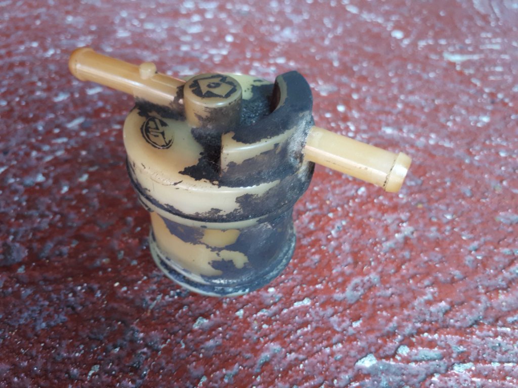

I offered to help my friend Ian, KIMI 2's new owner, sort out an issue he was suffering with the engine cutting out at 60mph+. Ian brought the car over to my place today so we have a look-see. We suspected the fuel filter to be the culprit as I have to admit, much to my shame, that I'd omitted to change it since I acquired KIMI 2 in 2015 :oops:
Sure enough, we did the fuel flow test, spec is 1.1 litre+ over 60 seconds, measured by pulling off the fuel hose into the carb. Well, a dribble came out and we measured only 50ml over 15 secs :shock: :thumbdown: , so pointing to the filter or, less likely, the pump.
I rang more than 12 local car factors trying to obtain the same shape filter off the shelf. 10 of them said, "we can get that in for you tomorrow", 2 said they might be able to get one in by early afternoon, so I decided to ask both of them to go ahead. One then called back to say, "sorry, it will be tomorrow", the other one, Wilco, called an hour later to say it had arrived and we could go to collect, cost £4.99 :thumbup:
Filter installed, tested for leaks (OK), then off for a test drive (fine) and re-check for leaks (OK).
All fine now, except the filter bowl remains stubbornly half full, with an air pocket above the fuel. We tried to remove the air by rotating/jiggling the filter, but it won't budge. From what I can tell, this is not a problem, and certainly didn't cause any issue on a 30 min test drive.
So, Ian and I are both set now to take our FB's down to Beaulieu next weekend :D
Ian has set up a new account on here, "Ian.M" and will hopefully start a new topic in due course to continue on the story of KIMI 2. When that starts, I'll link from here and lock this topic.
For future ref, here is the Blueprint filter and part number we managed to get same day. We were after the Mann WK42/14 branded part, but the Blueprint one looks to be well made.

Also pic of the filter that came off :shock: :oops: Tipping the fuel out revealed a lot of fine crud that had got in there from the fuel tank. Lesson learned, I'll aim to change that filter more regularly (I've changed the filter in KIMI 3 last week, even before I knew of Ian's issue with KIMI 2!)
