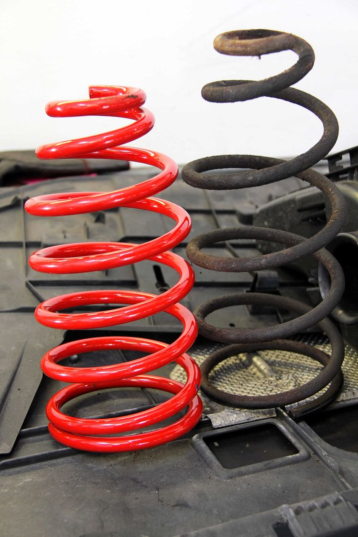

I finally got the shocks ordered in to go with the RB springs, so booked the car in at a mate's garage to get it all swapped over. I know that's wimping out, but I thought like this; a) I really don't fancy lying on my drive in the torrential rain the drought's been treating us to trying to drop the rear axle while the car's on stands. b) I've got a really bad back at the moment. c) I didn't want to get to the point where one nut won't undo/I break something/a stud's welded itself to a bush insert with rust and then I can neither finish getting it apart nor put it back together and I'm trapped with the thing blocking my drive/garage. d) did I mention my bad back? e) haven't got any spring compressors for the front. f) my back, you see...
Thank God I took it to the garage. Just through Sod's law, every nut, bolt and stud came apart easily
The rear went together nice and sweet;

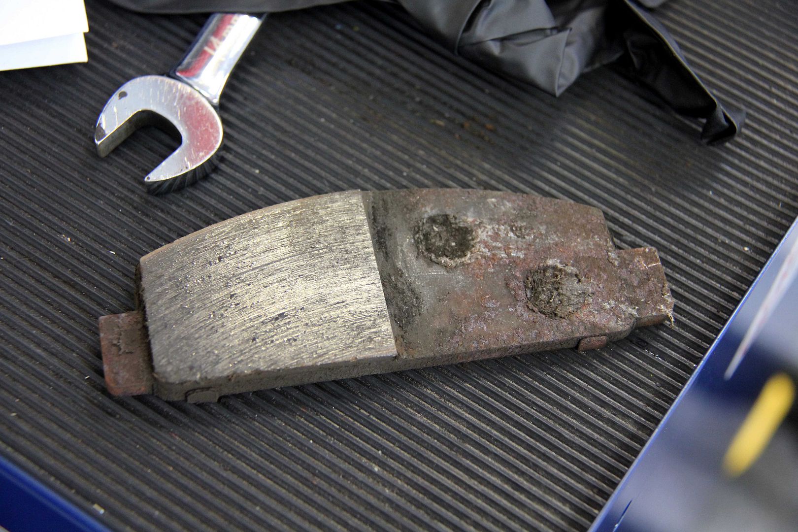

It was only when the guys got to the front it went Pete Tong. First thing they found was this;
Errrr, farrrrrrrrrrrrrk!
Where the smegging hell has the other half of my brake pad gone? Jeez, no wonder the brakes were inconsistent! Things got worse from there on in, though for comparison the springs at least look like they'll bang on do the job they're supposed to;

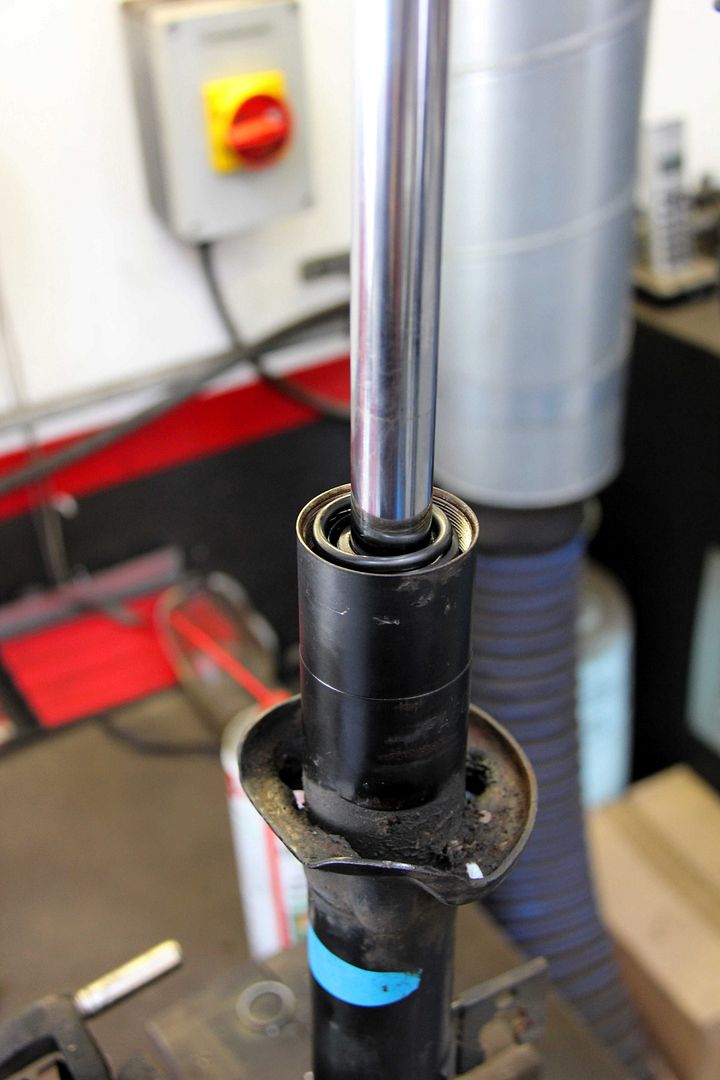

The ones I bought were cheapy ones, still KYB but now oil/gas, so essentially the same but slightly better. From here in fact: http://www.ebay.co.uk/itm/1x-KYB-G-Shoc ... 3844017095 So far, so ordinary. Except the top of the shock is completely different. The "instructions" appear to show a special spacer that sits between the shock body and the large bottom nut, but this spacer wasn't in the kit I was sent
First diagram there. Without the spacer, the shock sits about 5mm too low in the strut, and rattles around, even when the spring and top mount are added. So, the garage rang KYB Europe to ask about htis. They were basically told that a) KYB don't approve of third parties selling their product, especially not on eBay and b) if there was a problem, it was down to me as customer to chase up the eBay firm I bought from, who should then contact KYB who would dispatch the missing parts to them, so they could send them to me. Even after I offered to buy the spacers direct from KYB just to get the car together and off the ramp, they refused point-blank.
So, I contacted the eBay firm, who fortunately actually have a phone number. They were good as gold, got hold of KYB and got straight back to me... with a completely different version. Apparently, the shocks were correct and didn't need a spacer. Once they were done up tight with spring and top mount they'd be fine and no movement would be possible. Ooooooo-kay. Back to the garage.
No, That's bollocks. Still rattle about.
By now I was incandescent with rage, but the shop manager calmed me down and said he'd try ringing around and see if he could make sense of it all. Mazda Rivervale (remember them from my gasket buying tragedy?) were no use, they say that they treat all RX-7s as imports, even ones that were UKDM originally, and therefore don't have detailed part catalogues for them. Eventually we found a rather more tame (and useful) Mazda dealer up north and their parts guy did grudgingly say after much hassle that he could sell complete strut assemblies...£220 plus VAT per side, five days from Belgium
When quoted the original parts numbers from the strut and the OE shock...
...which quite clearly state that they're KYB manufacture, he was unable to match it. KYB claimed there was no such part number, and it must be a mistake. They list one similar but essentially two digits different, and were not willing to supply one for comparison. Basically, their entire attitude is that "you must have made a mistake, it can't possibly be our fault and we ain't helping". Meanwhile, every single motor factor we could ring came up with the same part number as the eBay version that I had, spacer not included.
So, after much timewasting talking to surly, miserable, rude, obnoxious people over the phone, Dave the mechanic came up with this;
Yep, a humble O-ring around the threaded bottom nut is enough to seat the shock perfectly in the strut and stop it rattling. How long it lasts is moot, but at least the car'll be driveable and we can see. It might be fine.

Hmmm i bought the same shocks for mine, albeit a different vendor. But did not have any issues?

I sympathise. I have a garage full of bits for a 1982 FB, which are supposed to be for an S2, but are in fact S3 parts..............seems it is difficult for the parts factors to tell the difference, even when they have a VIN number..........
I was thinking of KYB units for my car, i'll think again now....

Interesting, James. AFAIK the struts should be the same between S2 and S3 shouldn't they? Only the brakes changed? I accept that a random parts supplier can't be expected to know the minute differences between series like we enthusiasts come to, but in fact all the aftermarket people involved have been more than helpful... Despite KYBs utter lack of help, every place I could find that stock 1st gen KYB suspension have the same part number for them, so I think these are the correct shocks, and for some reason the y just don't locate properly inside my struts. I can almost see what they mean, it looks like they're desinged not to need the spacer but they're just slightly too small a diameter and need something to stop the shock moving inside the spur. Dunno. Probably never will, lol.
I don't so much mind getting stuff that doesn't fit/is plain wrong, but I certainly resent the living **** out of the attitude KYB adopted throughout. Completely despicable
Mazda Portslade haven't exactly covered themselves in glory... treat all UK models as imports
yeah, right, why not just say you can't be bothered to look the part number up? ****ers
