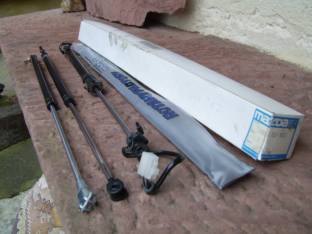

All over the years I take a lot of new parts from mazda but they doesn´t work if it is cold. The parts fom USA Rotaryfactory I got 2011 are fantastic. I buy two (left and right) but only need the left one for excellent working.
The left you see on the picture is Rotaryfactory made

Have you got a link on where to get those struts?
- Posts: 1895
- Has thanked: 476 times
- Been thanked: 253 times
I got it from an offer in the german rx7 forum:
