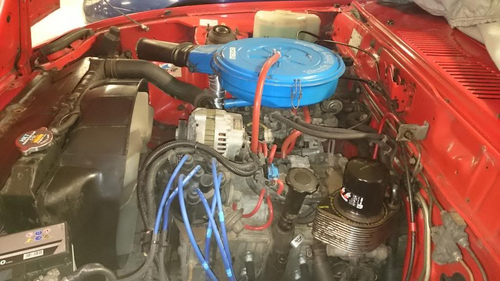

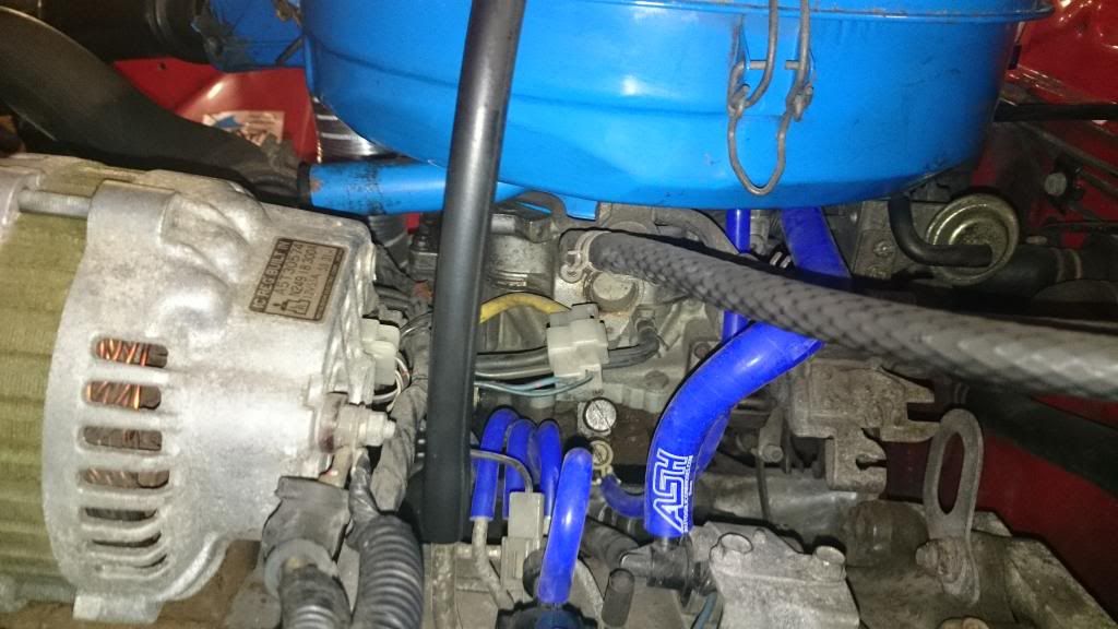

TWiR is entered in the London to Brighton Classic this Sunday. I've decided to leave the brake hoses well alone until after that's over. I had some silicon hoses of various sizes that weren't doing much so I've had a little play around ...
The blue option .. looks kinda ok but doesn't match the blue box of God so the contrast is effectively purple if the two are together (trust me on this one, whoever said photo's don't lie never had a cameraphone)

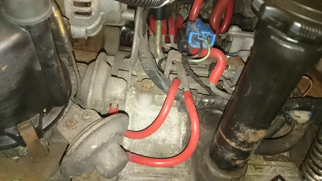

The red option ..
needs some red plug wire seperators to carry it off I think.

Anyway, discuss and comment away if you've nothing better to do
The red option ..
