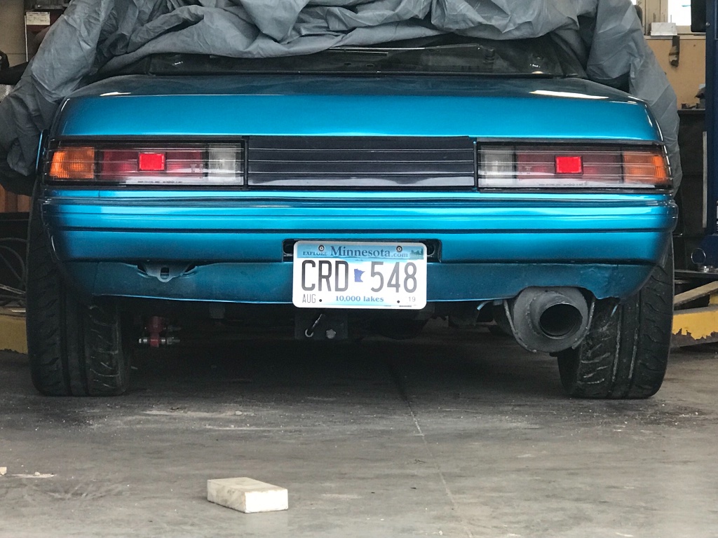

I modified my own tank
1st tank was a disaster haha
This one worked out and it sucks the tank bone dry.. so dry if I wanted I cant even fill a paint can lid with whats left.. so success.. itll never be driven that empty and will never starve for fuel.. i hope haha

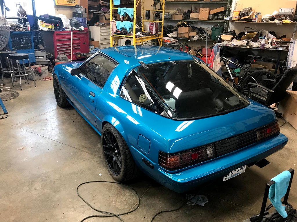

good thing is you can wet sand that down and lay over another light coat...
usually you try not to sand the paint bu cut the clear...
Looks clean though other than that... I love it when guys just send it themselves/with mates... anybody can pay big money for professional stuff (if they have the dough - aka most PAC cars - though amazing still not built by the owner)
my buddy painted mine with me in my garage.. I did bodywork (average haha) and helped paint etc... $600 it cost me
the difference was the clear and the buffing after.... put double what you thought on the clear.. youll thank me later haha
