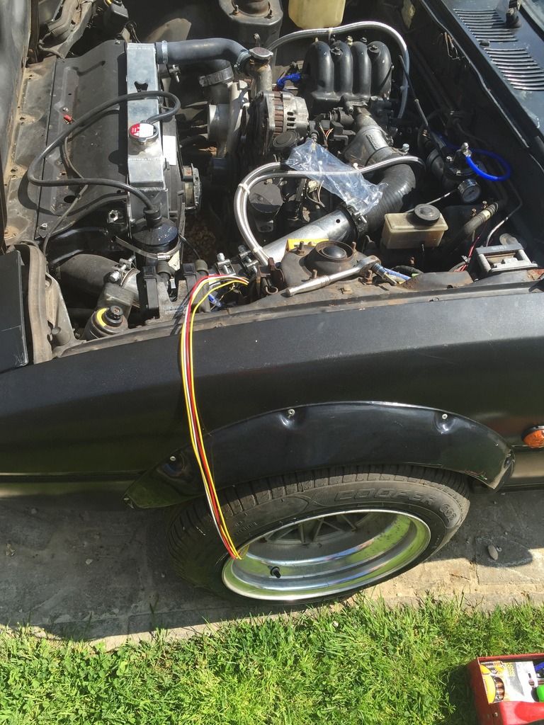

Got a couple of minutes to myself last week so fitted my new leads....
While I was on a roll I installed the HKS boost controller that had been sat on the microwave for a couple of months and was on the brink of being filed under B for bin by the wife. So the stepper motor needs a boost/vacuum reference point intercooler side of the throttle body and inlet manifold side. Manifold was easy, straight off one of the six trillion vacuum nozzles around that area - the other one not so straightforward. Unfortunately my turbo is devoid of any waste gate nozzles and the like so I drilled, tapped and sealed a nozzle into the first hard pipe available south of the blower.
Dern.
Stepper motor was easy, mounted to the firewall with nice short routes to its destinations, the vital one being the waste gate sat far just yonder.
And with a bit of wiring we had light.
Running out of reasons not to throw it at a rolling road now.
Splendid.

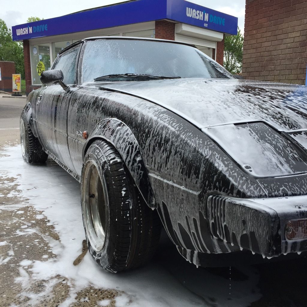

Ahem....um yeah so where were we? Oh yeah I've been playing with VW's.
My conscience got the better of me today and I went and retrieved the old girl. Tim had sorted the somewhat hit and miss starting situations which turned out to be a fuel trim setting a bit squiffy and now considering is still on a rough map starts okay whatever the temperature. With that sorted I went and did the honourable thing and give her a wash. Picture to prove it - probably first clean in two years.
My bad.
