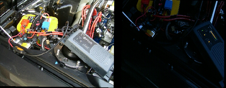

Jesse your red top optima battery need a charging voltage from about 14,4 V for a full load up.
The battery is not a wet type it is a AGM type battery. The battery is now far away from your alternator so you lost some voltage level. Do you have ever measured the charging voltage with working engine?
There is a possibility for a full charging with an extern charger like Cetek or Truma BC 10 with a special quicker charge for the optima AGM battery and control panel show you how full your battery is.
Re: A Kiwis Series 3
Thanks for that post Thomas! I did check the voltage when I got it all running and I believe it was spot on! :D The car is in bits again though while I sort the welding out so the battery is in my bedroom :lol:. I would like to get one of those Ctek chargers though.

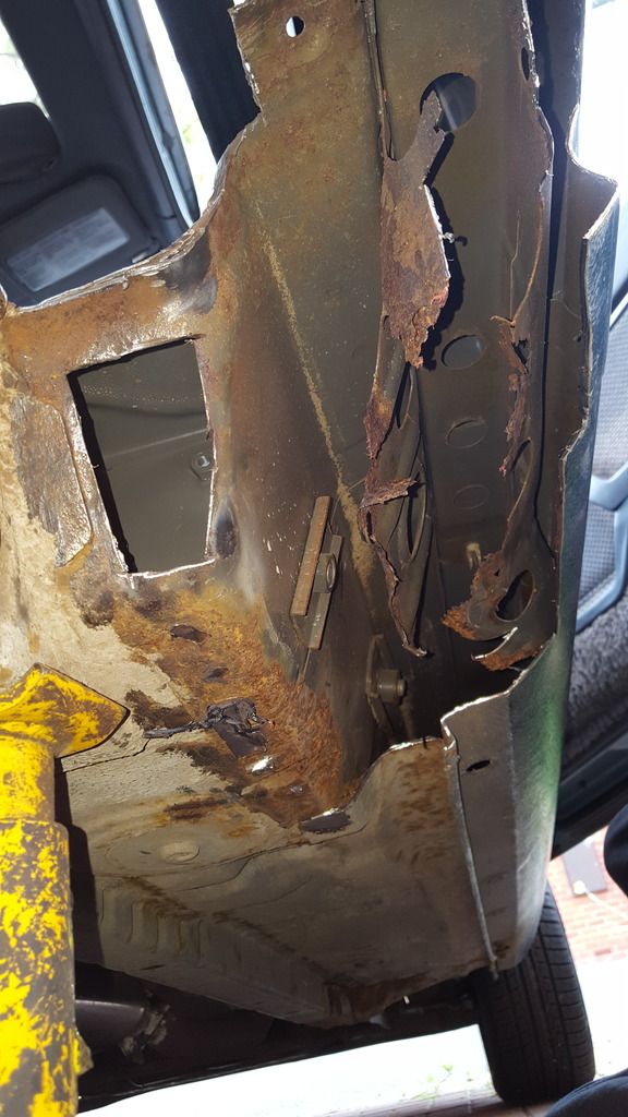

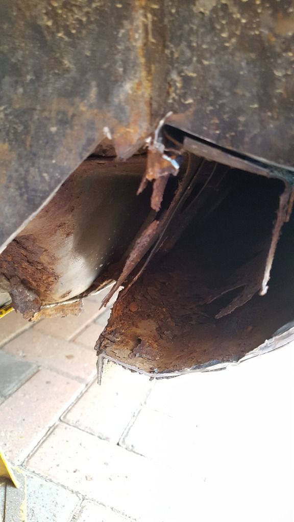

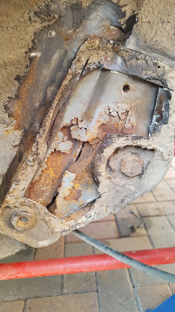

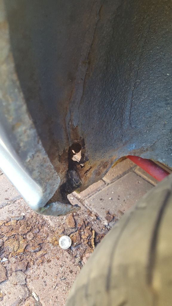

I attacked my sills and arches with a screwdriver last week after failing my MOT. Thankfully these pieces aren't visible so don't need to be perfectly straight and pretty! :lol: I've got 2 outer repair panels coming from Steve who people have linked to on this forum before.
Passengers sill.A lot of that is just loose flaked off bits of rust There's some more underneath the rear seats in a weird spot which I need to figure out too.
Driver side is a little worse :cry:. Discovered a bodge patch over the suspension mounting plate also.. At least I've done the other side and it shouldn't be too hard this time.

It seems like you are working in a logical way, by the time you have finished you will be welding as a sideline, the more you do the easier it becomes. It might be a good idea to drill a small hole in all the areas you will have attacked with heat to spray some old diesel engine oil inside as that will stop them rusting from inside. It will be worth it.

Making slow progress. I kept having days off that were rubbish weather. At least I'm learning about what to cut out and what to leave! :lol: It will help the other side go quicker. Got most of the drivers side rust out. I'll bang up some quick panels and try get them welded in. I really want to make this Mazda HQ event in May. Not sure if I'll be done in time :( I may even just weld it up to pass MOT, then chop it back out to finish it properly, just to make it?! :o

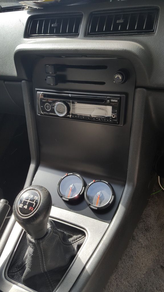

I had my Defi oil temperature gauge mounted in the supplied sticky backed pod which wasn't bad. But I really want to have a clean setup :lol:. I decided to make my own gauge panel. I don't use the clock, cubby hole or ash tray in the standard panel so figured I could delete them. I have the rear defrost and headlight switches behind the panel as they hardly get used and I'll just reach around( :? ) if I ever need to use them :lol: . There are a few imperfections from where the vice grips clamped on a slight uneven surface and dug in through my rag, but it's allgood. Overall I'm stoked as and the gauges are very easy to read on that angle. Could do with some stickers or something for the heater controls :roll:. I have also left room for another gauge but unsure what will go in there at the moment. There's also room for an EWP controller at some point I think :) . Not bad for about £5 aye (including paint) ;)

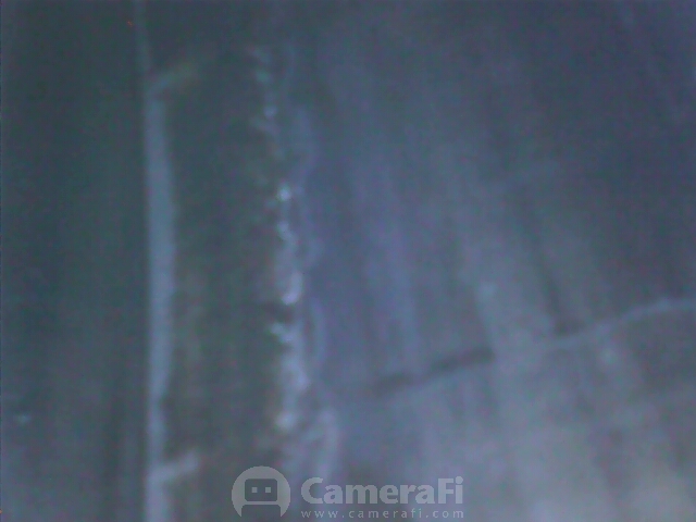

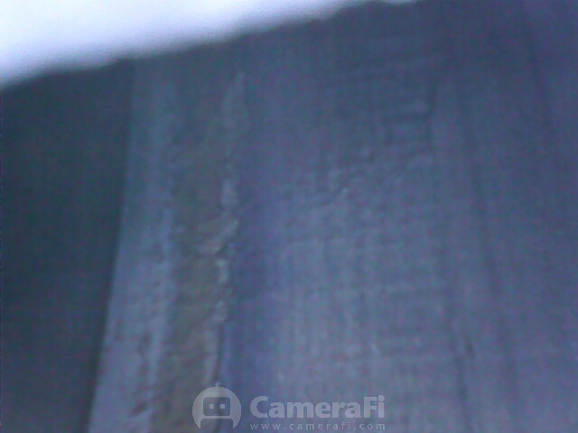

I got a little borescope off ebay which plugs into my phone as I though it'd be a good idea for various things. Cost about £6.50. Decided to have a look inside my engine. This is through the spark plug holes (barely fit!)
Rear housing
Front housing
Chrome peel/flaking by the looks of it. Glad I've saved up a nice amount for a new engine :lol: . Just hope this one lasts me until I can sort one out! Ha
