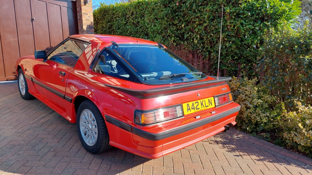

Sadly, KIMI 3 has been sitting in the garage for longer than I would have liked. So, with it being a lovely sunny day today I took her out for a run.
All good**, but I needed some Easystart to get her going.
I'm looking forward to the better weather now to get her out and about.
**all good, apart from the driver's window doesn't operate :( . I suspect the usual culprit, dirty switch contacts. I'll add that to my "to do" list ;)

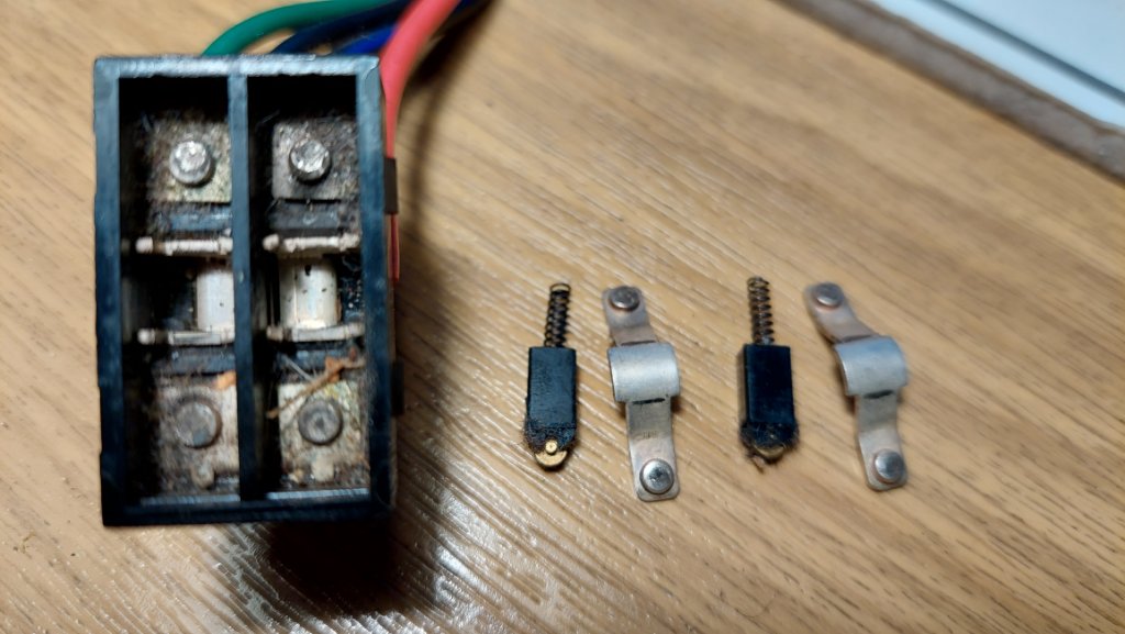

Yep, the common issue of the electric window failing has happened to my driver's side.
Here is the condition of the switch innards:
They'll need a good clean up to remove over 30 years of grime! I can see a few cotton buds being sacrificed here, along with with lashings of isopropyl alcohol :D
I've also ordered some 30/40 amp SPDT relays to hopefully install in circuit to take the full load off the switch contacts - which are well gummed up with carbon when viewed with a magnifying glass. I think there is juuuuust room to install the 4 relays needed to convert both switches, inside the console area. It might be a bit tight though!
If it works, I'll take some photos along the way and post up details when done. I should be able to create a new loom, using the existing switch and plug, plus the two relays, to make it a "plug and play" install into the existing the 4 pin console wiring socket. That way, everything is easily reversed, should there be a need!
Once I've installed the window side, I'll see if there is room to tuck in 2 more relays to convert the passenger side.

ian65 wrote: Fri Apr 15, 2022 8:19 pm Jesse did an awesome job of putting relays on his window switches a while back..... well worth taking a look at his thread..... I'm going to do it to mine too at some stage.
I had forgotten Jesse had done a write-up on this :thumbup: (re-)found it here: http://www.rx7fb.com/viewtopic.php?p=47776
My relays and bases have arrived, so plan to do something very similar. I haven't decided where to put the relays yet, but the suggestions made by Jesse are very helpful, as there is not enough room for 4 relays under the console where the switches are positioned.

Window switch conversion to relays now completed. Posted my approach to positioning the relays over here: http://www.rx7fb.com/viewtopic.php?f=22 ... 363#p49363

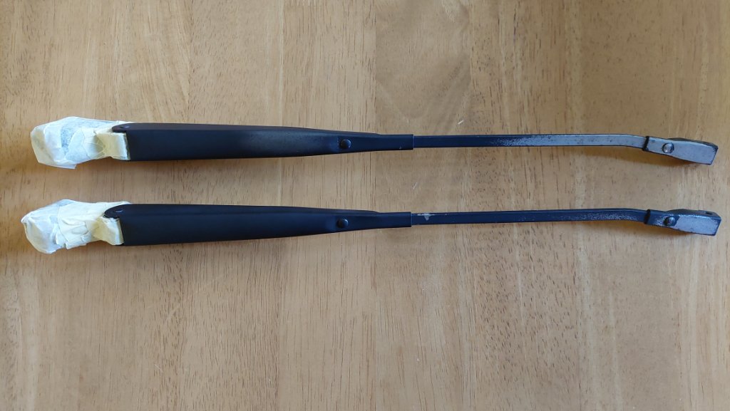

A bit of cosmetic work to do - the windscreen wipers are looking very tired - removed and masked up to spray paint, but too windy today to complete that job.
Meantime I posted up here: viewtopic.php?f=19&t=620&p=6397
- a source for replacement wiper rubbers at a very reasonable cost.
I had a sample of "bak2blak" stuff lying around. The rubbers around the windscreen wiper drive shafts was looking very grey and tired, so I gave it a try. I have to say it worked wonders, so I also used it on my side mirror plastics too, equally impressive result. Time will tell how long the effect lasts!
https://www.aaronchemicals.co.uk/produc ... :1877691:0
