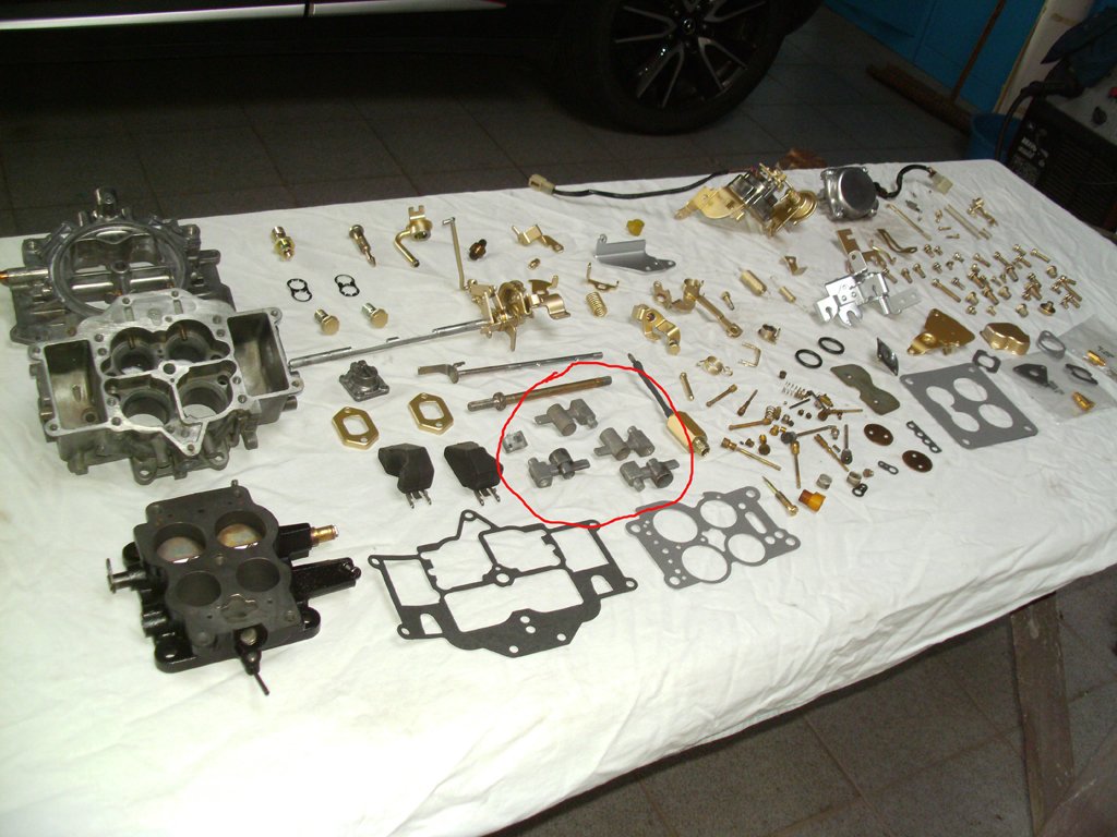

I've got my spare Nikki carb in a similar dismantled state and an in process of cleaning everything up - what a job that is!
Danny (or anyone else that knows!) how do these "venturi" (or whatever they are called come off? I have removed the jets, but the ringed parts seem attached in a way I can't fathom. Are there screws buried deep in where the jets came out or am I missing something?
PICT1802 marked 1024.jpg (166.46 KiB) Viewed 3921 times

Hi Casey, these parts can just pop-out. Some WD40 aroud them and a wiggle will do the trick. They can be a little corroded and therefor stuck in the body. Don't try to force them too much.
