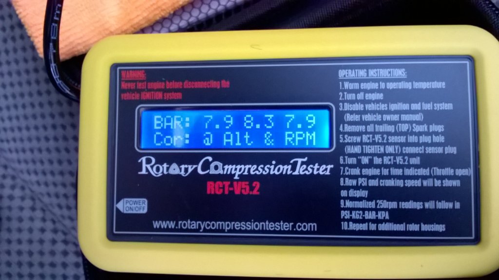

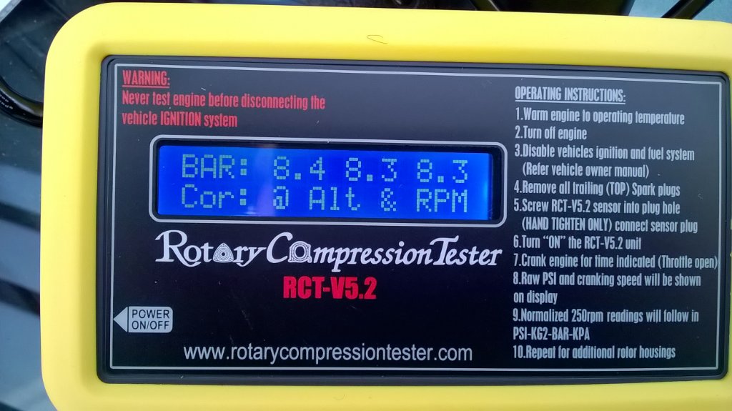

I finally got round to using my new toy (made myself finish Attic conversion first) the Compression Tester :D
I did the FB today, very easy to use, took longer to find the Fuel Pump fuse than to test.
Front
Rear

Nice Toy Pete - a few RX-8 guys use that tester.
Those are fantastic looking results yay
Awesome as bro!
biznatch

Great numbers by the looks of it 💪
Pete you know how to hold a rotary healthy. th: Any results of the FC?
