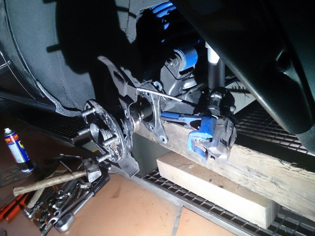

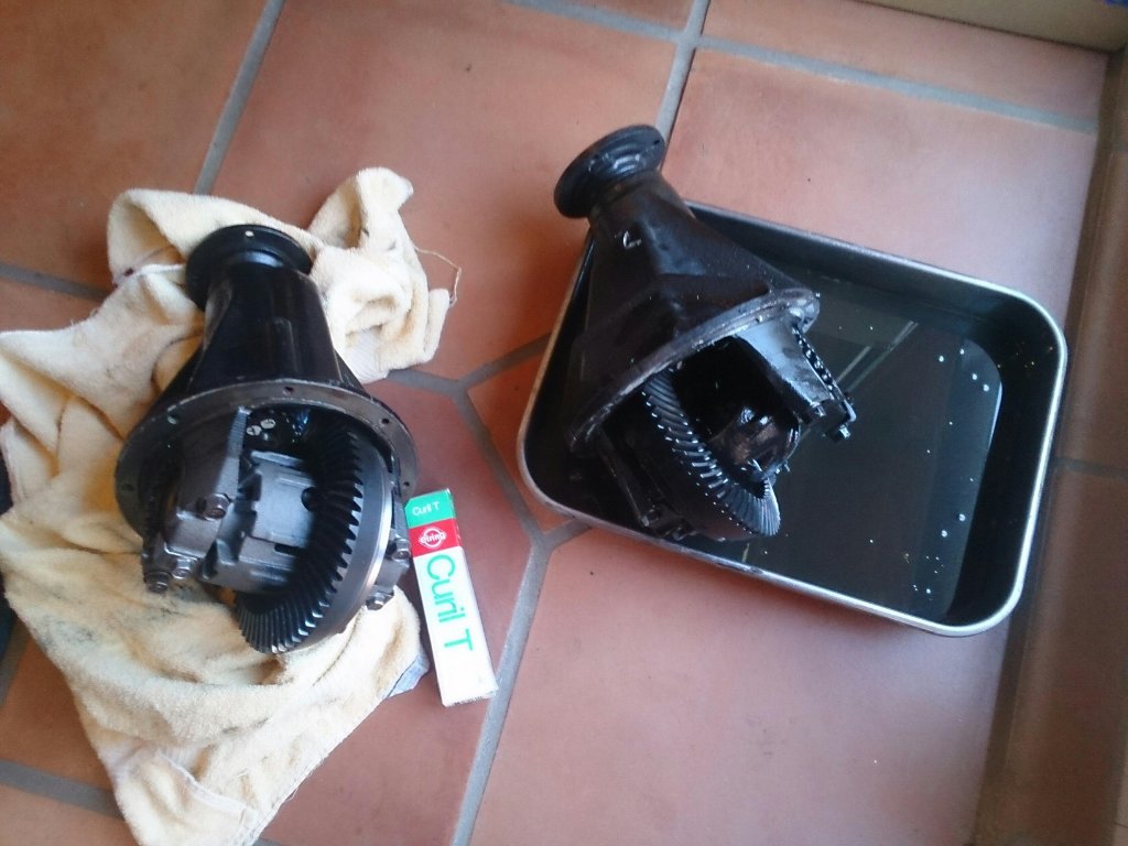

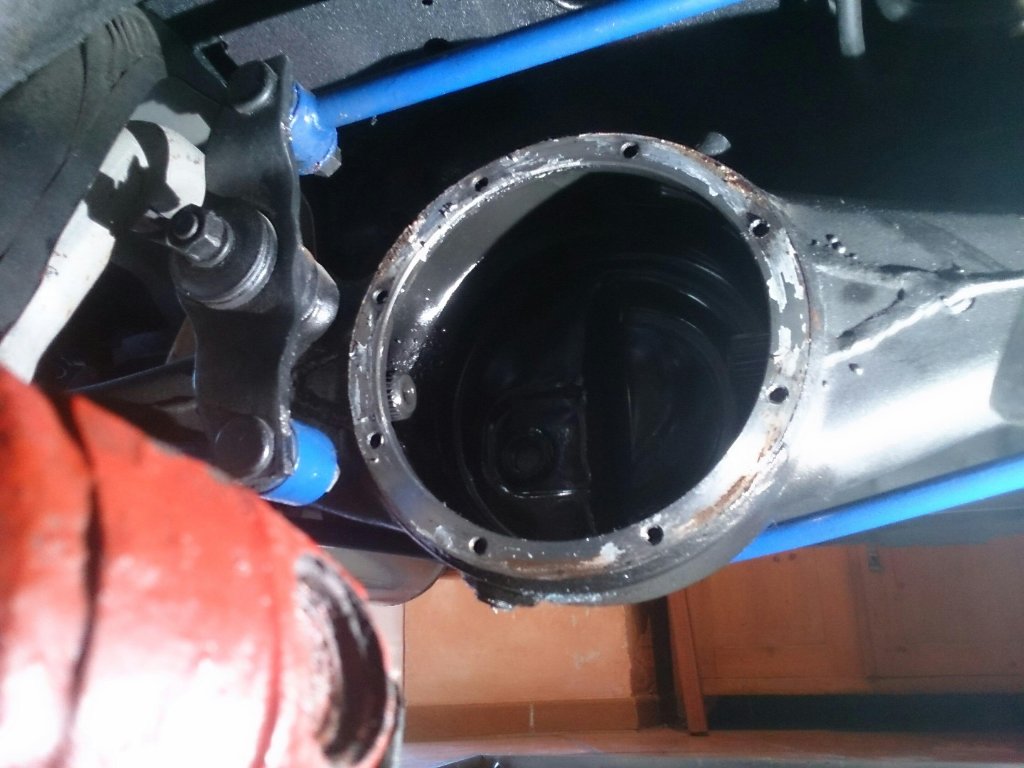

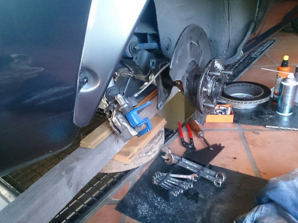

Back from test drive the new torsen 2 diff. Roundabouts are my friends now. :lol: :lol: :lol:
Change the diff without open the brake system isn't a problem. I have also take another oel from Motul 75W140W instead 75W 90W. Curil T from elring sealing the diff and axle flacing sure.
