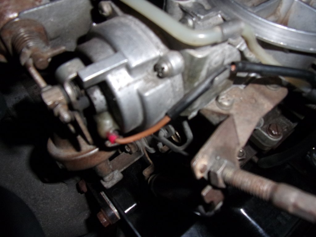

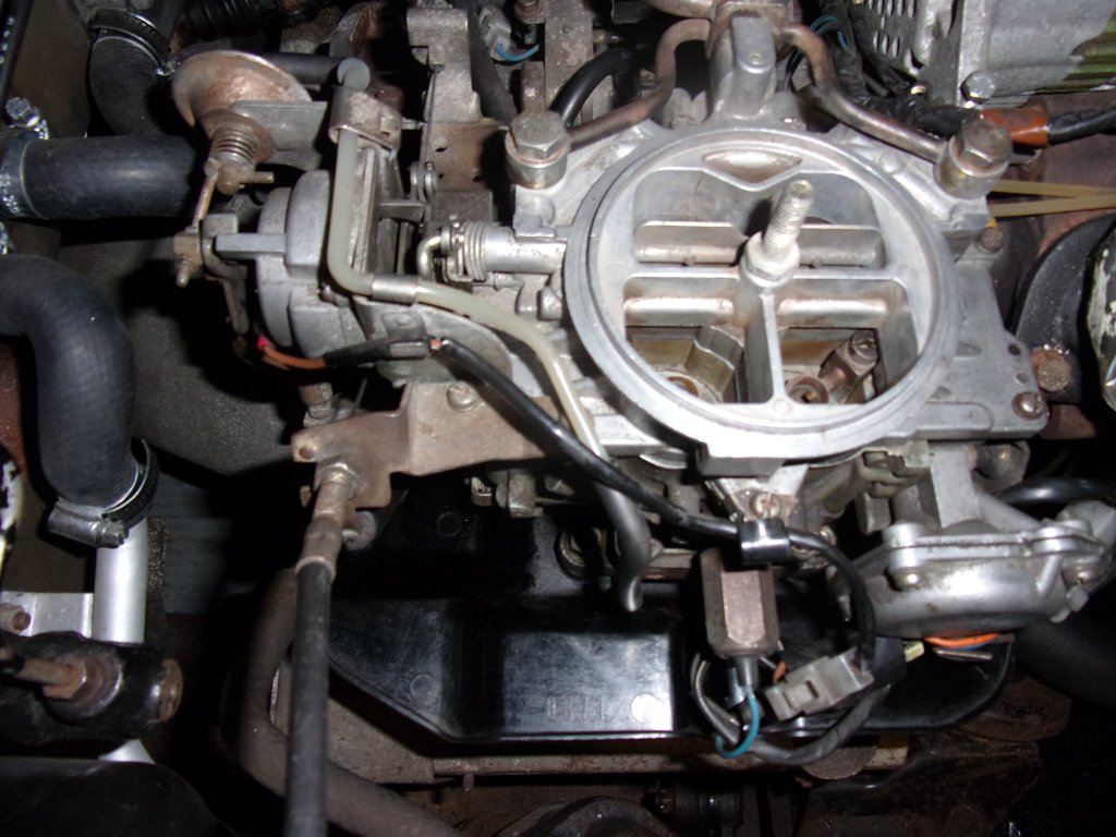

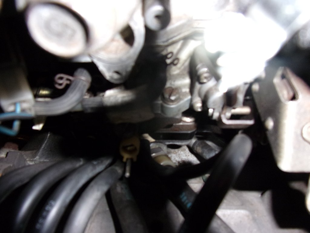

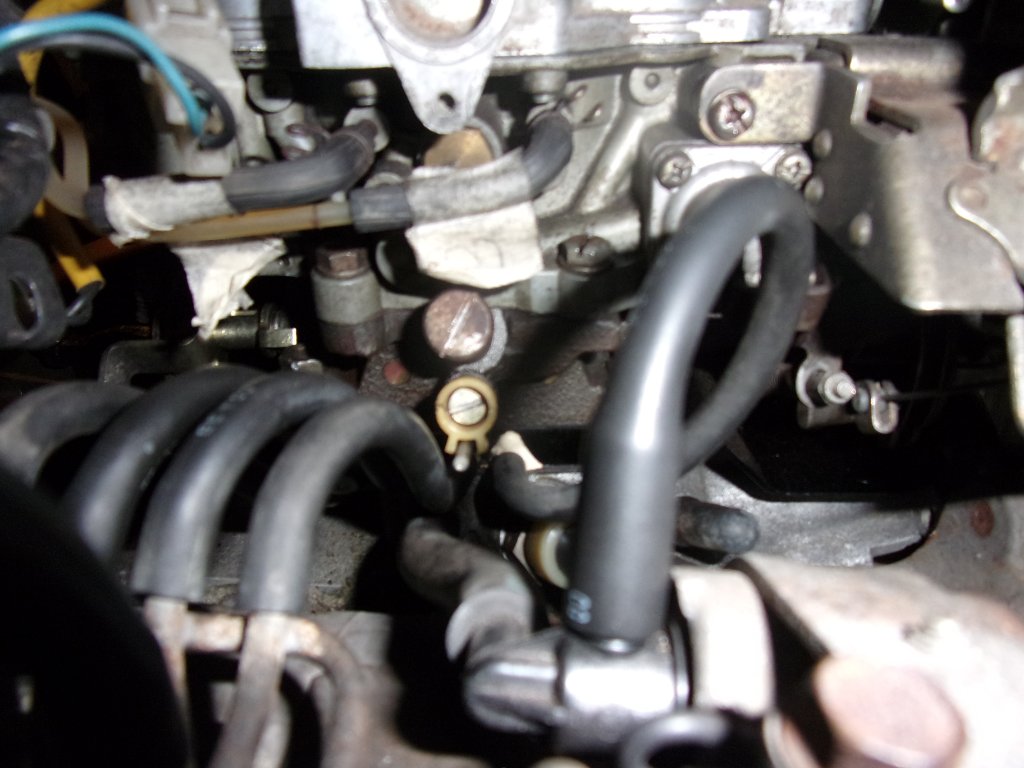

Could you post a picture of the Carb together with the Vacuum hoses etc

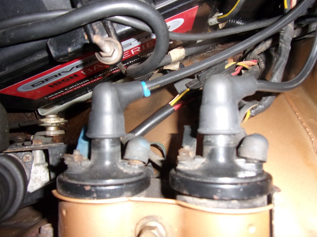

What coils are fitted?

Coils......likely original, most of the car is!
I was starting to wonder if a coil may be playing up....when being run in workshop the engine does slightly vibrate like a misfire perhaps...not being expert on rotary I am not sure how it would be. I have video's the car running, its on FB!

pictures of carb/vacuum hoses and rear of manifold which is blanked off.

What coils should I fit as replacements? for relatively little outlay it would replace the originals.
