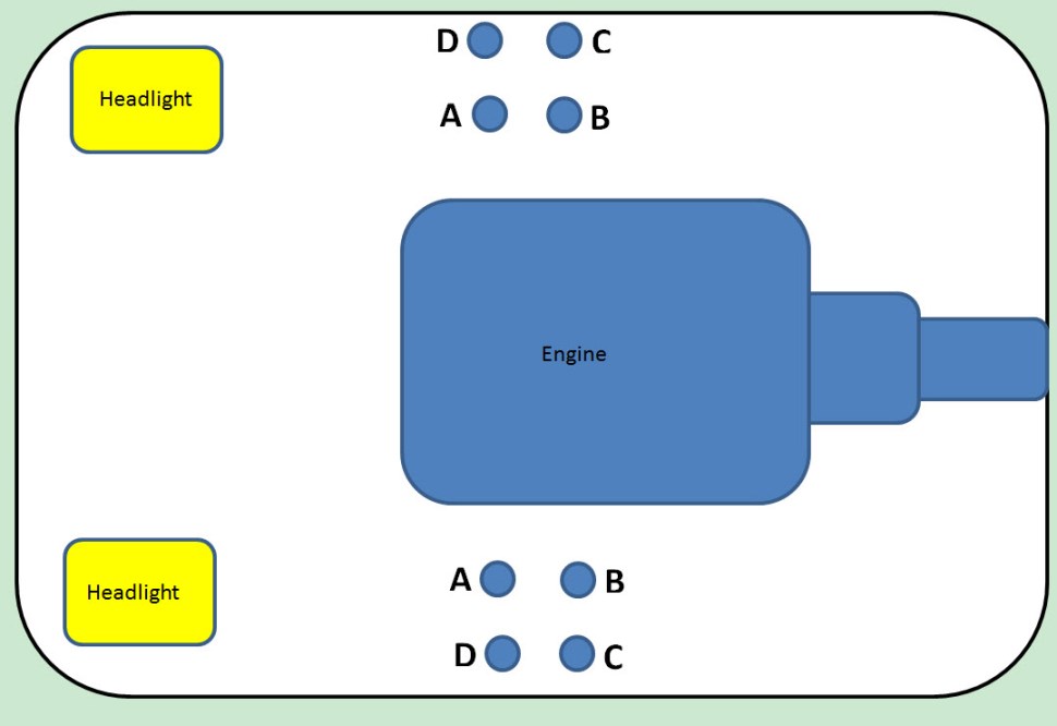

mine was in position B on passengers side.(showing a zero camber)
and in position D on drivers side (showing obvious +camber)
which i rotated 180degrees to the B position.
both front wheels showing a zero camber now.
cant wait for next time off to play around with toe

So dumb question - is the other side (drivers in the UK) the mirror of this diagram?
I am now worried that mine are pointing to different letters ...my UK passenger side points to D (forwards and away from engine) but the drivers side points to B (backwards and towards engine), so 180 from each other.....was like that when i got the car, someone even marked the paint to those positions when they change the struts way back when....

B is always back towards centre firewall on either strut.

So just to clarify, the lettering is as per the attached picture?
If so then I should be making sure that both sides point to the same direction, by the sounds of things both to B or both to A. Wonder how mine ended up one at B the other at D??
I guess i will rotate the one at position D to position B
Thanks guys, Tom

If you want them to be as per Stock, they need to be pointing at A (Engine FWD) according to your above diagram.

OK, thank you, funny how neither one points that way....I guess you really never know what previous owners or other mechanics have done beofre you get a car!DKWW2000 wrote:If you want them to be as per Stock, they need to be pointing at A (Engine FWD) according to your above diagram.

They may have taken them off for whatever reason to work on brakes etc & then put them back not realising the little marks existed

I will be rotating them both to position A, I trust your knowledge more then the previous owners!
