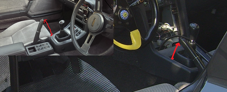

Threesevens wrote:Hi Spirit, I really appreciate your comments but I am not sure why you are suggesting I need to check my rear pads. What do i need to check. Thanks Kev
You can see the different hand brake lever position. Left side is your picture. It show me the possibility your brake pads are worn out. Check the thickness of all four pads.

If pads are OK:-
Check the handbrake adjuster......in the handbrake handle.....accessed via a little side screw holding the cover....just made for dropping down the tunnel carpet every time!!!!
Once opened up just tighten the adjuster to give 5 click on the ratchet from 'off' to 'full on'.
Simple job but requires doing regularly as pads wear down.

Thanks for the advice on the brakes. i am sure the pads are ok because they were all checked out when I first got the car. I have only done 1000 miles since then so it is almost certainly the handbrake adjustment that is needed.
When I get the car back I will have a go at it but might comeback to you so I am sure I know what I am doing.
