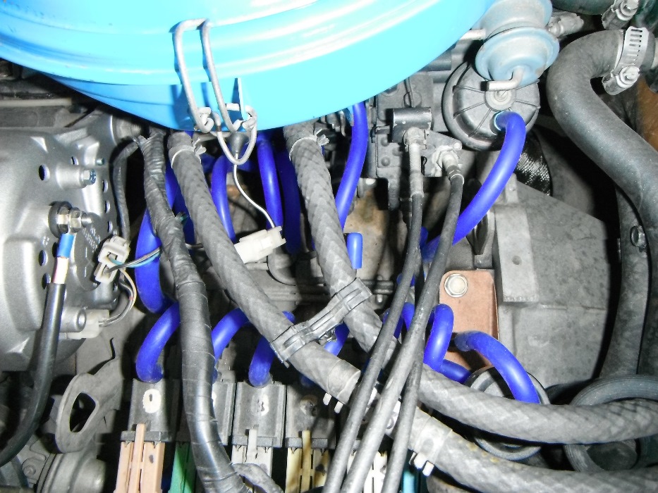

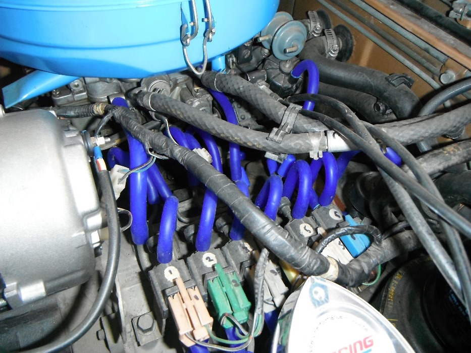

Hello All,
So the new vacuum hoses arrived and after some "car yoga" I managed to install them.

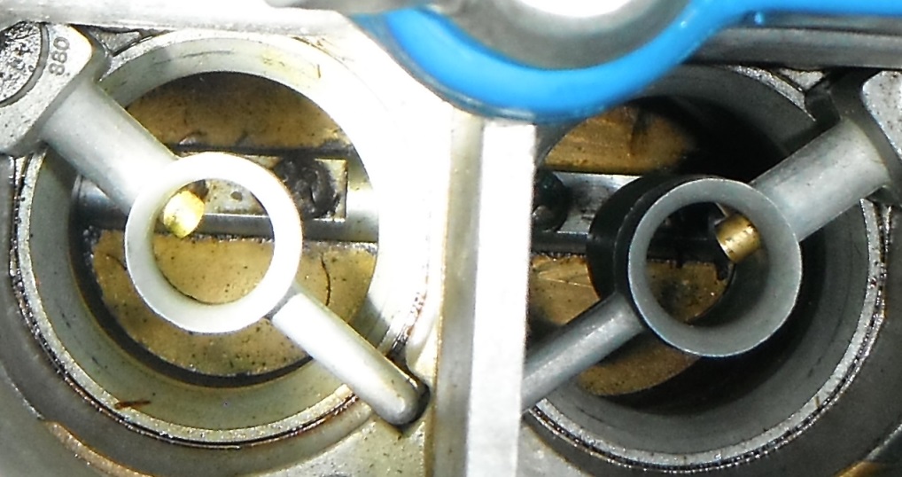

So my next train of thought was to see if the throttle plates are sticking open, which would cause the idle to be high, right? So i had a look down the barrels and noticed that the primaries are squeaky clean and only open a hair when the engine is running (which the should be so it runs right?). The secondaries however are not as clean, i even found a dead fly in there......i removed the fly and took the following picture:

So i was wondering if this level of dirt would be enough to make the secondaries stick open and cause my high idle?
However, if this is the case - if i adjust the mixture screw to the right (in, clockwise) which is leaner (i think!) then one would expect the car to stall? However this does not happen.....I turned the screw in until it stopped and the motor did not die.
So I checked the float levels, front a rear both seem ok (halfway up the glass).
The previous owner removed a lot of emissions stuff, which I am still trying to understand. One of them was the shutter valve, no vacuum hoses go here, i am ASSUMING that they set it to be permanently open.
So now I am wondering where to look next? The previous owner said they rebuilt the carb, but should i be pulling and rebuilding? Or are there other avenues i should check first?

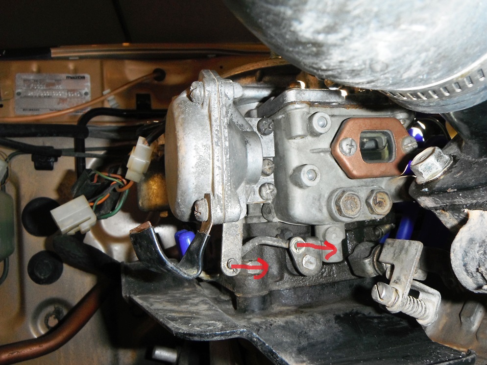

So I decided to check the accelerator pump to cross that off the list.
I took its cover off and the membrane looked like new (which makes sense if the previous owner did a rebuild).
I then wanted to check that its "pumping" properly. I read that you can manually activate it when the engine is off to see the fuel squirt.
However i am a little stumped how to do this?
I trued pushing the lever shown in the picture below but it barely moved and no fuel came out. Am I trying to work the wrong thing?
Thanks, Tom
Thanks, Tom

Re: Auto Choke Stalls Car when it Auto Returns
Easiest to check the accelerator pump by asking a friend to push the throttle pedal down quick.
Or from memory you can twist the quadrant on the carb spindle that the cable wraps around.
