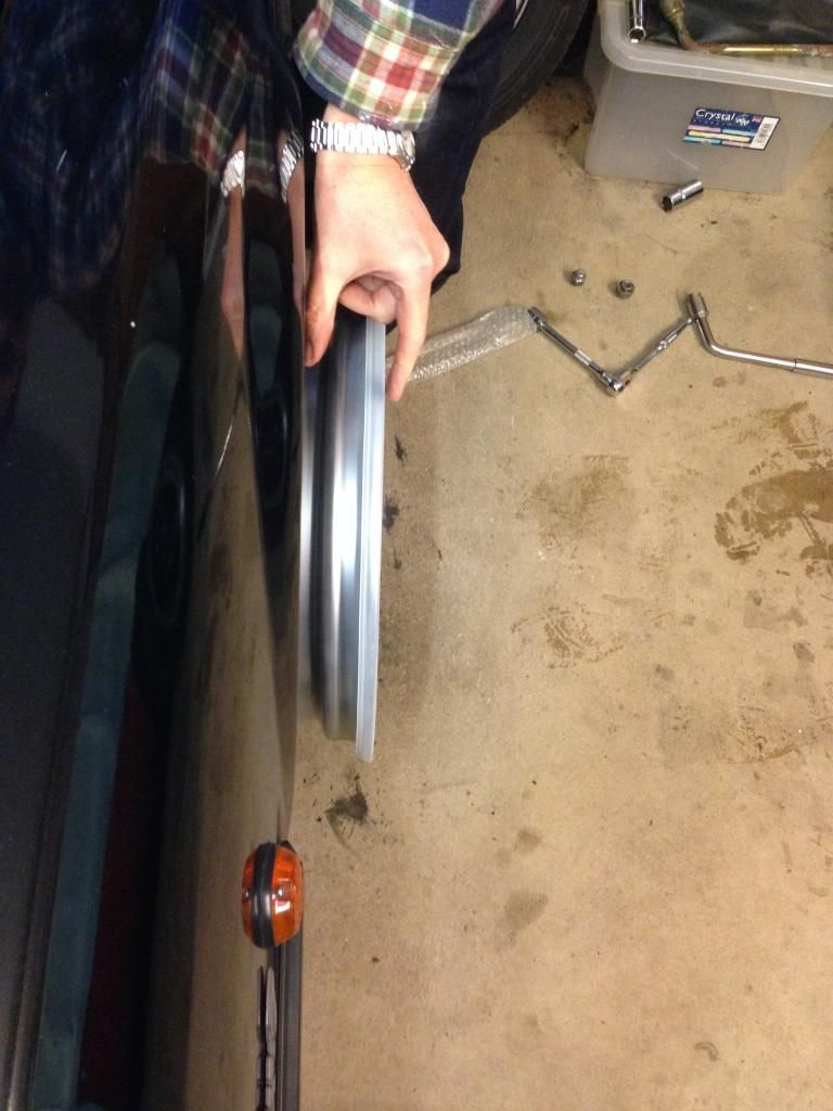

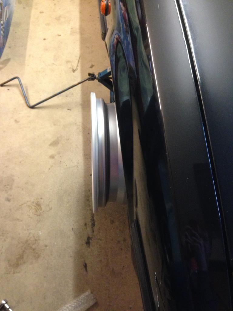

Re: 8j 16" 10 offset with 215/45 r 16 tyres?
gt_james wrote: Fri Nov 07, 2014 6:13 pm The dark picture was at twotwenty, the others were at a meet at strensham services. It would be good to get them both together at a meet Jesse :)
I don't think it's mint at all, the pictures must be making it look a bit prettier :lol:
so shiny bits came.
They poke way more than I expected :?
My dad was uttering Carlos Fandango at me haha.
I'll either have to pull the arches or get different wheels in different offsets.
Hahahahaha bro that was hilarious when I saw you had bought those aye -haha-
bloody 40mm track width change on the S3 hubs :crazy:
