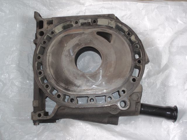

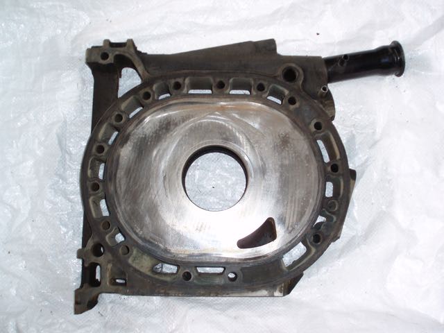

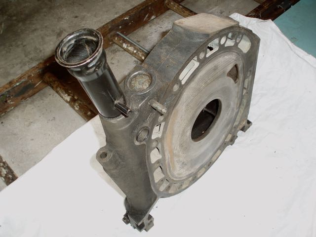

Here are the Pictures:
Font iron:
Centre iron:
Rear iron:
I have tried to find some info on the interwebs. the engine is obviously an R5 block, but that doesn't mean much to me. Are these plates nitrided? would It be possible/worthwhile porting/bridge porting these and building a 13B? or am I best trying to re unite the plates with the rest of the engine and finding some normal S2 or ideally S3 plates for this.

Yeah, that middle plate is pretty much useless, but you could use it with a 12A 6 port I guess.
And I quote:
the NO is the nasty later plate that comes in most things jap,, and maybe cali , with a tiny 24mm high port , small runners and overhead ACV/EGR passage restricting further improvements
In the UK, the S3 plates are definitely nitrided and have N stamped on each plate. The colour is more of a grey.
You can spot a set of S3 plates easy as the rear plate has a T for the water pipes because of the beehive, whereas S2 only has a straight pipe.
