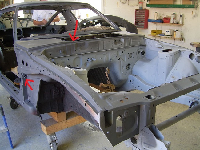

But before any of that is done, I have a small issue, water is coming into the passenger foot well, it happened over night. I went to start the car and take it for a small spin and there was a duck pond on the passenger side, there was water dripping down from under the dash.... so I'm a little worried, its been happening for about 5 days now, but its sat outside for nearly a month before this happened, It's like someone flicked a switch, I'm praying it is'nt rotted underneath the windscreen trim. I have nowhere to work on it and store it at the moment.
Re: Working 3 jobs finally paid off!
Check the waterdrain "red marked"

Brilliant Thomas thanks for that 0-0 I hope its only clogged drain holes, I'll look when it gets to a garage, and I'll have an update soon, I removed the carpets and seats and the floors are'nt to pretty if I'm honest. Not rusted through, but need attention. So when I've the cash they need to be sorted out.

I have now had a my floor fixed! :D did'nt cost an arm and a leg. I removed the panel in front of my windscreen to check for clogged drain holes, I think they have been covered up by rust preventer? I can't find them, still waiting until I have a proper garage to really beat into it, the car was'nt as rust free as the seller had promised me (no rust in the usual areas, sills are great and arches were done by the previous owner) but it's fixed now :)
I have that problem of the drain holes getting blocked, so I put a mesh (fishing landing net mesh does not rot) inside the grooves on the wiper panel, it stops larger detritus, leaves etc getting in. I stuck it on with silicone. It looks like it has always been there.
