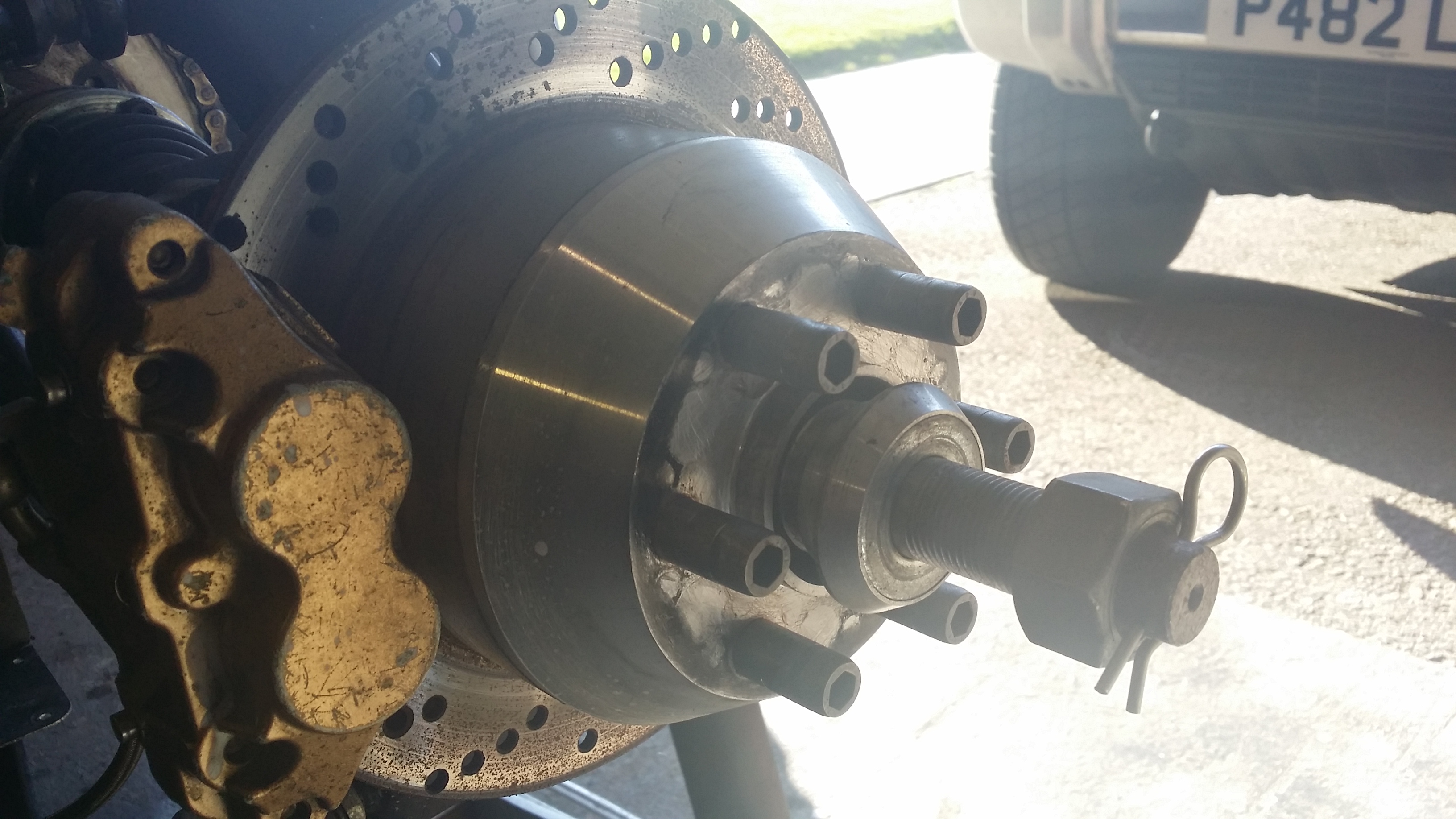

Never too much of engineering to me and need more!...
look at my own work on wishbones,brake system , hub and bearings out from wee fiat car, Brake disc from Vw golf/ford fiesta and drill many holes. it did stop very well.
