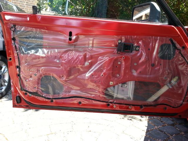

Well after 30 years the drivers door lock has given up. So today I decided to change it over with the passenger side lock that still works. I took off the drivers door card, I've had this off once before to oil the lock, removed the lock this is the side that has a light in it so when you touch the handle it comes on so you can see the key hole in the dark. This stopped working some years ago.
Drivers door below.

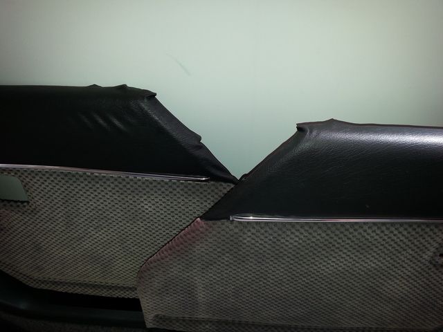

I have decided to leave the door cards off for a while as I want to add some more waxoil inside the doors and do a bit of work on the tops of the door card vinyl.

that looks good Dibs... it's one of those jobs that I keep meaning to do to mine but never get around to...... warm weather helps as well... it'd be difficult to get it that smooth in the cold weather.
A7RXY wrote:Well after 30 years the drivers door lock has given up. So today I decided to change it over with the passenger side lock that still works. I took off the drivers door card, I've had this off once before to oil the lock, removed the lock this is the side that has a light in it so when you touch the handle it comes on so you can see the key hole in the dark. This stopped working some years ago.
Drivers door below.

Who could believe these doors have come from a 30 year old youngster - fantastic condition which gives a very good idea on the condition of RXY full stop.
Something to be proud of owning a car still with original paintwork too.
