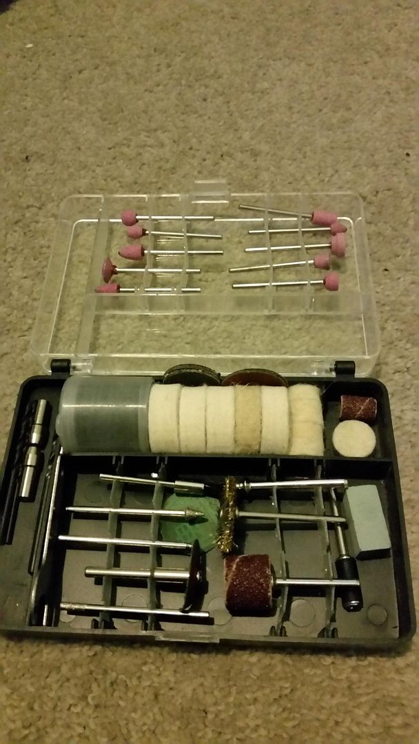

This is what came with my Draper version of Dremel
Thanks to the points system of the job I just left, I got it for free

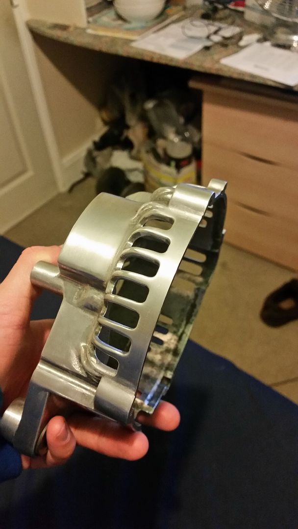

Made a bit of progress lately. Since getting rid of all the casting marks I've been flying through. This pic is at 400 grit. It isn't perfect but I'm pretty happy with it so far. Suppose I should start looking for some decent polishing compound/dremel attachments

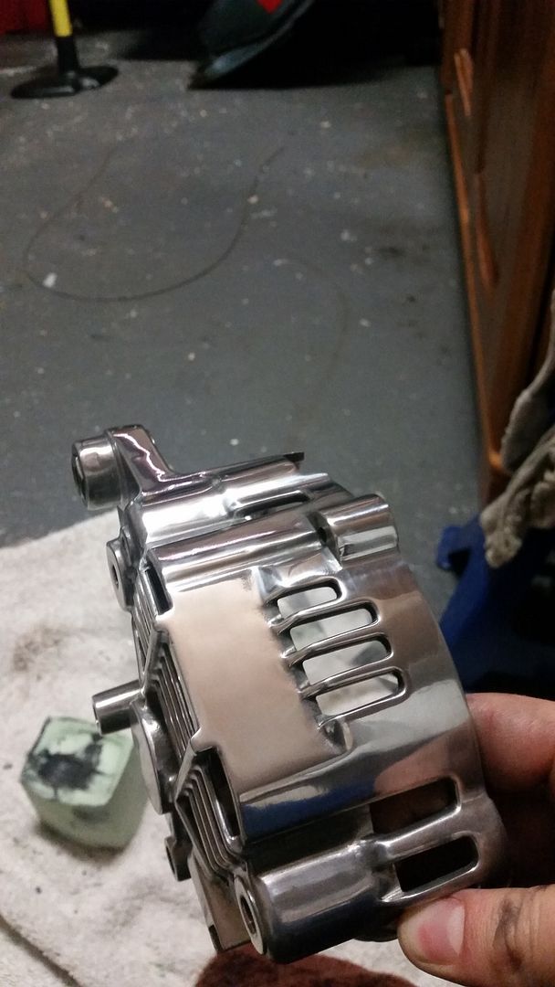

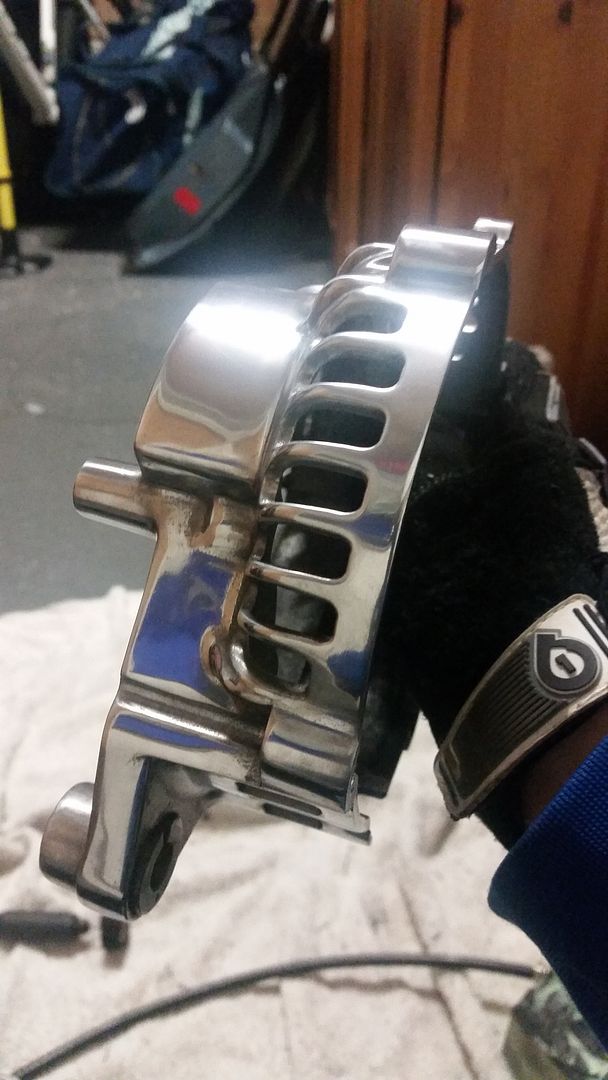

Finally got all the sanding done. There are a few nooks and crannies that were a bit hard getting to. Even with the dremel attachments Nik suggested to me a few posts up. But they shouldn't be too noticeable. Ordered some polishing compound and mops to my new house last week and had to test it out
Here is my first stage of the mopping process. Still sussing out my technique but I'm stoked with it so far aye! This is all being done with a dremel from now
