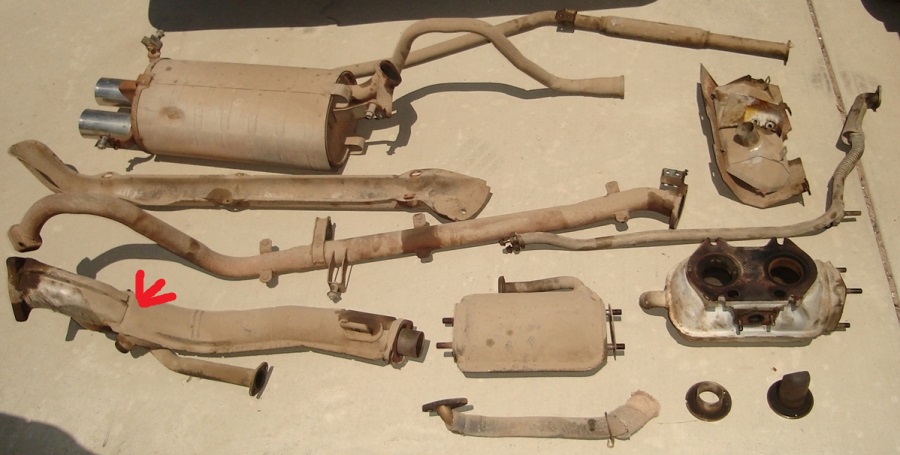

Re: Rx7 from Hungary
Please read post 238. If yours is a german rx7 you definitly have a thermo reactor no catalyt.
Your OEM exhaust parts: Red marked position will make problems especially 1984 because there is a small differenz to 1981 part.
Exactly as Thomas says, I do not believe you have a Cat. You should have the exhaust Thomas shows which has the Thermal Reactor. The red arrow is where I said the front silencer gives trouble. It breaks inside the pipes.

I have no good pictures, but I'll try to shoot some. I think I have a problem at the same place you've marked with the red arrow, but I'll try to investigate.
However now I know and I'm pretty sure of it that my car has a thermal reactor, not a cat. I was confused before, because the '84 parts catalogue I found told that my car has a cat. Also I knew that I have a small third pipe near the rear muffler I was not sure where it was coming from. Now it's clear that it is part of the thermal reactor system or so. That's why I'm very interested about the differences between US and Europe specification Rx7s on I've found virtually no information so far.
