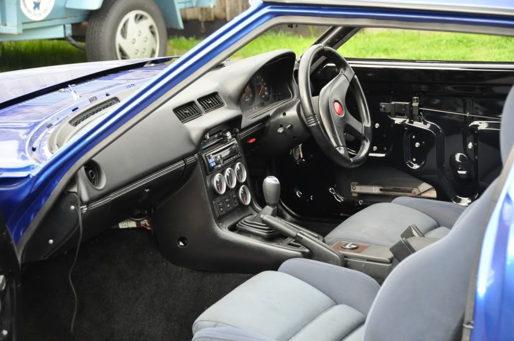

I have the same FC seats, but notice they look different in later photos - is that just retrimmed?

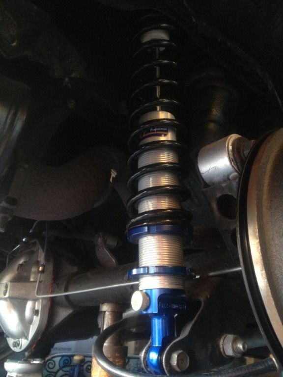

Why did you go for a BW diff?- apart from the fact they are plentiful, cheap and strong. Did the old diff break?
What power is it putting out? What is the traction like?

I had a single dark grey fc seat and couldn't find a suitable pair so swapped someone for the pair of blue ones for one
Grey seat. I like the Grey one better but I'm going to get the interior upholstery done anyway so it's all good.
About the diff it was a s1 stocky single spinner and it held up pretty good with the 13b turbo but started dual spinning and making some weird noises. I had a Holden VL Turbo diff sitting around and they are known to be super strong and able to handle some big Hp. So I got it shortened and what ever else with 4:11 mini spool and the diff has been great. Converted to LSD recently and now it's even nicer to drive, not so harsh when just cruising around.
Don't have a Hp number as yet, been happy just to keep it on low boost and keep it more reliable. By the seat of the pants and how it goes against mates cars, I'd say close to 280-300hp maybe. It still manages to spin the big tyres if you punch it hard but hooks up and just goes. I got some 285-40-15's going on soon to replace the 295's.

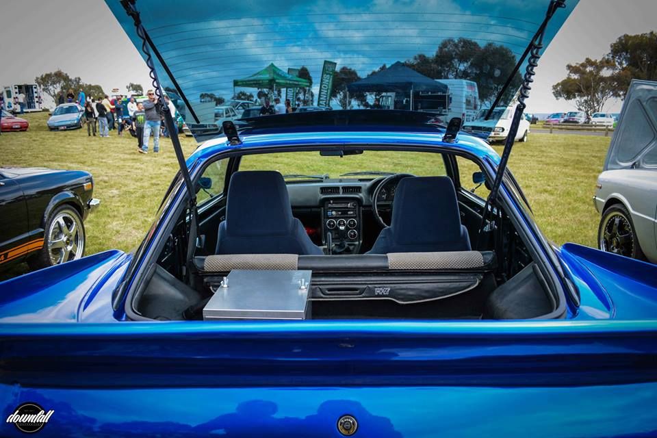

Got some photos coming of battery in boot and alloy boot install. Bonnet will be converted soon to have a S5 bonnet scoop to assist the cooler .

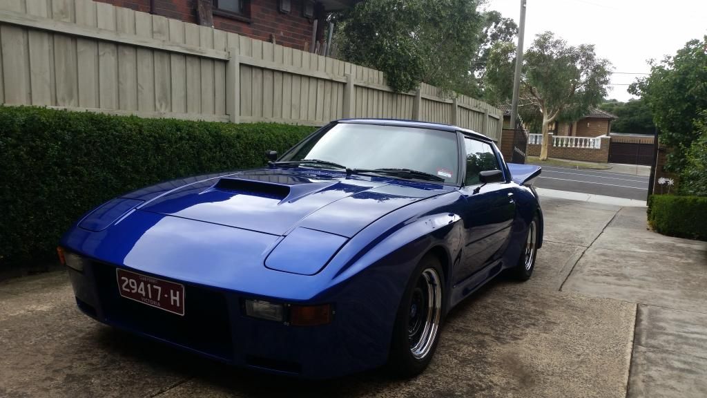

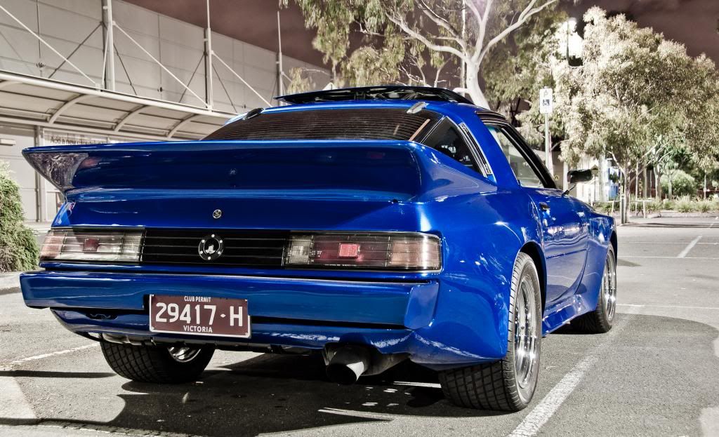

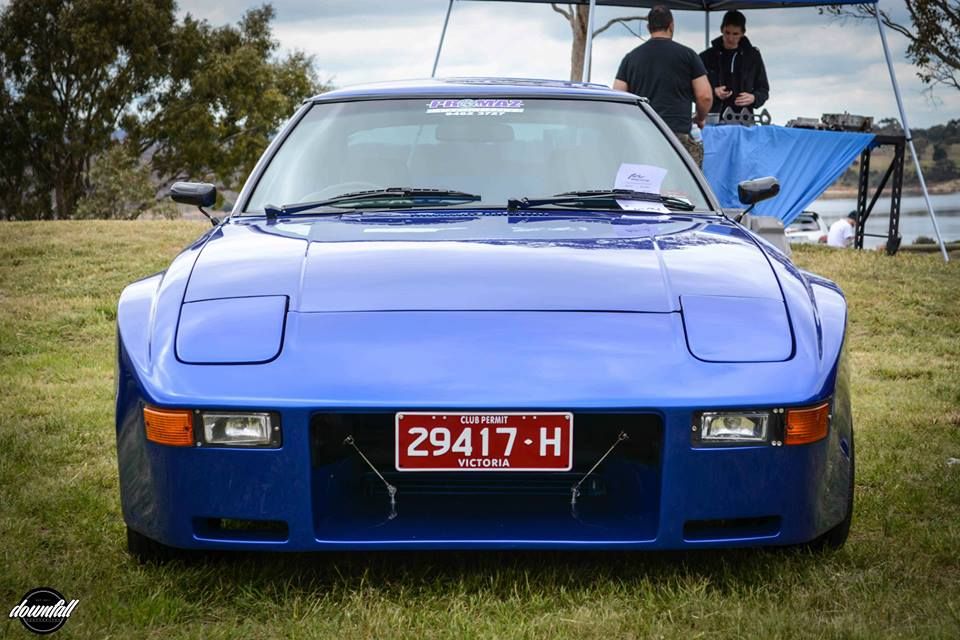

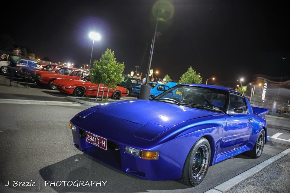

just been enjoying the car and taking it to cruises and shows. Getting a S5 bonnet scoop moulded onto a bonnet so will have a new look soon.

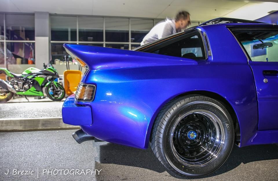

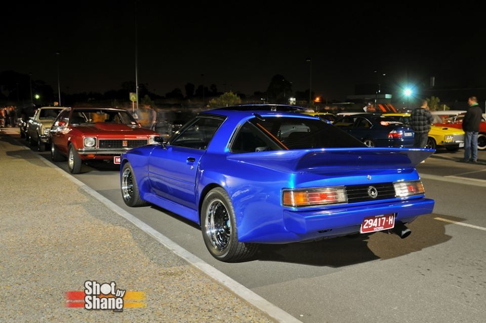

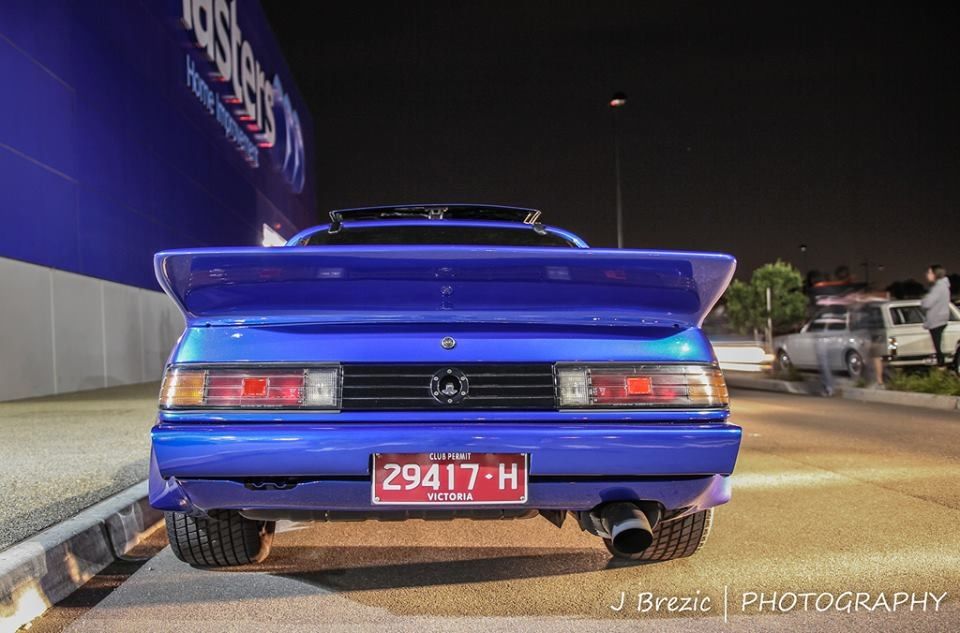

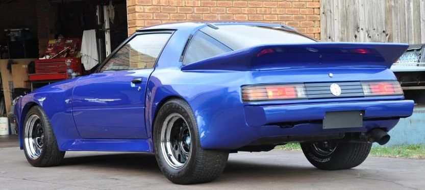

some pics for you guys -

Car looks awesome. I really love that color :)
Re: Daytona RX7
Stunning car !
s(c)

and how cool are those wheels despite being steelies - awesome h[b[
Re: Daytona RX7
gorgeous car h[b[
Nice photos too.... and the picture your mate did!
How long did the car take from start to finish..... there's obviously some serious work gone into it..... awesome.
