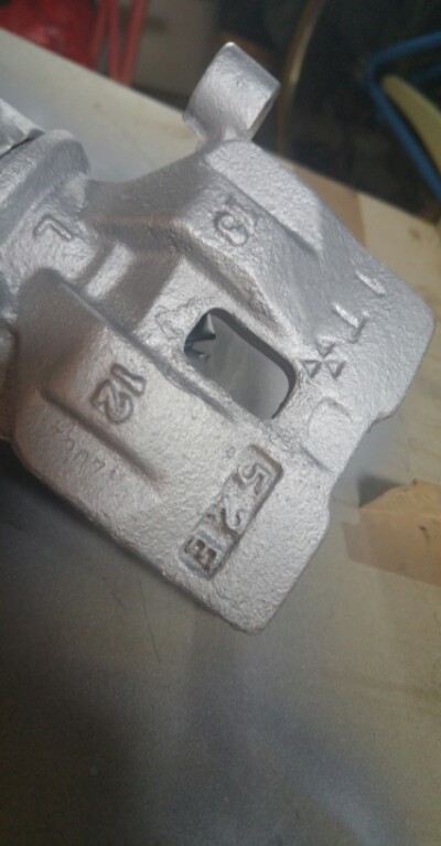

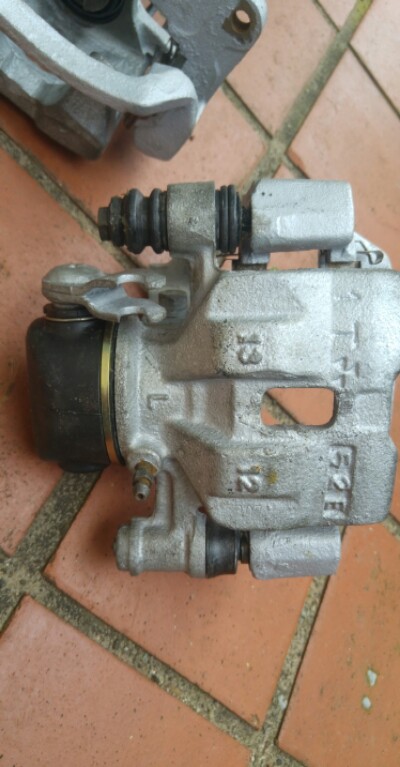

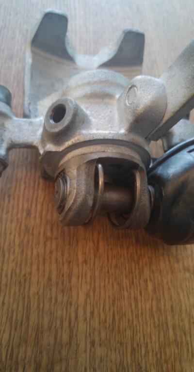

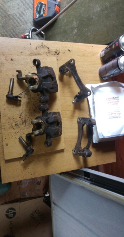

Hi,
Just thought i would post up the results of my rear caliper refurb, the piston on the rear left was sticking and on inspection both boots were torn.... This cost me £22.
I'll let the photos do the talking and link to the guide i used.
Rich
Linky...

Its simple enough, the hardest part is removing the rust.... But a food dose of citric acid does that job easily :)
