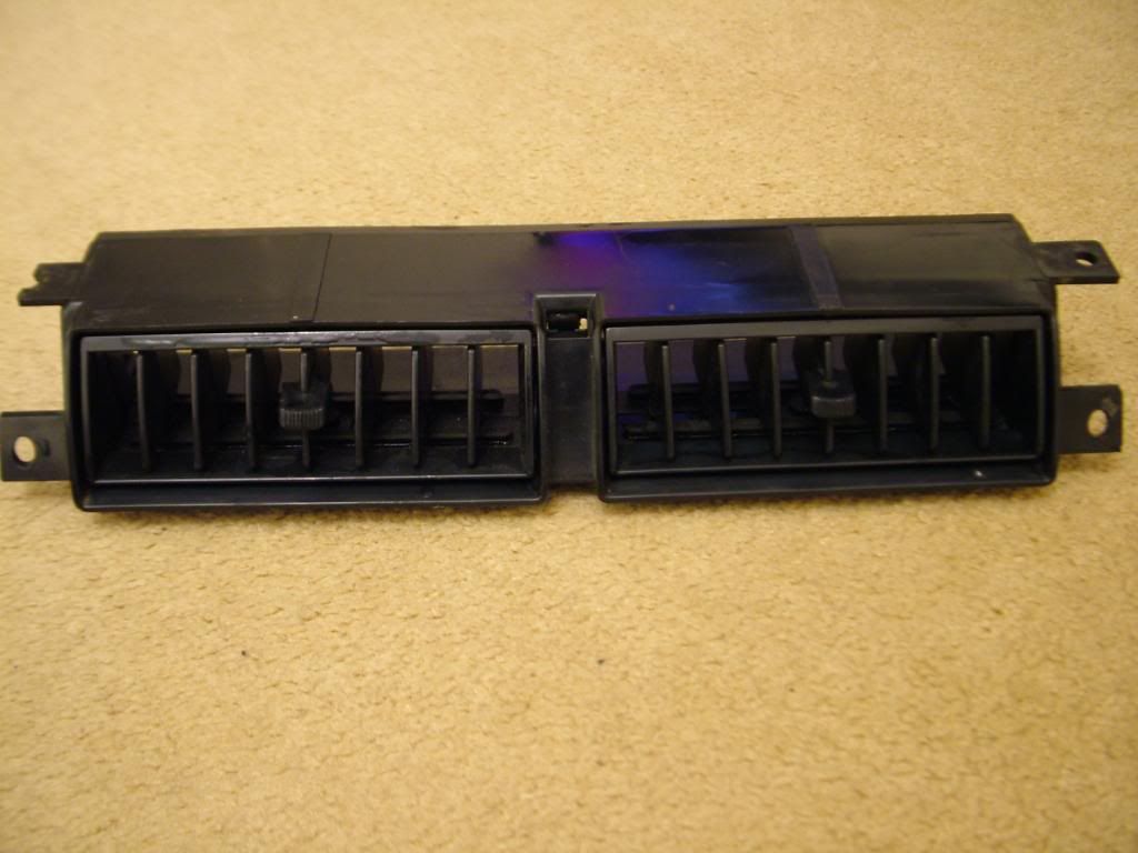

First thing to do is get a good vent assembly...

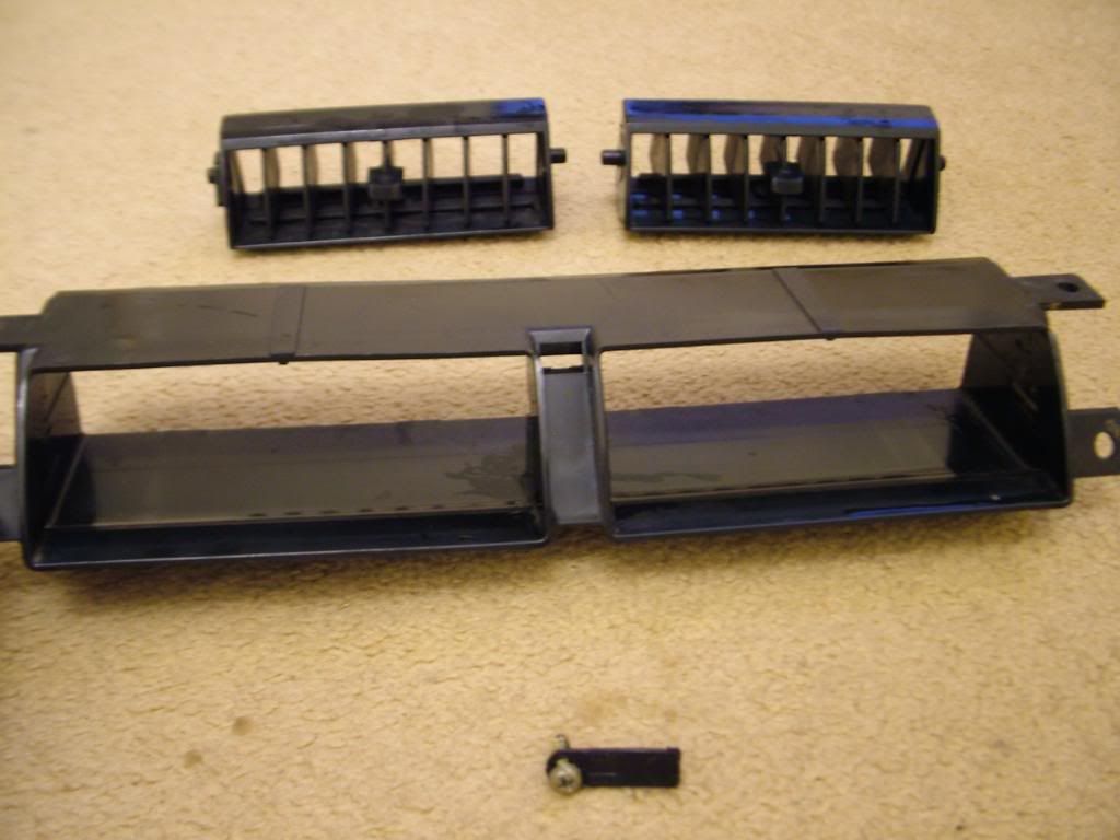

On the rear of the complete vent assembly is a screw and plastic strip which holds the rockers into the housing
Remove this screw and the rockers will come out of the housing

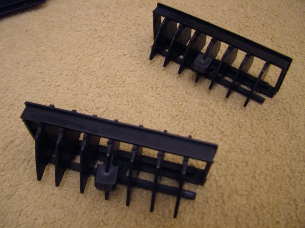

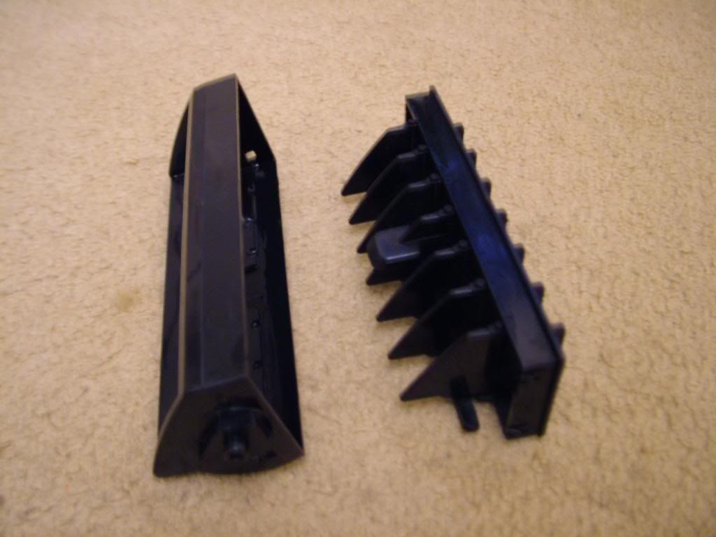

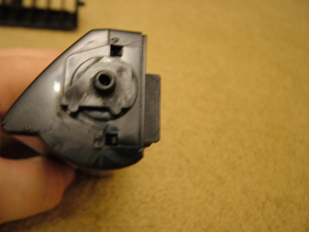

The fins are mounted to a thin plastic frame which clips into the back of the vent rocker. This frame locates with small plastic tabs on each side, seen here ( the 2 small square holes...
I pressed the tabs in to release the frame and removed the frame and fins from the rocker...
These small assembles were missing completely from my vent rockers. If you are just replacing damaged fins you will need to prise your old frames out of the rockers from the front using a small flatblade screwdriver.
I then folded the fins as flat as they would go towards their frame

When I got my new vent assembly, it was kindly donated by Keith from his old RX7 but was still in the car and we had to remove it. It took about 2 hours and most of the dash and centre console had to be removed. Having looked at the vent assembly since, I’ve found that the quick and easy way to get the rockers out without stripping the dash is to push a hacksaw blade into the assembly between the rocker and main outer assembly body and cut through the pivots on each side of the rocker. The rocker can then be pulled out of the dash and the fins removed.
