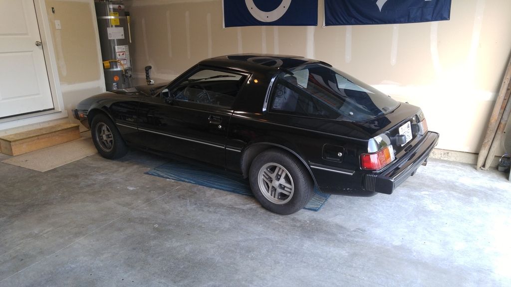

Here she is, 100% stock. I just adjusted the e-brake cable but still have the air box taken out, so I haven't been able to wax it down and take it out for some real pics. I appreciate the tips guys, I'll have to check these things out! The girl who sold it to me said she thought it might need a new carburetor. I'm gonna try to rebuild it first given the cheap price of a rebuild kit, but worst case scenario, any advice on carb replacements that wouldn't break the bank? From what I've read in the past month or so, it doesn't seem like people have too many carburetor issues with these things.
Re: New to the rotary world with my latest purchase!
wow what a beauty!!!
really nice s1 mate.

Appreciate it! I am surprised this thing isn't rust covered given it's life spent on the coast. The paint looks decent in the picture, but it definitely needs some work.
