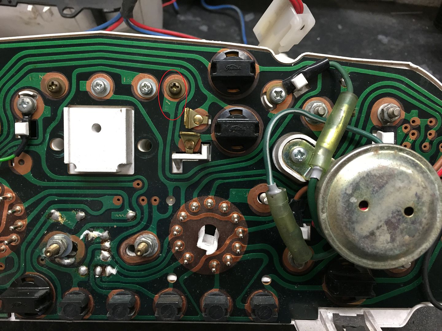

as part of my quest to solve various electrical gremlins on my S3, I today changed the clocks for another set, a consequence of which is that with this set of clocks, the over rev buzzer doesn't work.
I've been having a look at the rear of the clocks trying to suss out what the issue could be.
This pic shows the rear of the clocks and the over-rev buzzer...
and a close up...
The supply to the buzzer comes from the rear of the rev counter, circled here in red. If you follow the track on the pcb you can see it goes to the buzzer.

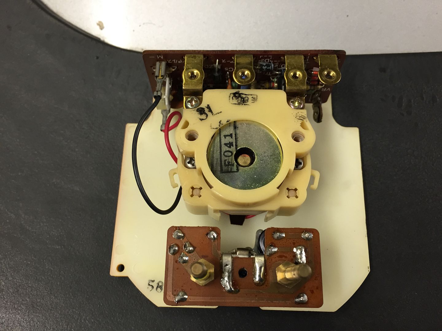

the pick up point for the buzzer on the rev clock can be seen here circled in red...
this circuit board only controls the rev clock, the volt meter is a stand alone gauge that has its own circuit... the pot visible in the top left hand corner is used to adjust when the buzzer kicks in...
this rev clock is a JDM 12at version with a turbo boost gauge built in but the rev clock is the same across all S3's
Still trying to work out what could be causing the buzzer to stop working.
This diagram shows how to adjust when the buzzer comes on if you want to rev the nuts off it without being reminded to change up
