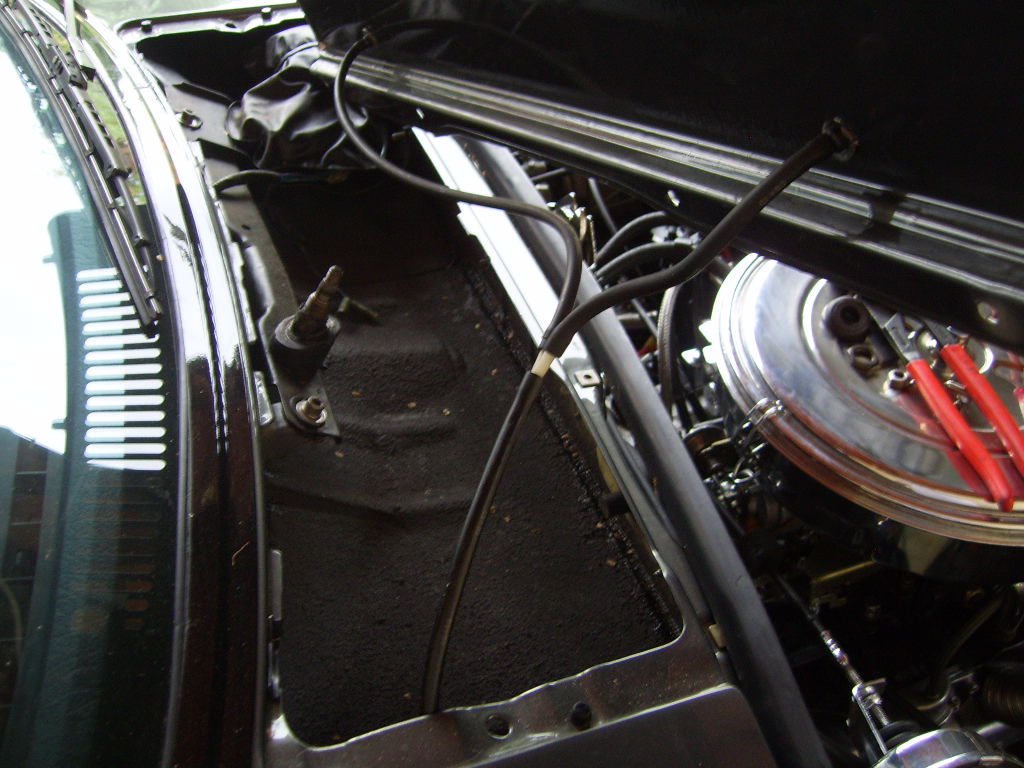

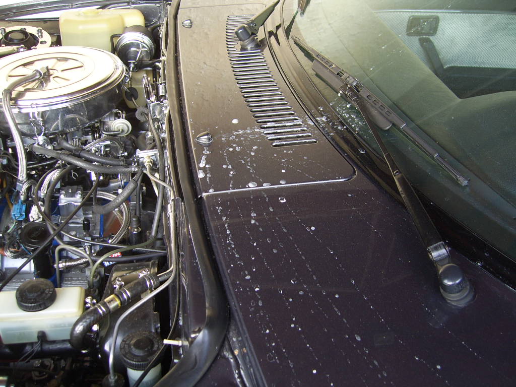

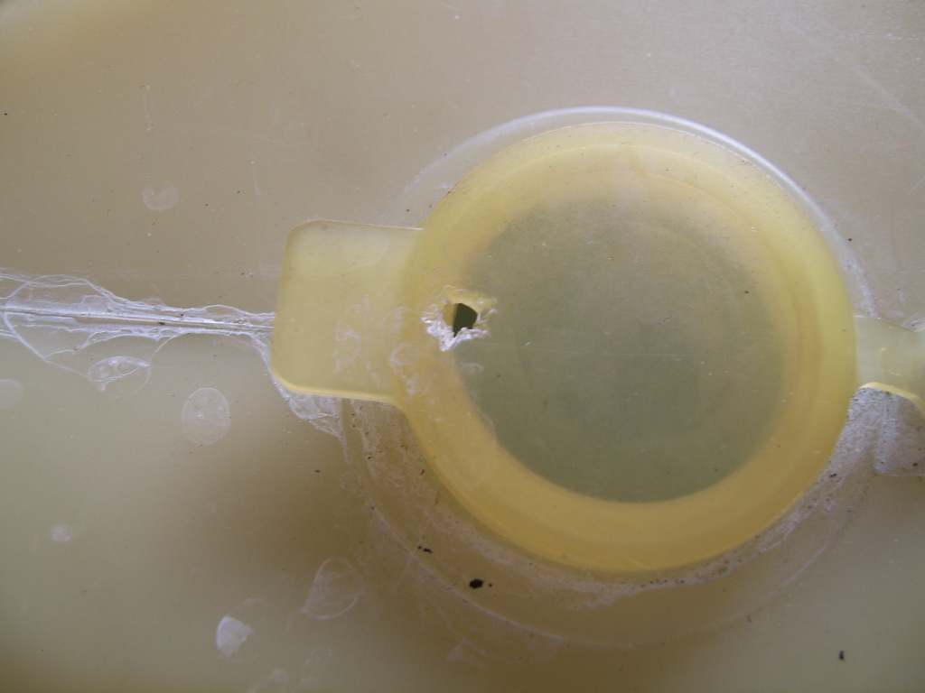

water is coming out of the windscreen washer spray valve on the driverside if I drive the car. I open the vent hole in the cap of the water reservoir but it doesn´t help.

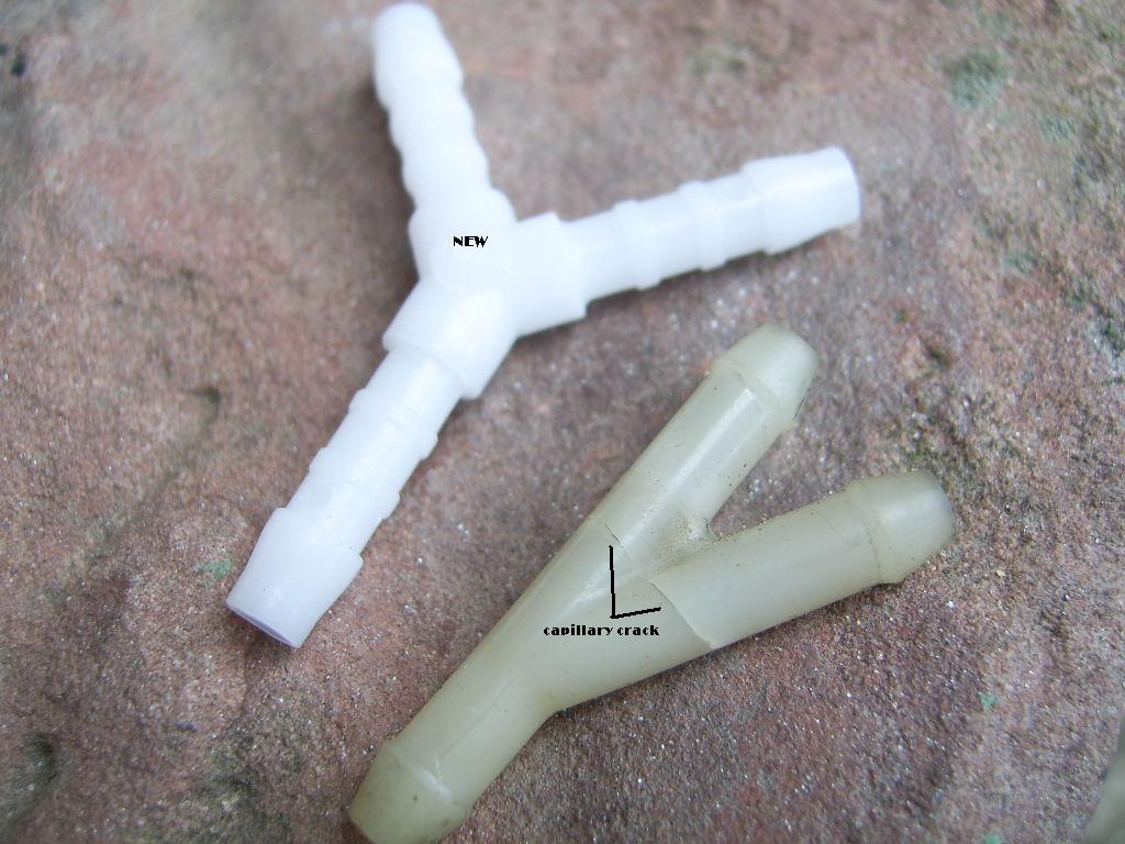

The Y connector perishes (Disintegrates), caused by the sunlight through the scuttle panel (vent panel). Why the jet leaks water out I don't know.
Maybe the water left in the pipe is sucked out by the lower air pressure at the nozzle when driving and the disintegrated Y piece allows air to come in to replace the water?

clairvoyant Dave: The answer is completely correct:

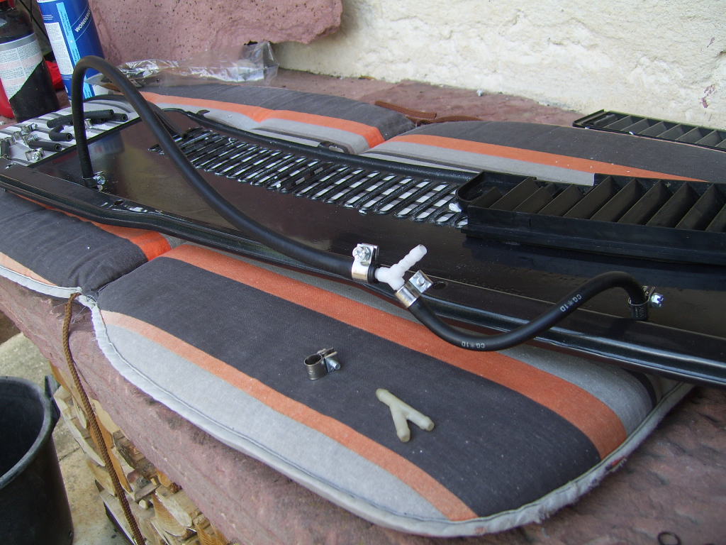

I checked the y connecter and could see the little capillary crack.
The hose clip are 9mm and 10mm there are diffrent hose.I take two jet from Serie 2 so I have more water on the windshield.
s(c) Great Help
Thank you Thomas
Re: Don´t know why
so there was a one way valve in the Y connector? I never knew that either..... good call Dave. th:
Re: codge know why
Sorry ian you missunderstood. The fault was a capillary crack in the y pipe. The UV in the sunlight take off the the softener in the plastic y-pipe.
There was no one way valve inside the tubing which is supposed to prevent water from draining back into the reservoir.

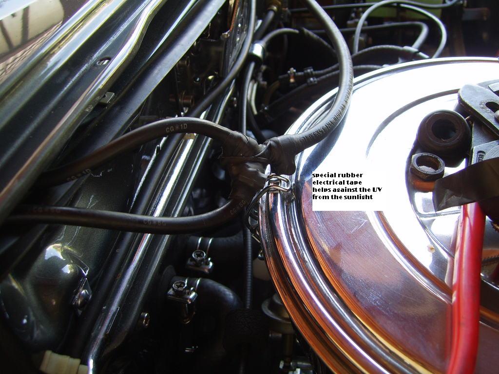

I like the anti UV tape Thomas. But you have got about 25 years of life in the new connector without it. Still good call.

Does the pressure in the scuttle space (louvred panel space) build up as the car rushes through the air. Building up from the base of the windscreen perhaps?
That air pressure can then get into the Y connector where its split and create a pressure differential relative to the air pressure just at the exit of the jet?
And maybe the Black Forest gets more sunshine than rainy Britain? So you might have a bit less time than 25 years?
